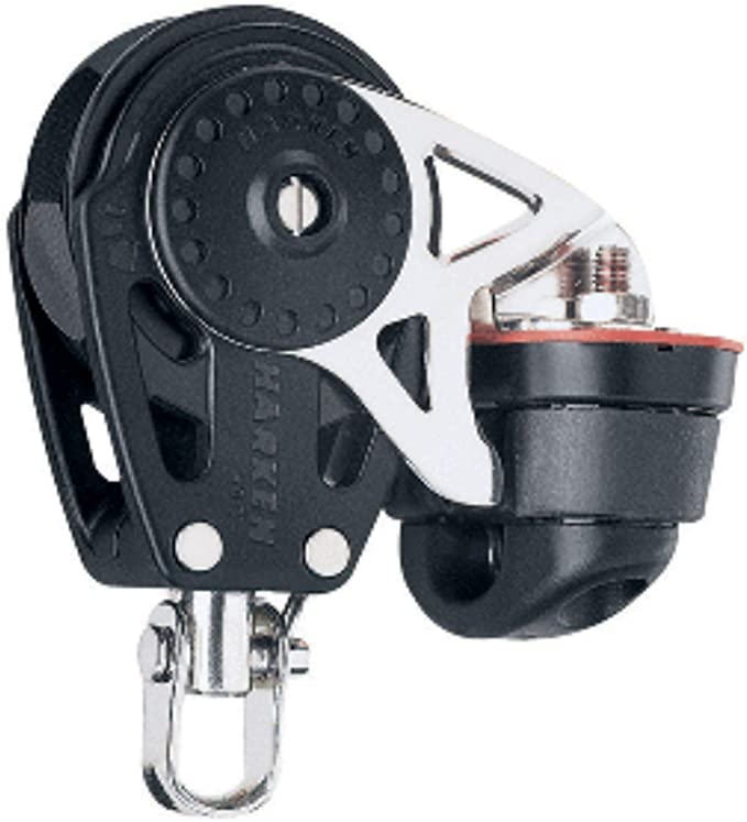

what I used was a bit more like a fiddle block than a true cam cleat mounted to the boat. but I’m having trouble finding one in the catalog. The boat splashes next week and when I’m there I will take an up close picture for you
Gotta love Amazon, I found it in my purchase history. It’s a Harken Carbo Ratchet Block. I added a snap shackle that I use to clip it to the arch. That way as I said it can be unclipped and moved so it’s not a trip hazard.
https://www.amazon.com/gp/product/B00CSUXR78/ref=ppx_od_dt_b_asin_title_s00?ie=UTF8&psc=1
Agree with others that a true cam cleat isn’t the best as you’ll be pulling at a bad angle, leaning over the coaming to use it and I think if it releases unintentionally you could have problems. With this mechanism you keep the furling line straight and angle of pull is better. You stay in the cockpit. And no drilling or mounting required.
