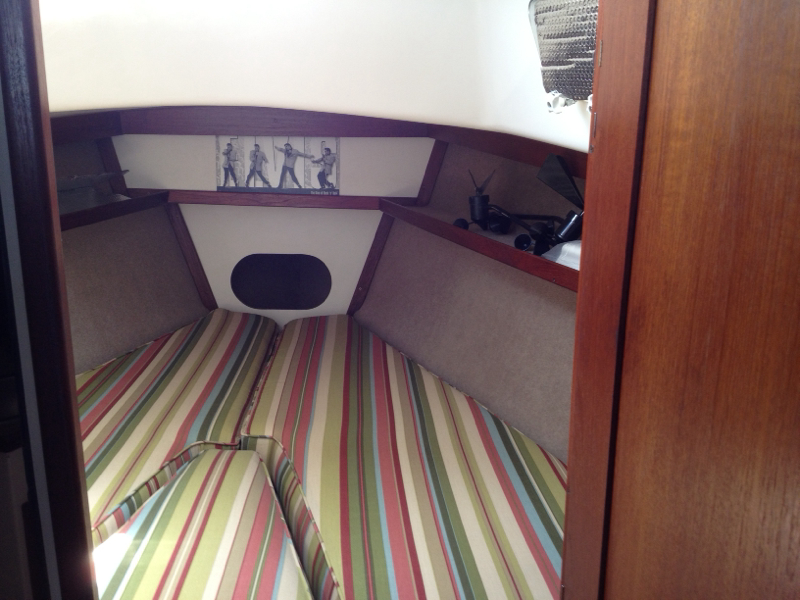

That's a hilarious picture (when looked at closely). Who is "giving the finger"?
Mar 19, 2013
75
Beneteau First 38 Chicago
Trapped?
If no one else has them quicker I will measure this weekend.
I used indoor/outdoor carpet and it has been good for 12 years. No issues with condensation behind or anything like that, easy install, nice to lean against, easy on the wallet.
I think someone's trapped under the V-berth...
Johnb
1,494
Hunter 37-cutter Richmond CA
Hawk eyes, I was fooling around demonstrating to the admiral how big that space is by climbing into it.

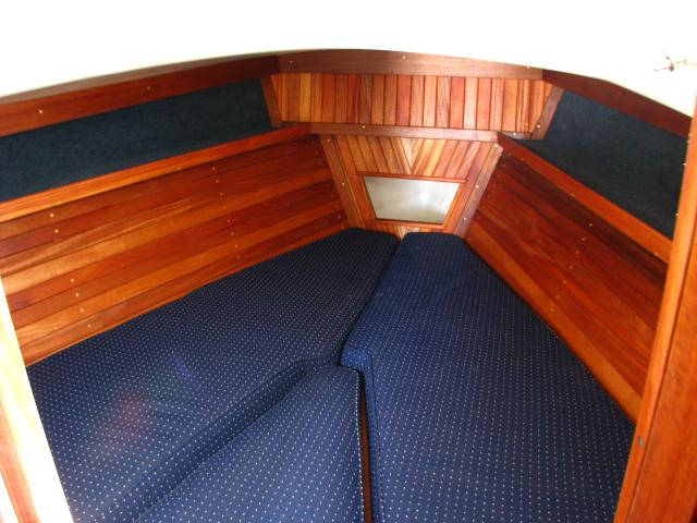

Not my work, but gorgeous in real, finished wood.
Check archives here on a Hunter 30 rehab posted in the past 10 weeks.
Mar 19, 2013
75
ggrizzard, I really like the wood. Are there stringers behind that its screwed into or is glued directly?

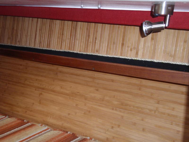

I wouldn't trust someone else's dimensions....it will be a disaster. You need to measure YOUR boat. If you replace with carpet just cut a piece a little oversized for that area and trim with a knife to fit exact. I used bamboo panels. It's 1/2" wide bamboo strips glued to a canvas backing. It worked great on the walls since it bends to the contours. I did my whole v-berth in an afternoon with a measuring tape, utility knife, oscillating saw and about 4 tubes of Loctite Pro Line fast grab 8x. It's not going anywhere. The picture doesn't do it justice. It looks really great (my cushions suck though). The bamboo comes either 4 x 8 or 8 x 4. I used 8 x 4 in mine to go the full length. It comes in 4 different finishes. Mine is the carbonized bamboo. Not for everyone but just giving you an option. Very pleased with mine.

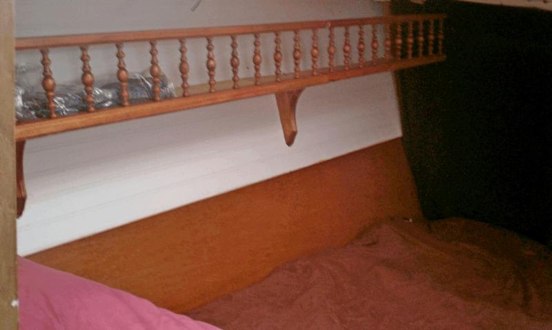

5,802
Ed - I added 10" wide shelves to both sides, primarily to stow my clothes. They work great!
I like those a lot Fred. Having trouble orienting though. What is that on the far end?
FredV
Oct 16, 2011
148
Hunter 37-cutter Philadelphia, PA
The right side of the photo is the forward part of the v-berth. Right now it's covered with a brown towel and waiting for the day when I finally figure out how best to finish it.
