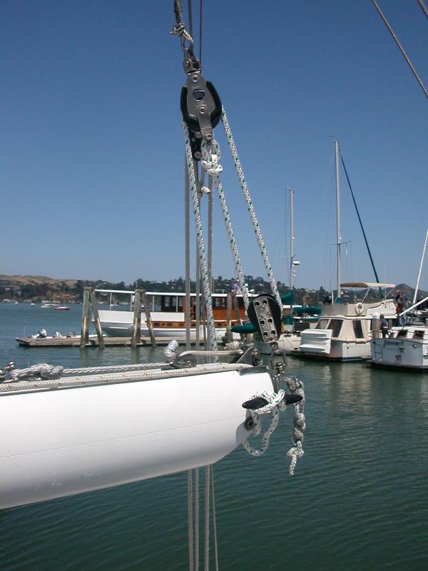

My topping lift arrangement (1980 H36, but I believe the same Kenyon mast/boom arrangement as the 37's) is a bit convoluted. But works for me. Sorry I don't have a picture already on my computer to attach.
Essentially, I've got an SS wire affixed to the mast top. About two-three feet above the boom end, the wire converts to a rope block and tackle (3:1). Pulling down on the line, the boom goes up. On one side of the boom end, I've installed a cam cleat. The line can be seized off on this -- but only very temporarily. On the other side is a normal cleat for the more secure tie-off. The bottom end of the block and tackle is fitted with a snatch shackle. Originally, the PO had a loose SS ring at the end the boom for the topping lift attach point. I have modified to something more solid. After I raise the sail, I untie the line from the cleat, then release it from the cam cleat. The boom drops a few inches to the natural sail support level. Then I pull the release line on the snap shackle and remove the topping lift assembly from the boom completely. On my starboard split back stay, I've installed a cleat. The topping lift is attached to that and tightened enough so it doesn't flop around during the sail.
When sailing, I no longer have to bother with adjusting the thing all the time depending on sheeting angle and tension.
At the end of my sail and with the boat pointed into the wind for sail dowsing, the boom is centered and sheeted tight. The snap shackle is removed from the back stay cleat and re-attached to its boom fitting. The rope line is pulled tight and led through the cam cleat. Then brought over to the the normal cleat for safe secure. The sail can then be lowered without the boom falling down.
Sounds complicated, but all this takes but a few moments and from the safety of being in the cockpit. It is just part of the routine -- several hundred times now. And as already mentioned -- no fussing with the topping lift during the sail. I recognize that in very light winds, one might raise the boom for better sail shape. But unless racing, or concerned about just a few minutes better performance during a normal day sail, my lack of this feature isn't much of a downside.

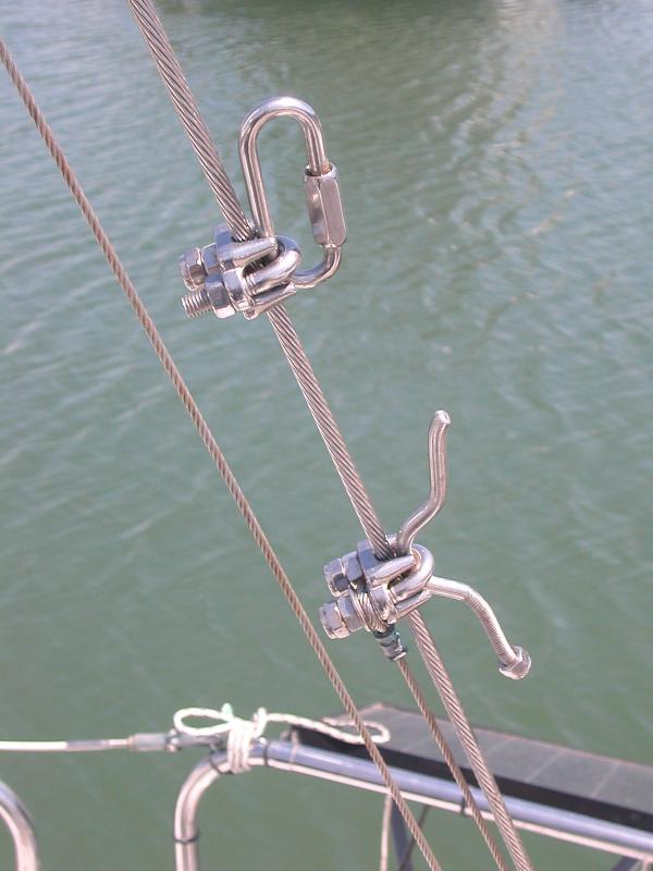

Hello Jim:
Here are pictures of my topping lift solution. Port and starboard shots. Also the a picture of clip-on ring and cleat mounted on the port split backstay onto which the topping lift is attached when I am actually sailing. Refer to my previous post for the written description.
Re your concern about dousing the sail before re-attaching the topping lift to the boom end. I have done this only once in a couple of hundred outings. And the outcome was not dire. This is because my halyard rope clutch is the sort that can't be released under much tension. So what I do is wrap the mainsheet halyard around the cabin top winch and relieve the tension. Then back off the halyard maybe six inches. Then re-engage the clutch before I go up on the cabin top for the final preparations before releasing the clutch fully and letting the sail collapse down along the lazy jacks. The six inch pre-release is enough that I can easily see/sense if the boom has dropped a bit if I had forgotten to reattach the topping lift to the boom.

Thanks for the great pictures. That is more or less what I am contemplating. I might get a bottom block with a cam cleat incorporated, rather than cleating on the boom. I like the idea of stowing it when not in use on a ring on the backstay. I will have to see if that would work with my bimini folded and stowed against the backstay. I release my main halyard from the winch on the mast, so I might have a senior moment and not notice the lack of topping lift until the boom rested on the dodger...:doh:!

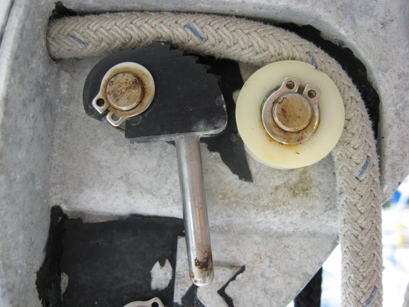

As to the internal reefing lines through the boom, my H36 has them. But what I did change-out were the boom mounted Kenyon original cam cleats at the gooseneck which secured the reef lines. I reef a lot for the central SF Bay slot winds. The new setup works much better than the original Kenyon system. I posted more description 1.5 years ago, but attached are before/after pictures. Now, the reef lines from the gooseneck lead down to blocks at the mast base, then back up to tie-off cleats on the mast. I can pull up firmly on the lines to get the reef point clews pretty tight against the boom. To shake out a reef, the lines are laid on the deck. Then they feed back nicely into the boom without much fuss as the sail is raised. Just to mention as an alternative to the cam cleat arrangement.

I have a cable hanging from the top, with a piece of line tied to it using a thimble and a d-ring type clip that attaches to the end of the boom. When it comes time to sail, I hoist sail, then unclip and clip onto a cleat bolted to the shroud. Its the kind of small cleat that is designed to be bolted to a cable and has the loop on one end, and it's position so I can clip the topping lift onto it and it doesn't bounce around under sail. Otherwise, leaving the topping lift on, wraps itself around the backstay in light conditions and doesn't seem to safe. Under heavier sailing conditions, it becomes tight when strapping in the mainsail. I also support and want, a boom vang, that's a great solution.
