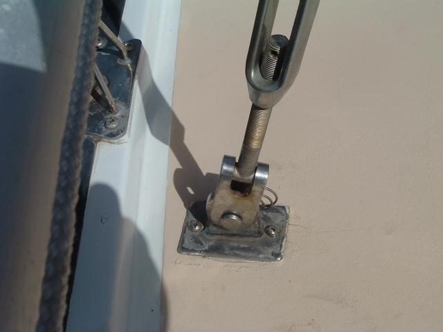

Is it just the H37C that has what looks like a plastic spacer under the stanchion(picture). Anyone find a good substitute? It appears to be 1/4" in thickness. Actually in pretty good shape after thirty-two years.

I would assume that the material was placed under the base so the stanchion set at the same angle. The bases on your stanchions are a little different because of the lip on deck.
I do not know what plastics shops are in your area, but Tap Plastics has some similar material that can be used.

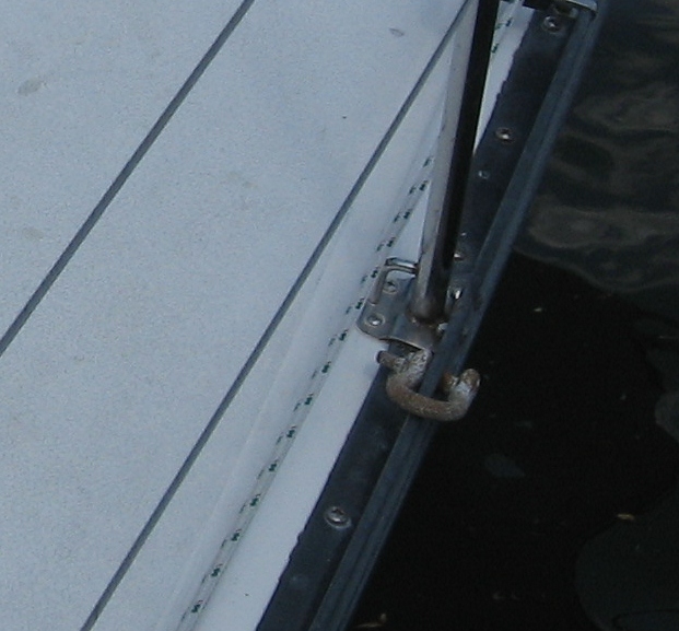

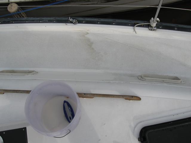

I think all the H37Cs were the same so far as the hull to deck joint. What might have happened is a change to the base of the stanchion. I have seen stanchions where the base was contoured to fit over the toerail and onto the deck lip. In the attached picture you can see how my '79 is mounted. And I had none of that reddish stain the years the boat was in Lake Erie(on the turnbuckle).

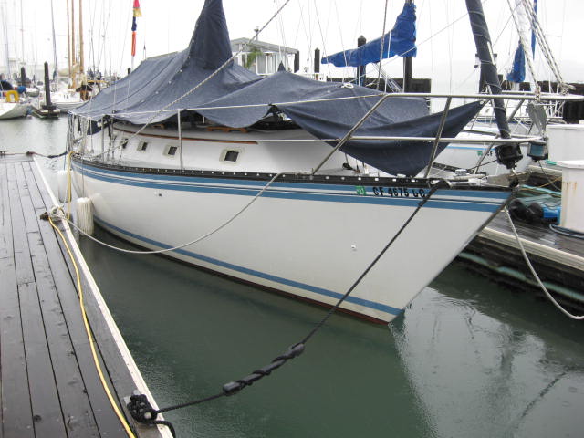

So -- and also partly for the purpose of benchmarking myself on the state of my memory function -- I did a walk-about today to the marina up the channel where I recalled the location of a Hunter Cherubini 37. Yes, it was still in the place I thought!

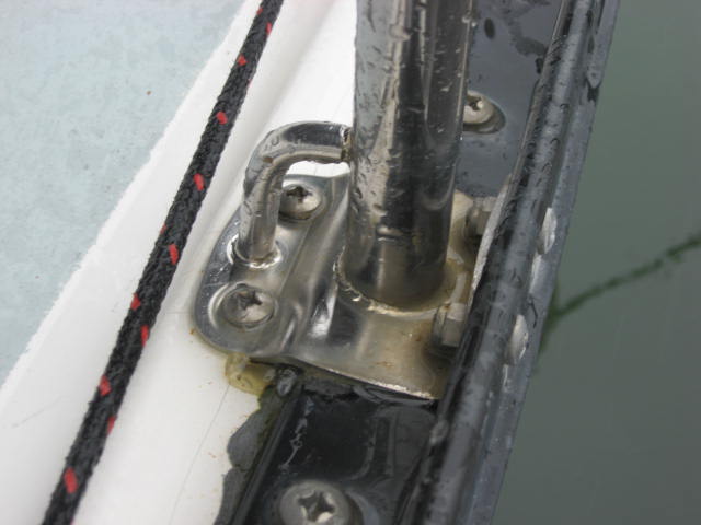

Per my post last week made from snowed-in Lake Tahoe, I recollected that this particular 37 had stanchions the same type as my 1980 H36. A couple of pictures of/from the Cherubini H37 are attached. From the HIN on the transom, it was manufactured in 1983.
Confirmed: the stanchion type is the same as my boat. I have passed the memory test this time anyway.
Rather than needing the spacers, the stanchion base on this 37 has the downward bend to make the transition from the toe-rail elevation to the deck FRP. This boat looked to have the same galvanic corrosion issues as my boat between the stanchion SS and the toe-rail SS.

I had seen that style Rardi, just never on an H37. I like it because it only requires two holes, the other two bolts being to the toerail. And no need for a spacer.

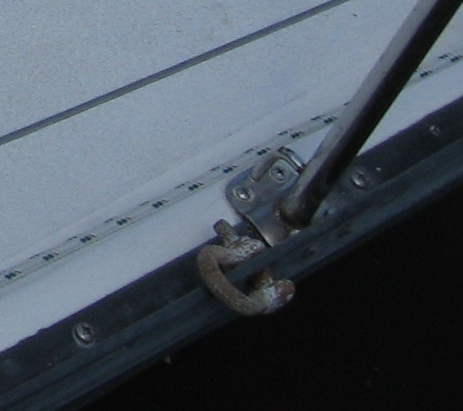

Ed - Here are a couple of photos of my stanchions. Must have been what was available at production time.

Mark - I do believe these are same as on my 1981 37C. Perhaps this is something that could go into the evolutions thread.
