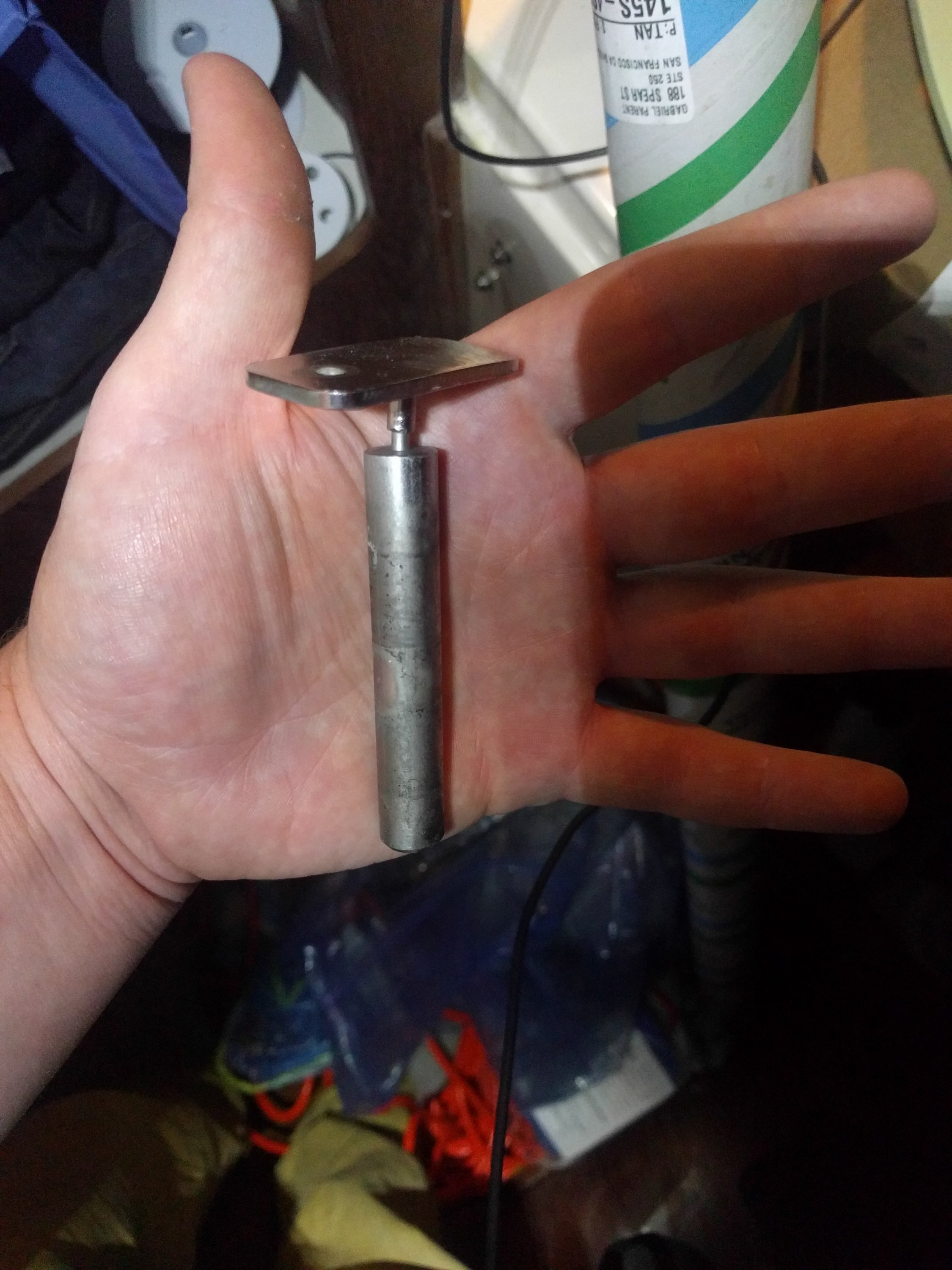

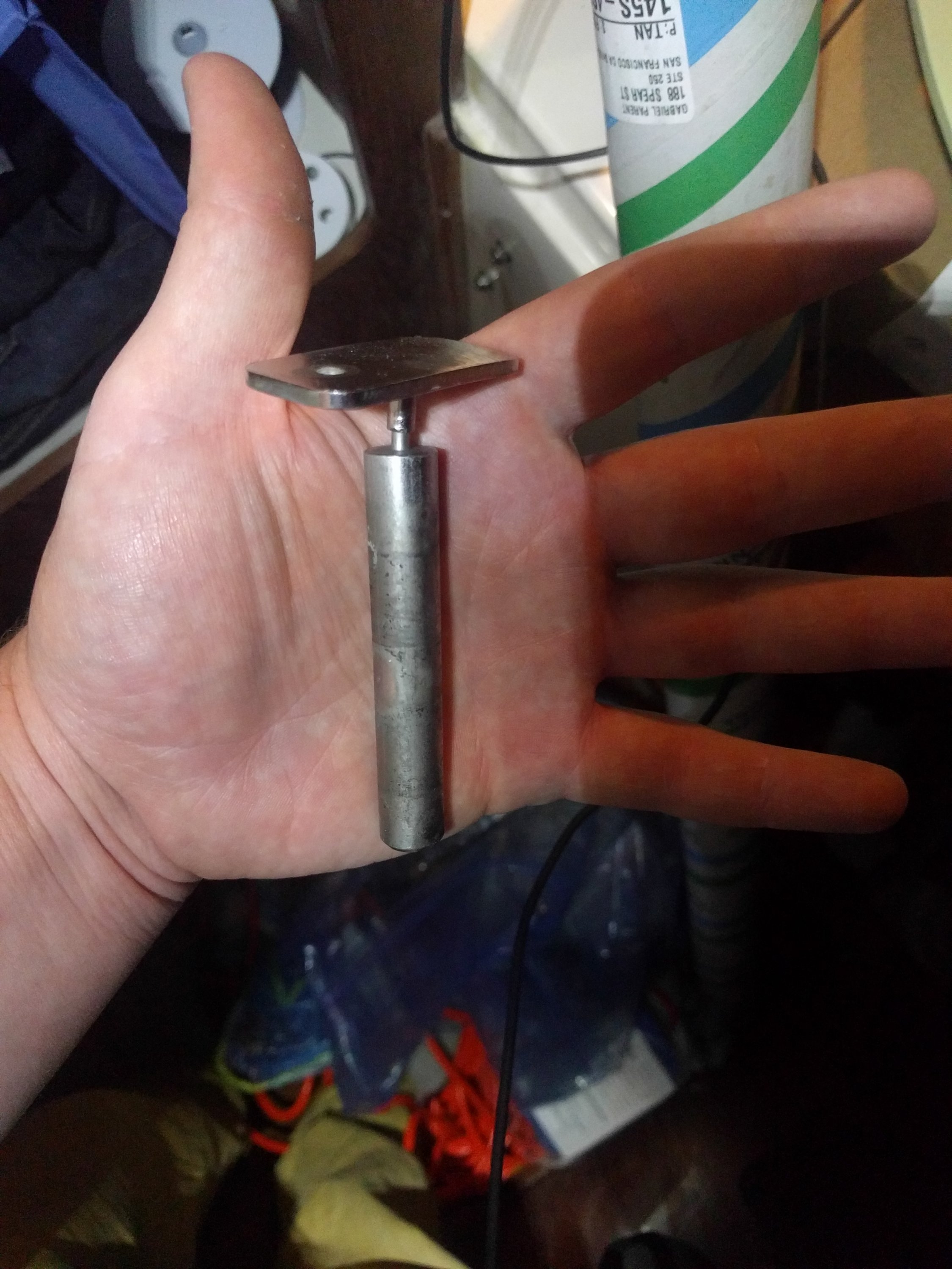

Hi,
The mast is down on my 1984 H37C. I decided it was a good idea to try to clean the sheave (one of which was frozen). I succesfully removed what I would describe as a "sheave bushing" (see picture) for the main halyard, but the other one broke off. So the bushing is stuck inside.
Anyone knows if it's still possible to find that part somewhere? I'm a bit lost in the rigrite.com catalog, plus I'm not sure what brand of mast I have. Any information would help.
The alternative is to leave the bushing inside, and screw a protective plate outside, but that's only delaying a problem down the road (e.g., when I absolutely have to do maintenance on the sheave). Any other creative solution is welcome.

You can get the sheave pins here.

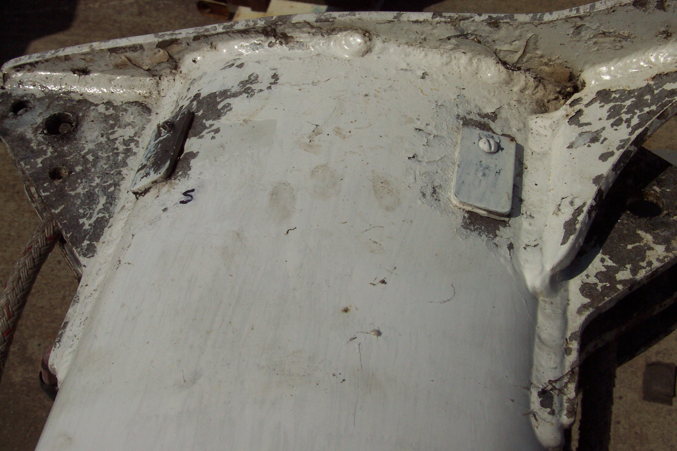

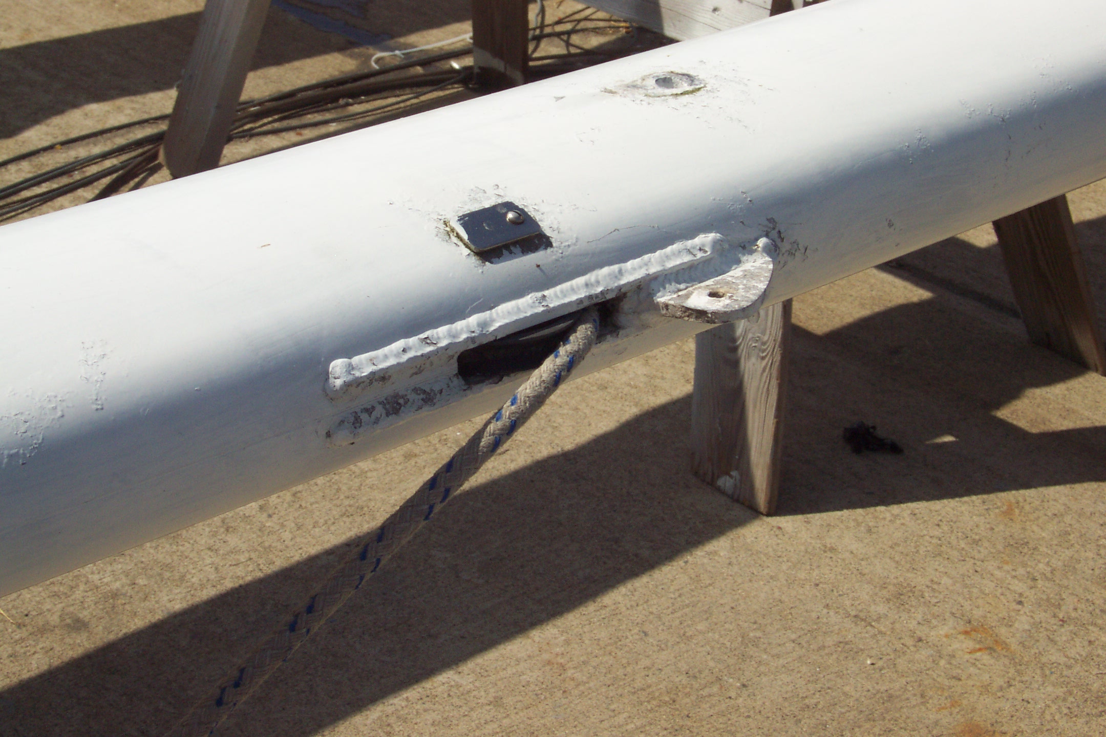

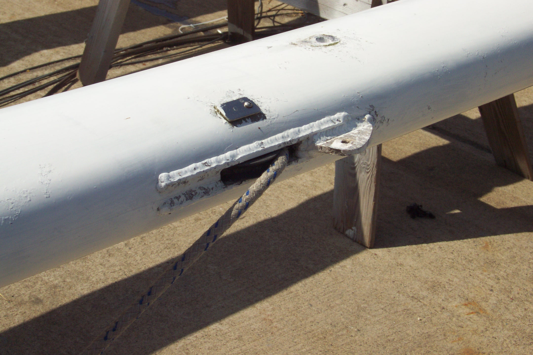

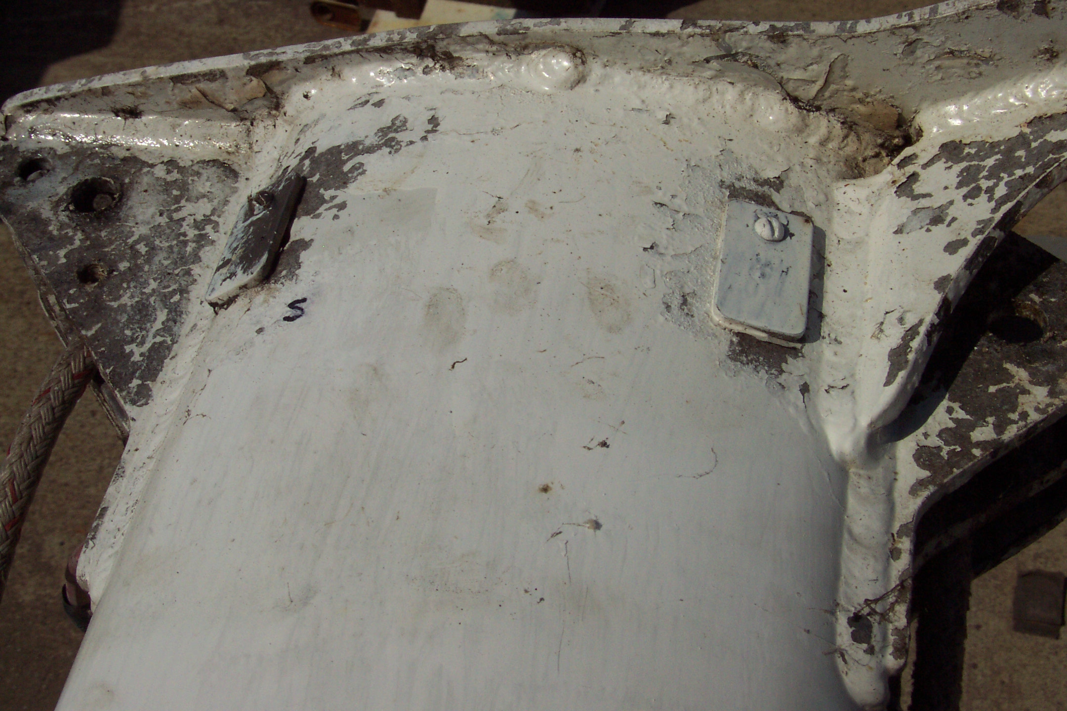

Jack, do those axle pins come out of the places you can see in the attached pictures, on taken at the mast head and one at the staysail sheave. Also, what is the condition of the sheaves. Please let us know how it turns out.
It seems smart to fix that all when you have the mast down. The pictures are from my mast paint job in 2002 (before repainting)

Finally coming toward completion on the mast re-hab project. For the sheave axle pin, I ended up drilling a small hole on the opposite side, and used a punch to get the broken axle pin out of the sheave. I sealed the hole, and I'm actually quite happy to have drilled it since this is a better design IMO than having to pull on that axle pin.
Thank you Jim, that axle pin from rigrite.com is exactly what I needed. I ended up having to redrill a screw hole for it but that was easy.
@John: yes, the axle pin come out of there. Be careful when pulling that plate on, it's attached to the pin itself, and you'll break it if you pull too hard. But as you can see, it's not a huge deal if you break it. Just drill a hole on the opposite side and punch it out. The sheaves were okay, I cleaned them as best as I could, and reinstalled them with lanocote around so they wouldn't freeze. Out of the 4 sheaves in my mast, the 2 that weren't used were completely frozen. They can now move freely, although I don't really have a use for them.
