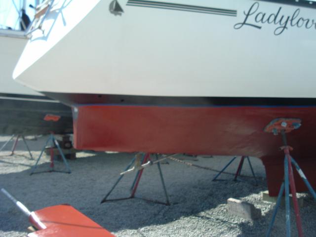

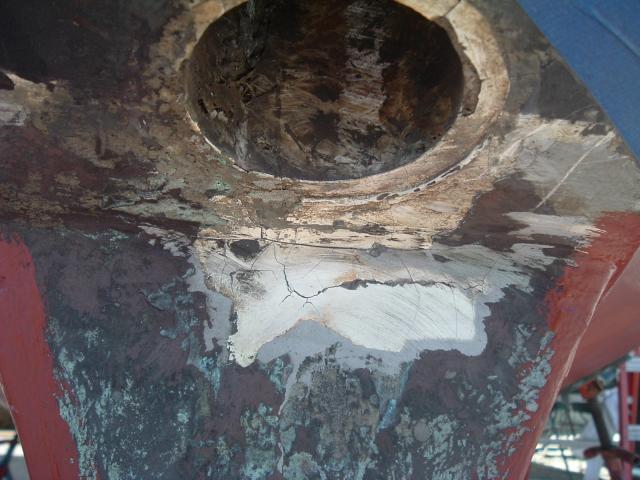

A third factor was a persistent drip around the rudder stuffing box. I had restuffed and adjusted the box at the end of the Erie Canal. So I knew it was the rudder tube and not the stuffing box. It made sense then to have the rudder pulled since I was so close to a real boatyard.

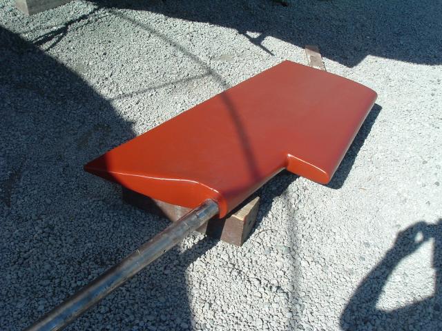

Sure enough when we pulled it the rudder stock was bent. And the first picture shows the source of the drip. The real education was seeing the inside of the rudder, cheap foam and huge voids. The stainless was like new, no sign of corrosion. It was rebuilt with a quality foam, no voids, and a completely new skin. The stock was straightened and the existing frame of the rudder was used.
