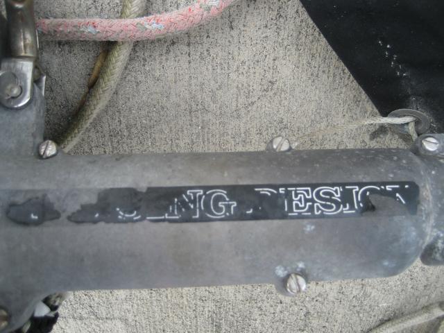

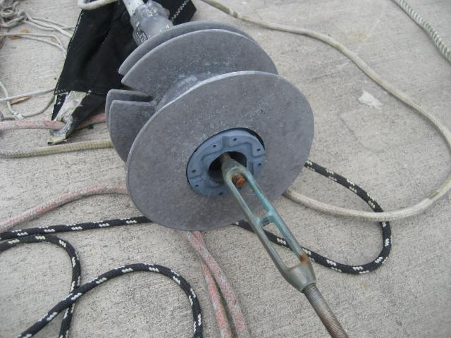

Looks like the furler needs attention. I dont know the maker and therefore cannot start looking for parts. Looking at the enclosed picture, is there additional parts missing of the bottom of the drum?? Is it too old to find parts for it?? Looks like the decal said CRUISING DESING, however I did not find any manufacturer logo or name on it. Does it look familiar to any of you??

Wow! lots of ground covered. You had a great day! In the olden days ther were Cruising Design (CD) roller furlers. I haven't, but an internet search or an e-bay search may find you drawings or parts.

That is a really old CDI furler: http://www.sailcdi.com/ . Worth a call to see if parts are available. Most of the blocks could be repaired with new sheaves. But it requires drilling out the rivet heads and either reriveting or bolting. E-Bay is a good place to look.

Thank you for your insight. I should have waited till I got home and researched the furler info. Yes there is a cruising desing furler company (CDI) and it looks like I am in luck.
