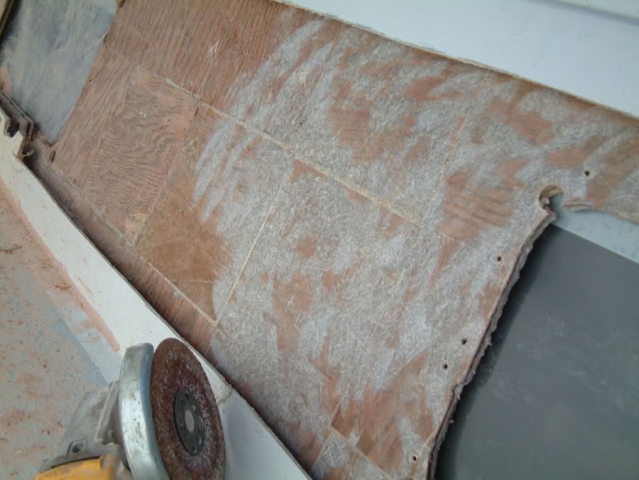

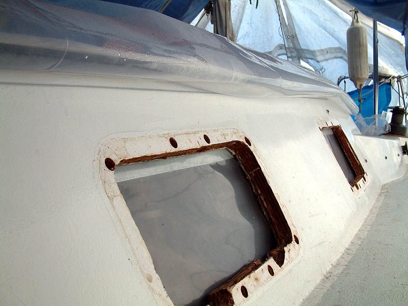

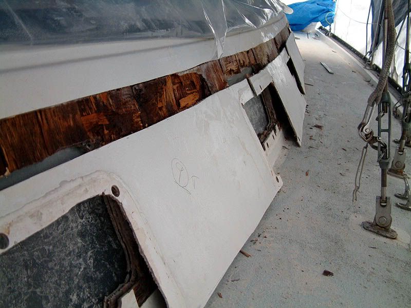

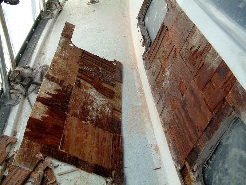

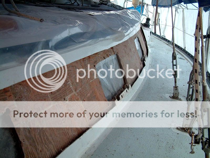

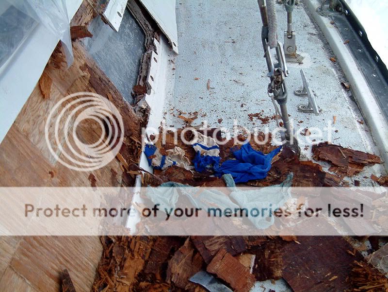

So many things to write down, so little time. First let's say that the cabin sides where still very ''solid'' even if the core was fully saturated and fully delaminated and in an advance state of rot. This is because there are two thick layers of fb on both sides of the core. Was is still strong enough to keep everythig where it had to be to use the boat in light air every now an then? Yes (it did well in 12 foot seas). Could we have done it differently ? Probably. Would I ever considerdrilling and filling with epoxy ? No (the explanation that follows won't come from hours of reflexion, but from someone who spent 14 hours on the road today).
I'm sorry DianaOfBurlington but I do not feel that this is too much work, and do not consider drilling and filling with epoxy to be a proper way to fix such a problem. Just take a look at the video I linked in the post above. I think that it's better to do this job once, and to do it right. In this case, drilling and filling with epoxy would have been as effective as injecting epoxy in oatmeal (the core is about as mushy and watery anyway). For sure it's going to be better than what you've started with, but as far as I'm concerned, you end up with mushy stuff stuck in a somewhat hard matrix. It may feel rocksolid underfoot, but that doesn't mean it's going to handle a sharp impact as it should. It takes little energy to cause a fracture to migrate in such an heterogeneous matrix. You also have to remember that things rarely break when it's dead calm out at sea... Furthermore, the original construction technique, with marine plywood, was far from ideal. Water migrates very far from the point of entry. The cabin sides where basically fully delaminated, we could peel every layers of the plywood by hand, even dead center between two portholes. Nothing sound could be found when sounding with a hammer, and the moisture meter was showing sky high readings. I do not think that filling with epoxy at such a large scale would have made a big difference timewise. Remember that we've done the whole deck two years ago, so the learning curve is behind us. This is a fairly quick job to do, the last pictures displayed are about 40 hours in the repair process. Also, the whole process will cost less than 500$ in material.
As for the comment about solid meat around the portholes to avoid further water intrusion, the pictures are not yet showing final stages of the repairs. The core is not even cut so that the ports can be fitted. The core (close cell foam) will be cut to size, than we will use a router to grove a recess all around the porthole footprints and fasteners holes. Once that is done, we will fill with thickened epoxy. Finally ports will be bed in butyl as shown in the link bellow (a special thanks to Maine Sail for these instructions).
