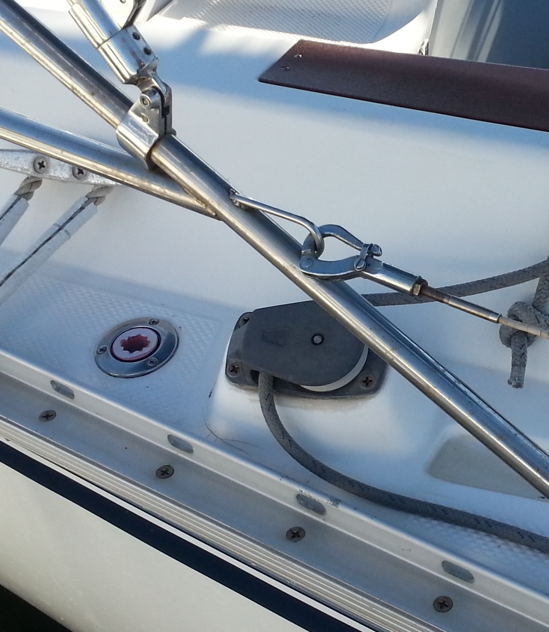

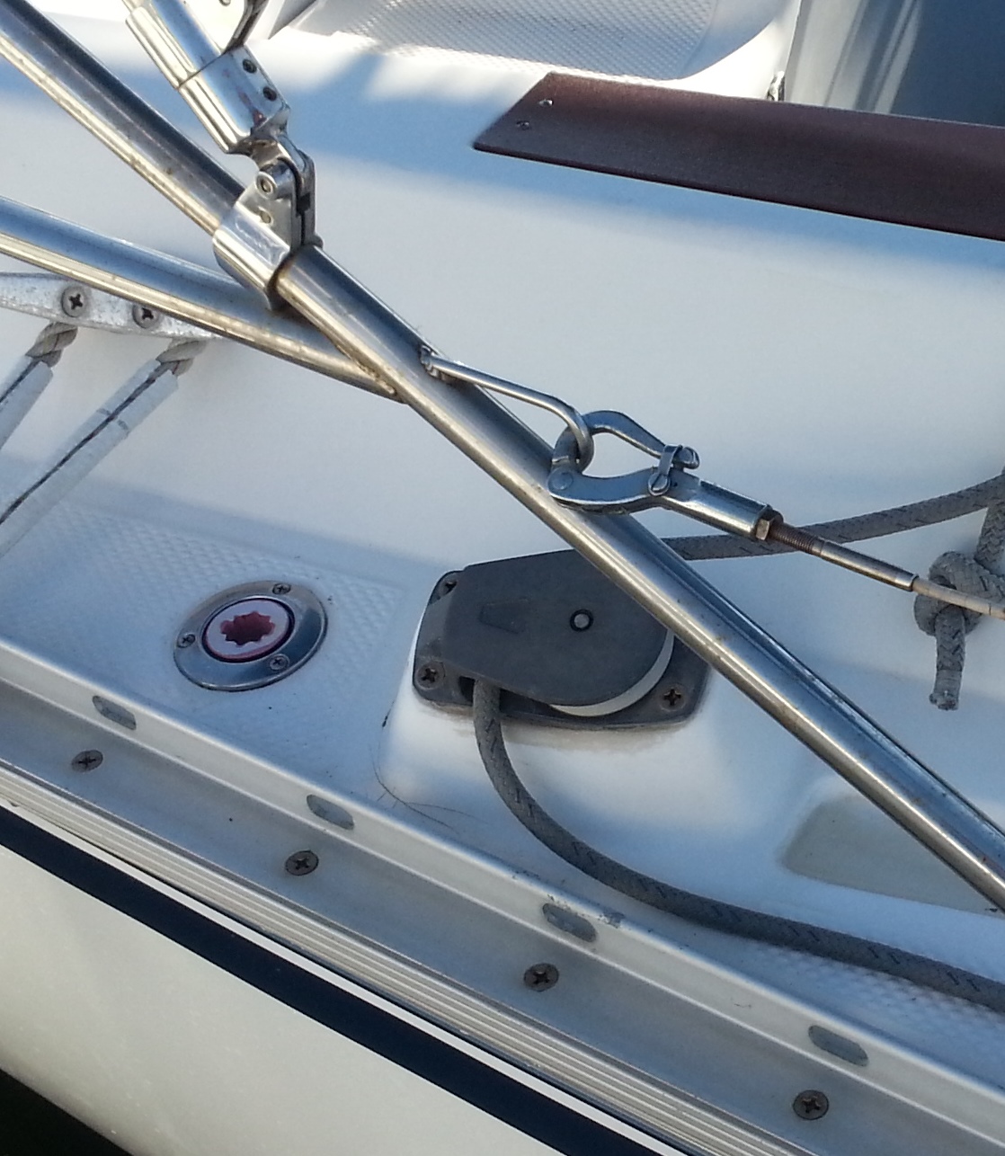

Just looking for a little direction. Has anyone replaced the turning blocks for the head sail sheets on a Cherubini 37? Looking for a good sourcing option. Most likely online. Hoping to replace just the inner wheel. Picture attached...

Look to see if there is s manufacturer name and size on it. Then go online and find that one or one that closely matches and make sure it will carry the sheet diameter that will go through it. Lots of manufacturers and prices like Lewmar. Schaefer. Harken, etc. Chances you will have to replace the entire block but you might get lucky and be able to replace only the wheel.

Thanks "sail sfbay". Totally agree with that process. Small wrinkle just now as I'm in Alaska and the boat is in Washington. I was just hoping someone had the same setup and had some experience with replacing.
10,155
These guys used to do custom sheaves Mast + Boom Sheaves (dreamgreen.org)
I don't know if they are still doing that.. If you took the sheave itself to a machine shop, they could make a couple from a plastic of your choice, delrin, nylon, etc. Those blocks look a lot like the turning blocks on the H-34's; the pin can be removed from the underside of the body. I think Allan may have replaced his and posted the process.. a forum search would pick that up, I think.

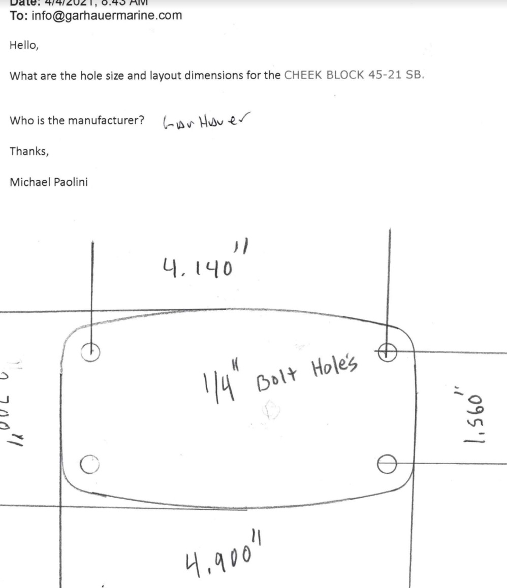

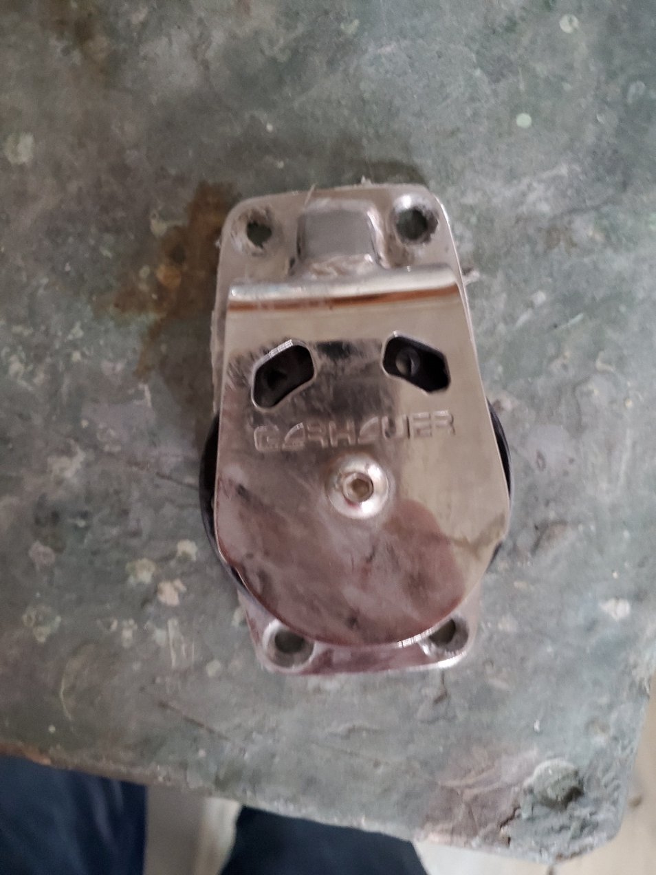

Figured out the direct replacement for the turning blocks. I'm just finishing a deck Awlgrip and have the turning blocks off the deck. A pic is attached. These were exact replacements for the original UV damaged turning blocks I had. 5 minutes with an impact driver to remove the old, and replace with these is all it took.
I ordered these as
from Garhauer's web site after way too much time researching this !! Garhauer was very helpful in responding and providing the screw dimensions in the 2nd pic attached.
After a season of use, these turn much better than the original turning blocks, especially considering the shives on the original were pretty beat up from decades of UV.
