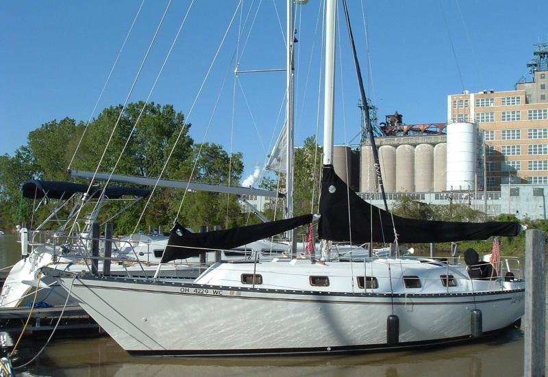

In this picture Ladylove sits as always, beautifully I think. Guessing that both water tanks are about half full and likewise for the port diesel tank. There are three batteries in the original location, the starboard lazarette. There is 100 feet of chain and another 100 feet of rode at the bow but on the keel. I installed a hawse pipe from the windlass. The windlass is a fairly light manual unit in the locker. You can't see it but she is perfectly level, no heel at all. So I really wonder what gives in that you have tried so many things.
