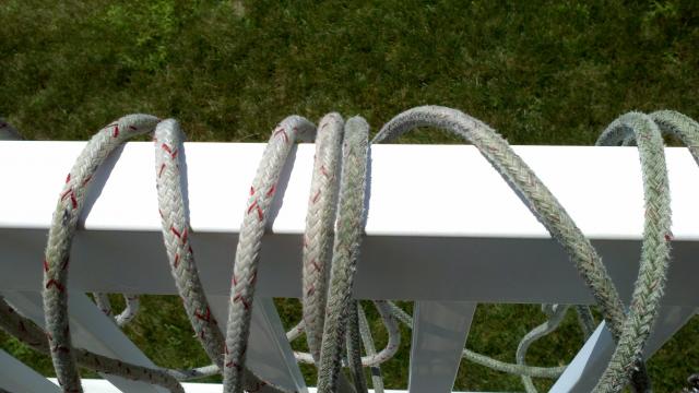

For those of us sailing old cruising boats. Any reason to worry about stretch in the halyards? I'd like to replace my 7/16" halyards with 3/8" Sampson from our SBO store. But I do not want to spend $2.00 a foot or more for a non-stretch racing halyard.
My current yankee(jib) and main halyards are ten year old NE Sta-Set X I think. It seems to be higher strength than Sampson, 5300# vs. 3700# in 3/8". Is that something to be concerned about?

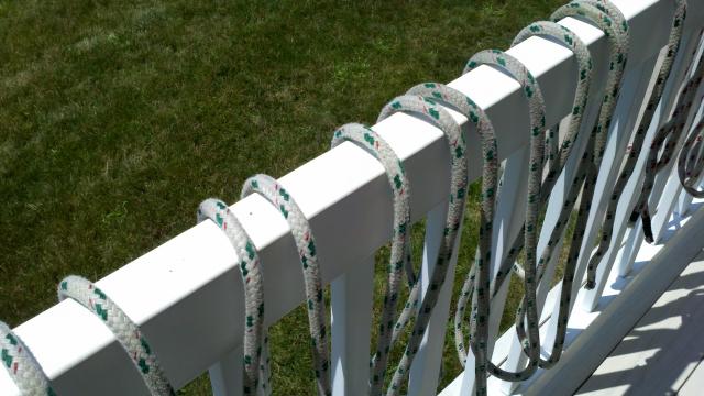

First picture is of a halyard that lives on the toerail mostly(staysail). The exposed part on right has no color left after ten years. The second picture is of my jib sheets, NE Sta-Set, also ten years old. Color is good and no sign of chafe. And these are exposed all the time. Hard to figure.
