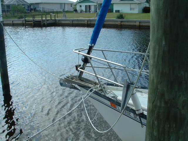

I replaced the Hyde unit on Midnight Sun with a Harken unit 1 about 25 years ago. It has a split drum so you can use full hoist sails if you want to. I probably have 25000 ocean miles on it and have never done any thing to it except hose it off. It is the only thing on my boat that has moving parts that I haven't worn out. (I am on my second pedestal for example) For you guys with small drums, try tightening your headstay. Headstay sag makes any furler harder to turn. I roller furl a 135% which is 23 feet long on the foot, without issue, with a small drum.

My boat has the long link plates which raise the tack to nearly pulpit height. Not sure they are necessary, but boat came that way. I use blocks hose clamped to the stanchions to lead the furling line back. Chet P. had sleve bearing blocks shacled to the toe rai, but there was much rubbing on the stanchion bases. I went to ball bearing blocks further inboard to reduce the friction.

Ed,
You can see my drum in the photos taken from the helicopter that are on the photo of your H37c thread. Yes my headstay is 9/32" with a half inch pin.
