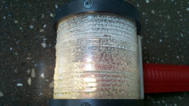

Brought home the cover of the AquaSignal steaming/deck light. After cleaning up the lens maybe it doesn't need replaced. Is the picture adequate to render an opinion?

The mast light on my H-30 was in similar condition I elected to replace it with a new fixture from Bebi Electric (made in Fiji) had to make an L bracket to mount on the mast out of 3" aluminum stock. Lest expensive light I could find, bullet proof construction. Low amp drawer and excellent light output.
10,229
Wow, Ed.. Ya have a world class case of CRAZE on that lens.. Surprised it didn't crumble when ya tried to clean it.. Probably time to get a new one.. :~)
1,483
I have a lens just like yours. Works fine. I put the old bulb back. It still works and I hardly ever motor at night, so I don't expect to wear it out..

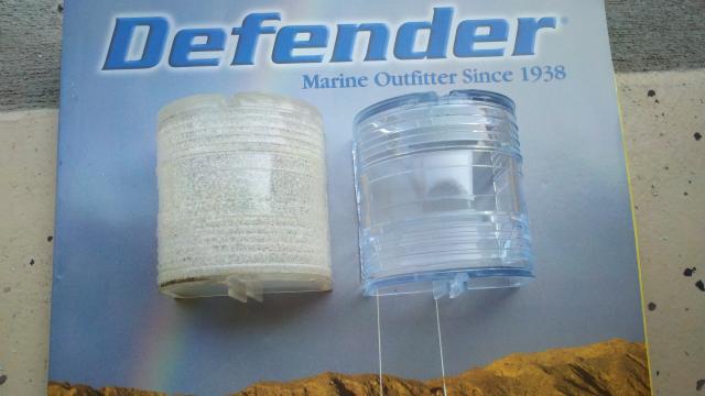

Defender order came today. Can you see any difference? :)
That is amazing. And I assume the Aqua Signal wasn't original either? (mine came with a Forespar unit, later changed to the same as yours) I wonder if applying ArmorAll or some similar product would slow down the deterioration. The power of the sun's UV rays is relentless. When I purchased my boat, I had to replace every single Delrin sheave on every block on the boat. By that time Merriman was out of business, so I used sheaves from Schaeffer. At $4 to $8 per sheave, it was a lot cheaper than replacing all the blocks. I hope I'll never have to do that again, but my steaming light is probably due...
