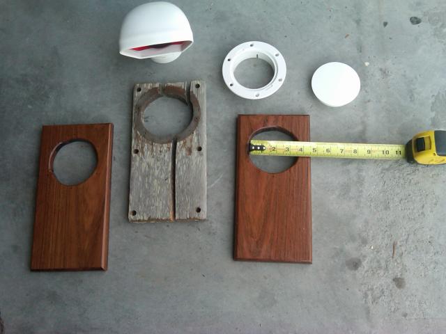

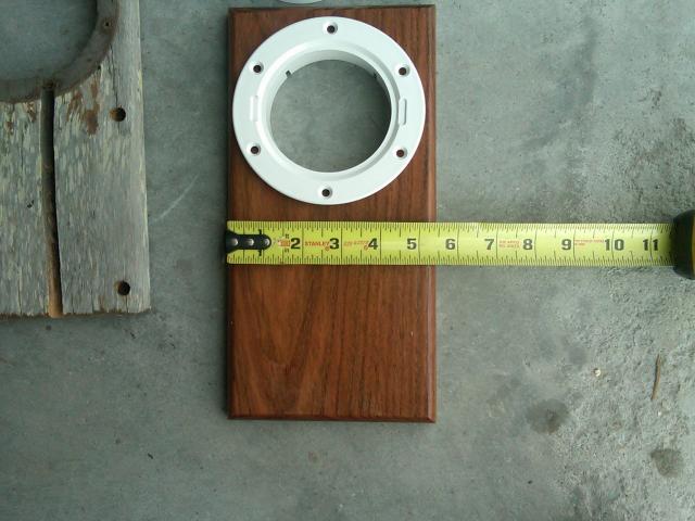

Hi Ed
So happened I am working on my dorades this morning. The wood top is 5 1/2 wide by 11 long. The old cover had a 4" hole for the vent. The actual sleeve on my new vents is 3 1/2 in wide. However they call it a 4" vent. As you can see, the actual screw flange as almost to the edge of the wood. If you use a vent, the top part will be wider than the actual wood base. Some vents have a 4" hole and an 8" top.
I am installing new baffles and fibreglassing the interior of the dorade box. It' s ugly in there.
Cheers
Jose Guidera
S/V Bonheur

Thank you Jose. And your new tops look really good. Yeah, if the box is original the inside is pretty scary. I did the same thing. With the top off and after a good cleaning I painted a thick coat of epoxy over the whole thing. Of course you have to be careful to keep the drain hole open. The vents look so nice when they are new.
So from your measurements I will probably have to enlarge the hole to 4". But there is room. So I can order what they call a 4" vent. And the fan part of the solar vent will extend beyond the back and sides. That is a concern. Later models of the H37C had that nice stainless rail protecting the horns. Not on my '79 though.
