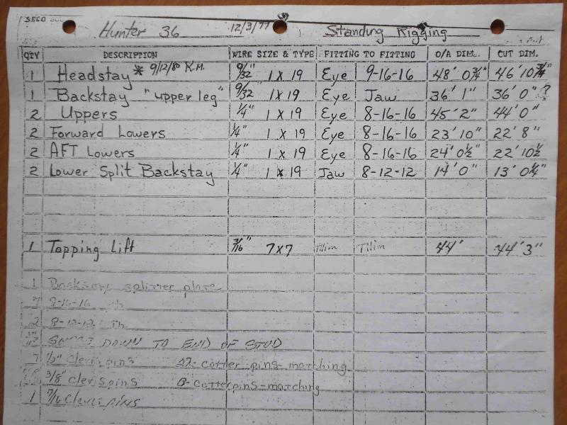

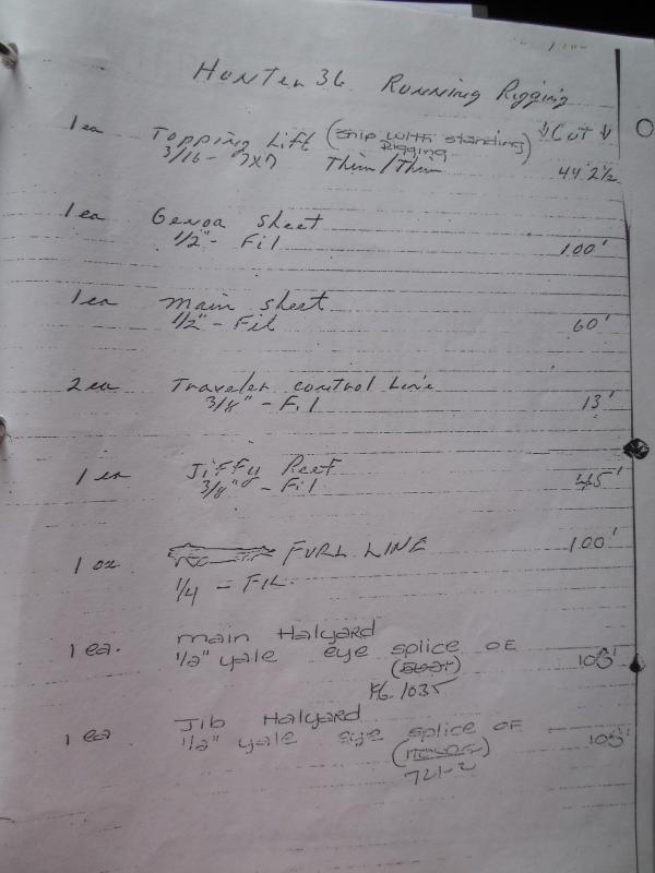

If SBO doesn't have the info, here is a photo of the running rigging page that was in the owner's manual binder that my PO left in the nav desk. And for your future reference, I've also attached a copy of the standing rigging spec sheet.
Comments to info on the running rigging sheet:
- I would suggest use as a starting point since modifications by PO's might have changed the requirements.
- Line technology has improved since 1980. Depending on how hi-tech you want to go, certainly 7/16", rather than 1/2" is more than enough for the sheets and halyards. I find 3/8" is enough diameter to be comfortable for the main halyard which is what I have now. The jib halyard is not used frequently, so 3/8" I think should certainly be ok for anybody. For my jib sheets I am currently at 7/16" with standard yacht braid. But for my next go-around, I probably will go down to 3/8" and up to the next level of strength and stretch resistance.
- Topping lift ... doesn't really pertain as it is fixed wire (also on the standing rigging spec sheet).
- Main sheet ... If you think that you might modify the stock main sheet block arrangement to add more purchase, then go longer. I modified from 5:1 to 7:1 so I could avoid using the cabin top winch. The 60' main sheet length is ok, but I can't let the boom all the way out for downwind sailing. A work-around ... sort of ... for me is to let down the traveler out all the way although with the short duration of down wind sailing legs on San Francisco Bay, I don't usually bother.
- Traveler ... Again, if the PO has added purchase, then 13' on each side will be too short. I don't know what the original traveler purchase was, but I suspect 3:1. My PO bequeathed me 5:1. 26' on each side is just right. The traveler can run all the way to one side and the other side still has enough line to flop a few feet past the cabin top.
- Your mainsail reef points are likely different than the original sail that was delivered with the boat. And you likely have two reef points. So you've got to do your own measuring. Also depends on how the lines are rigged/routed.
- Furling line ... I don't know the length of mine. But I believe shorter than 100'. Also, the 1/4" diameter as shown on the spec sheet is pretty thin. Maybe not for strength, but the thin diameter has a greater tendency to bury itself in the wraps on the furler drum. Suggest that you do you own research on the length and diameter.
Main halyard length ... When I replaced mine, it was suggested that I go longer so in case of emergency the halyard can be used as man overboard hoist.
