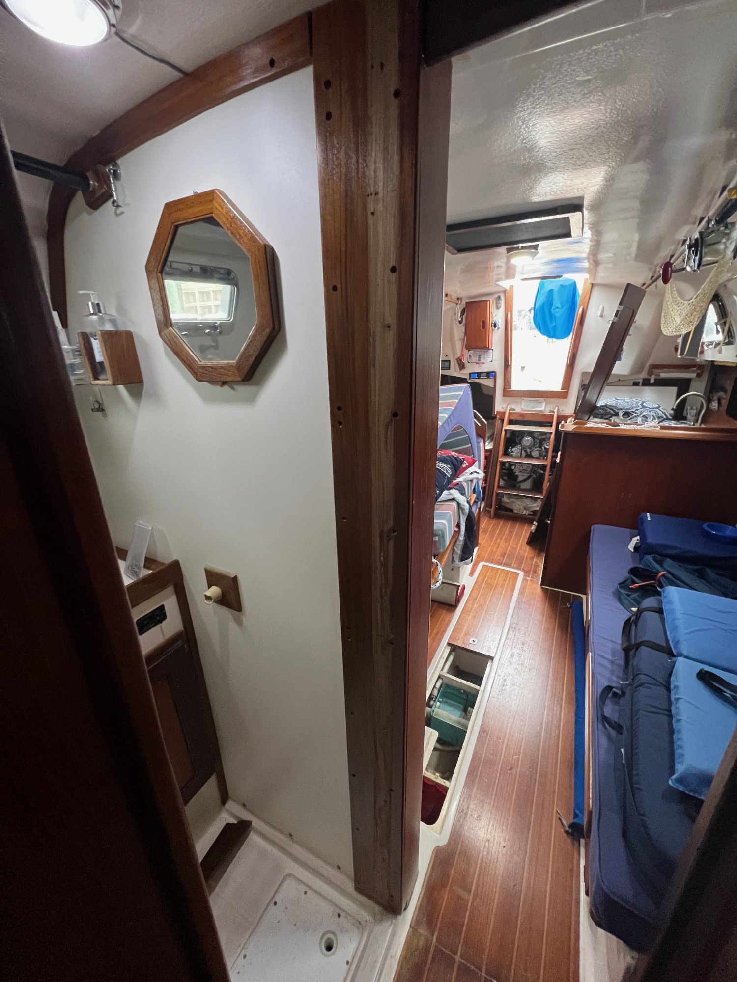

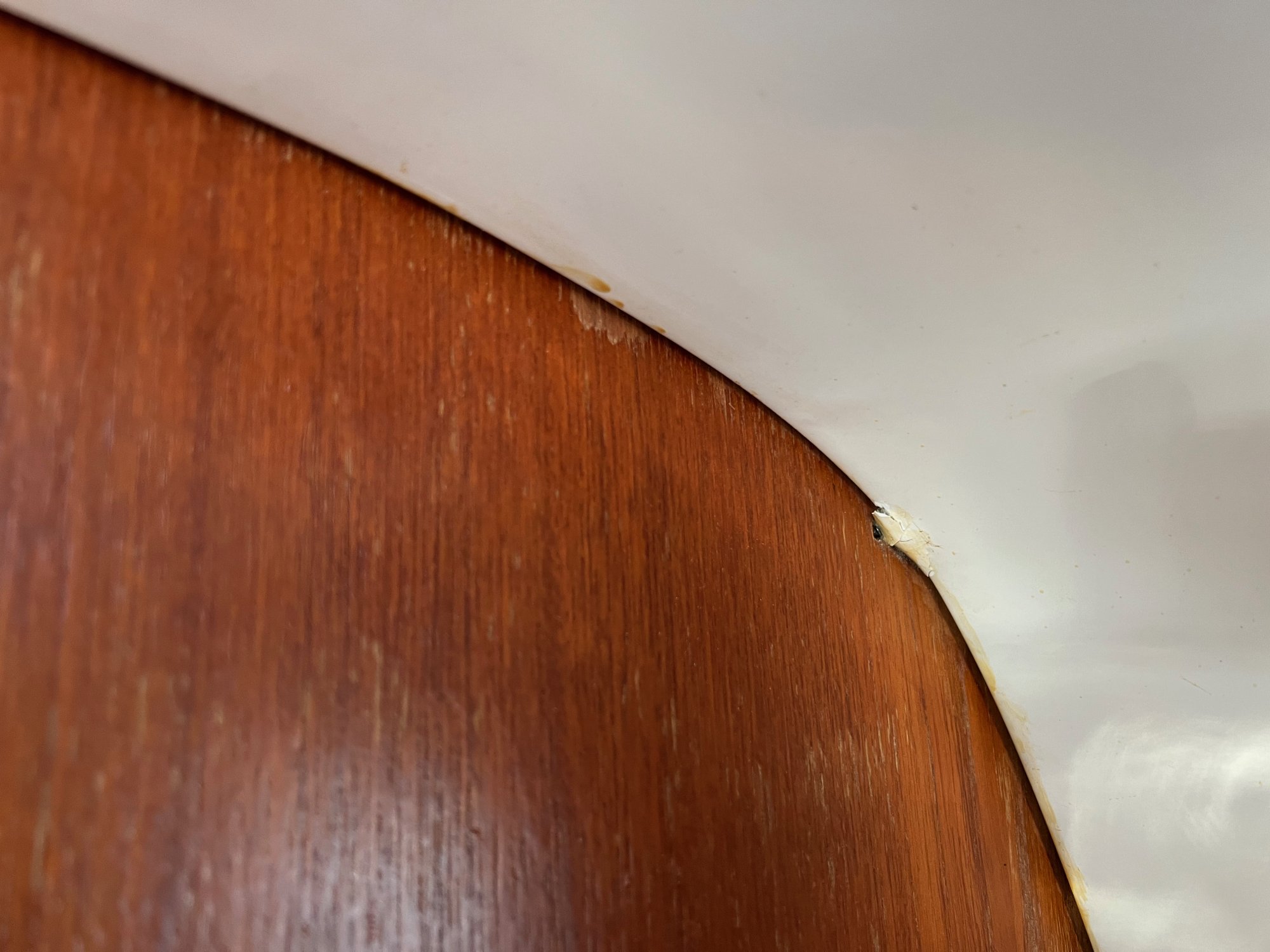

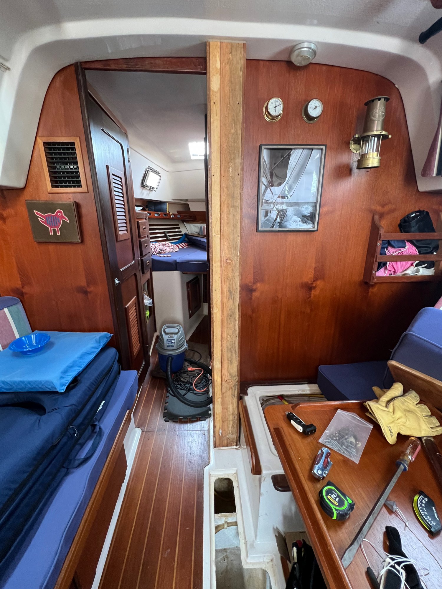

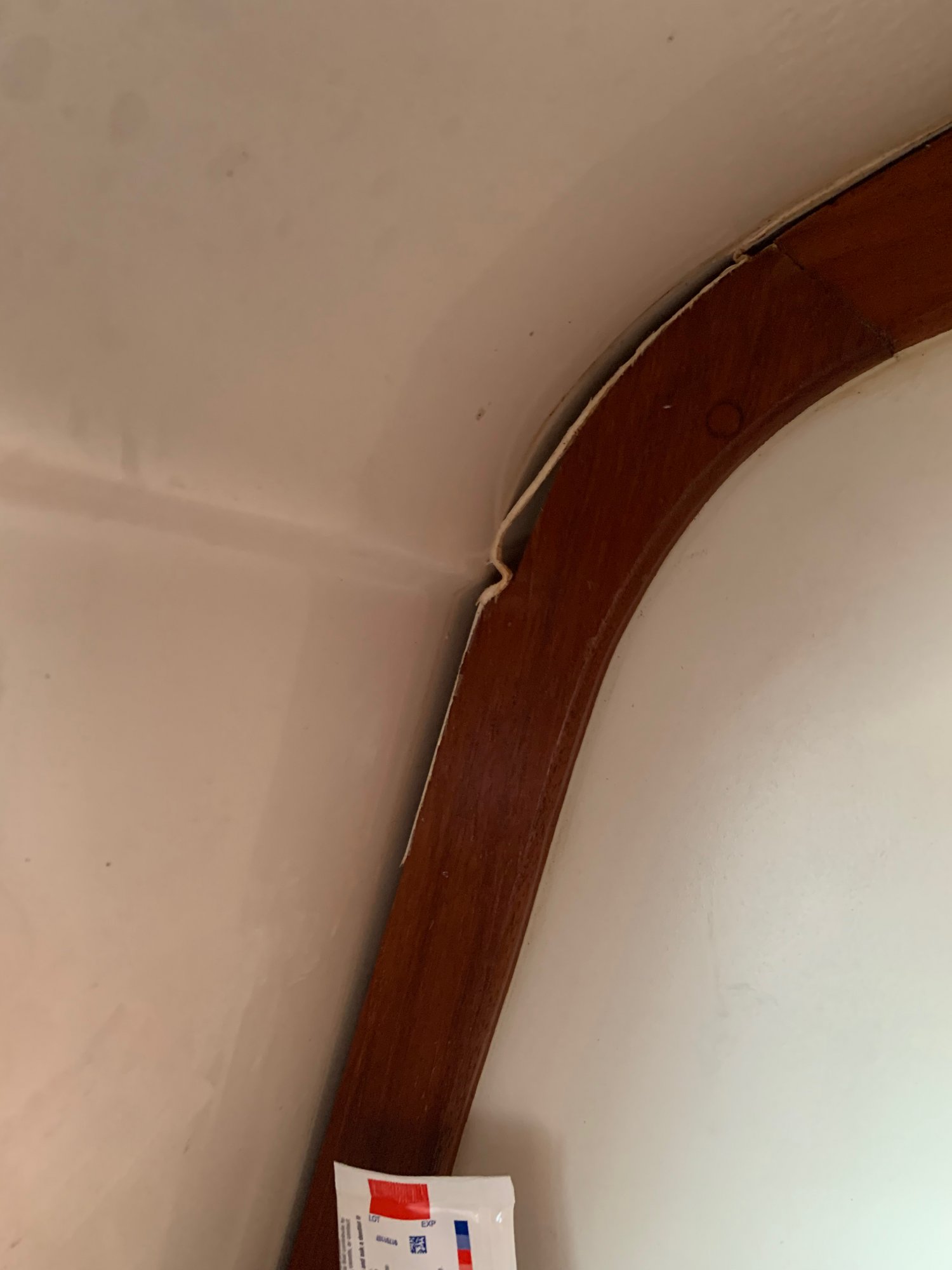

During the process of rebuilding the base of our compression post last year, I took notice of the outboard, upper portion of the aft bulkhead in the head on our '82 H36. The corner is separating from the inner pan. I understand the construction of many of these Hunters was to use an inner "pan" glassed to the outer pan (hull) - negating or minimizing the need for traditional stringers or even structural bulkheads to some degree. Is that a somewhat accurate statement?
Anyways, regarding the separating of the wall in the head, should this be cause for serious alarm? Is that bulkhead a structural component or just interior cabinetry? I think it's the later, but the fact that it seems to be supported on its interior side by the compression post makes me think otherwise. Hope the pictures make sense. Thanks for any insight.

Not familiar with that boat but if it is made like the old H-34, those bulkheads are there mostly as "cabinetry".. They do take a compression load and the starboard one holds the compression post in place. The post is generally not attached at the bottom. Your first statement is generally correct.. Had the compression post sagged? If so, the cabin would have slightly "squished" down as the top fiberglass beam sagged , and that could have caused the bulkhead to pull away .. I wouldn't get too excited but I would keep an eye on it.

They look OK to me. If you don't see any rotten parts around the hull side it's probably fine. I'm currently ripping mine out and yours look ok.
