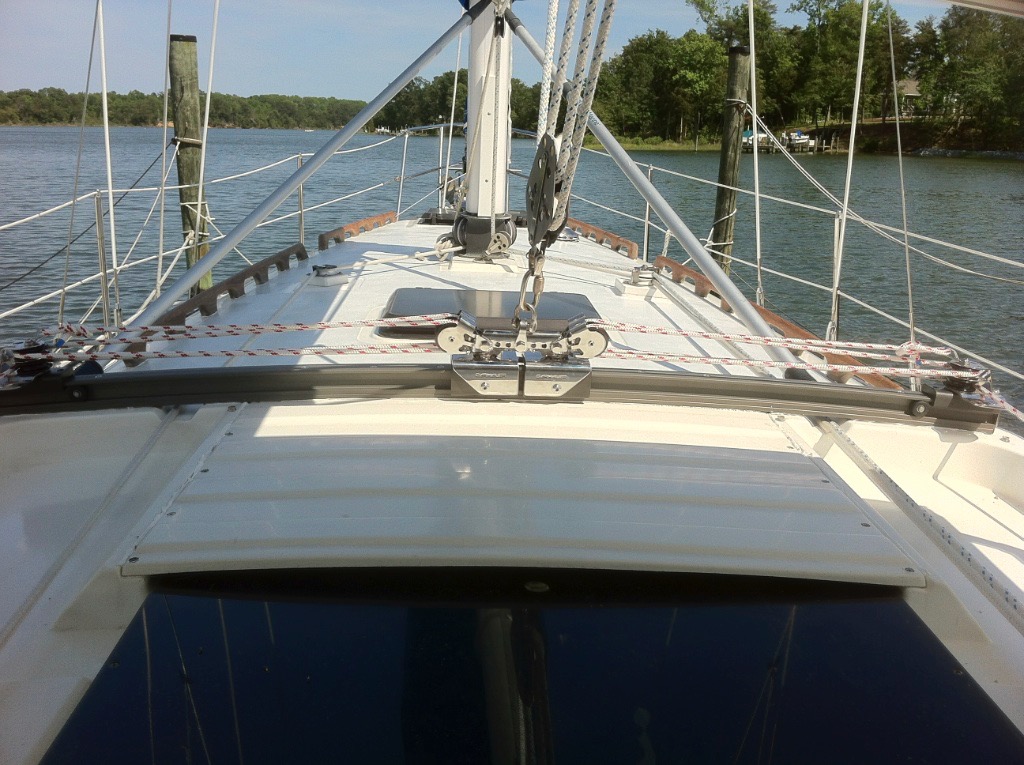

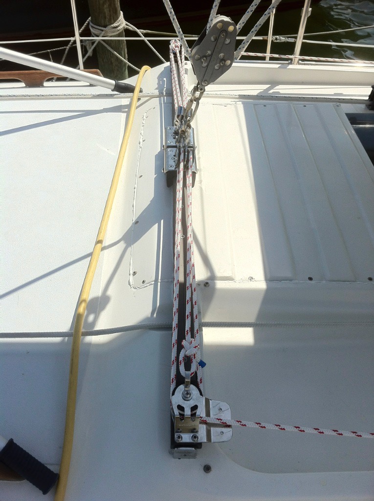

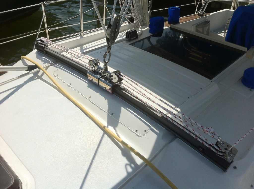

Thanks, I just sanded the old paint as much as practical (only in some spots was it taken to bare aluminum) then primed and top coated using the roll and tip method. It looks OK from about 10', then you can see the high/low spots...certainly would look better if taken to bare all over, but not worth the extra time in my opinion.

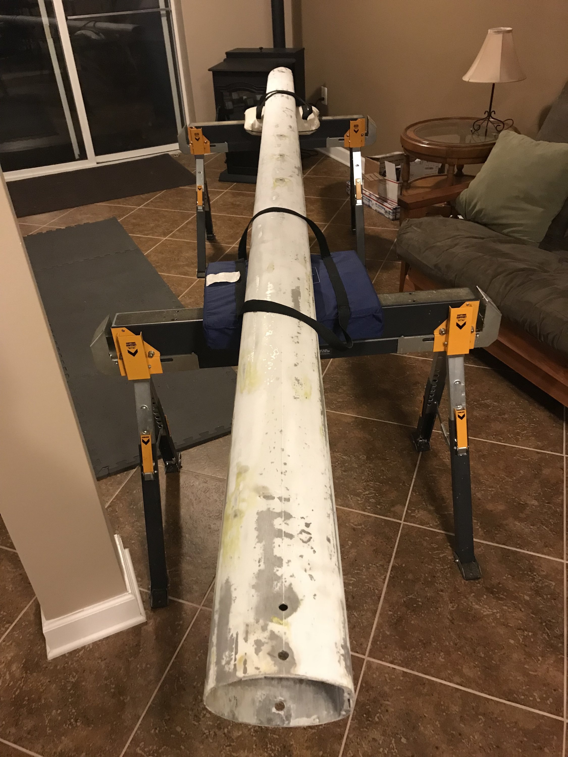

Thanks. Looks great in the photos. Still comparing options for mine. Trying to find somewhere locally that can anodize, which would be my preference if reasonably priced, but am having difficulty doing so for the length which is 12’-9”.

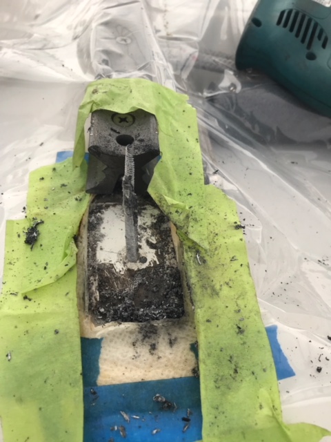

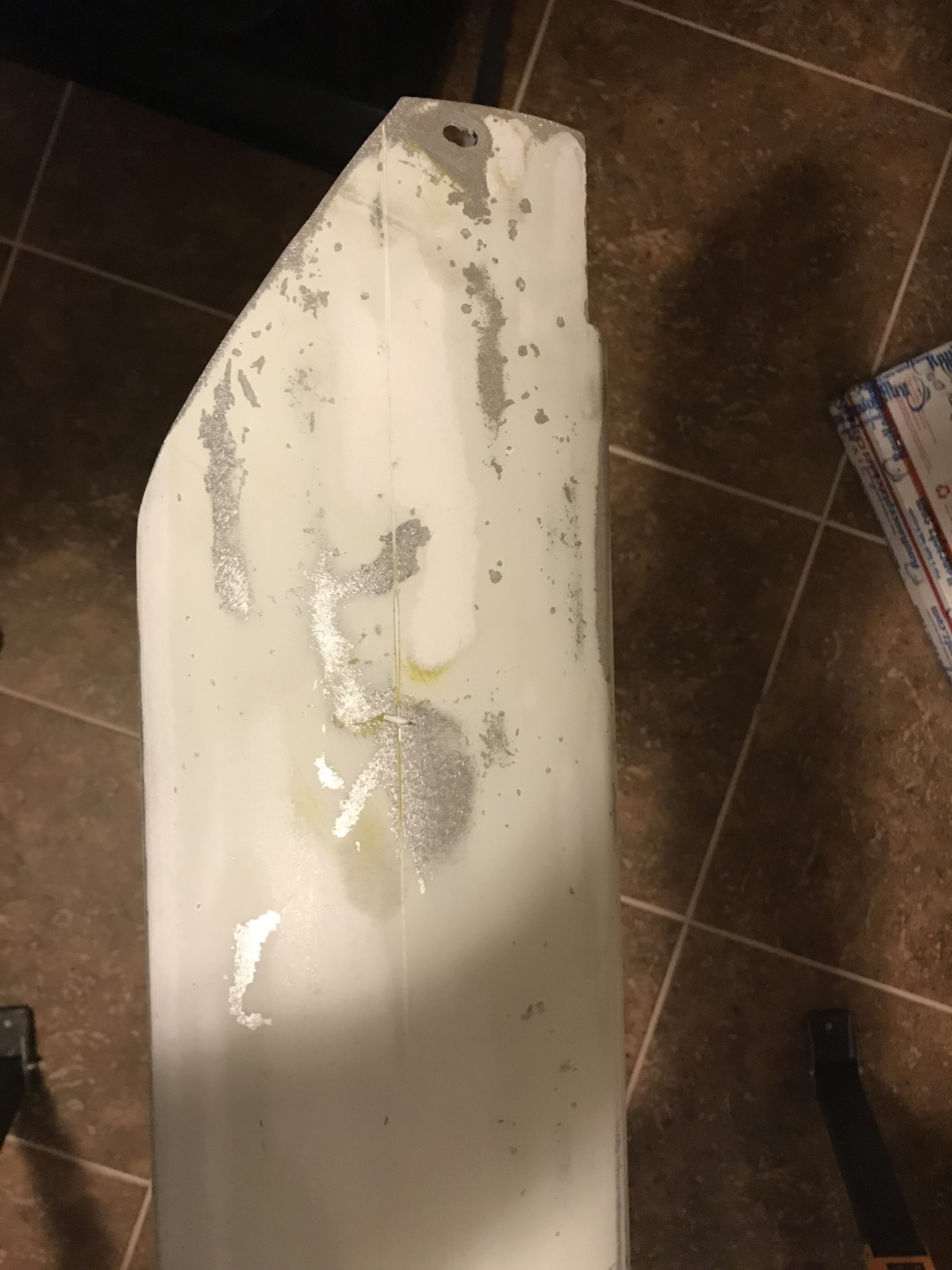

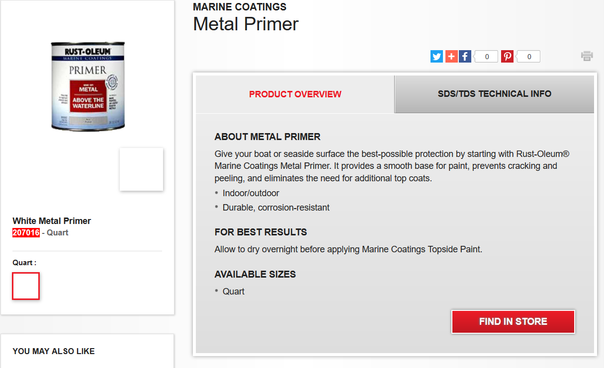

I think I am probably going to paint rather than try to anodize after all. I sanded all the old paint off and there are a number of blemishes here and there that would probably be better painted, plus the anodizing seems challenging given the length. Now I have to decide what paint to use. I think you said that you used Rustoleum marine primer and top coat. Is that the Marine white metal primer (207016):

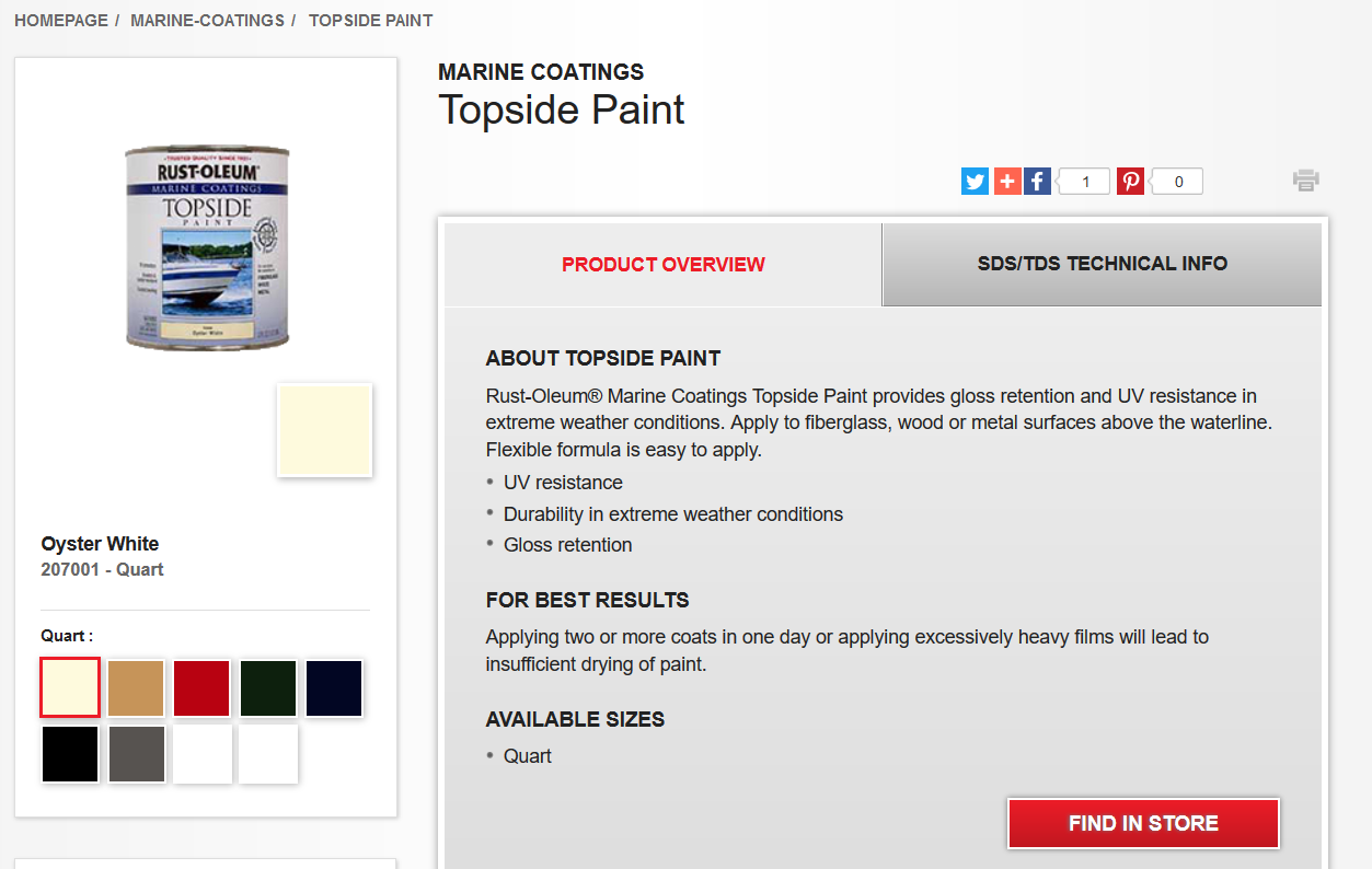

and marine topside paint (207001):

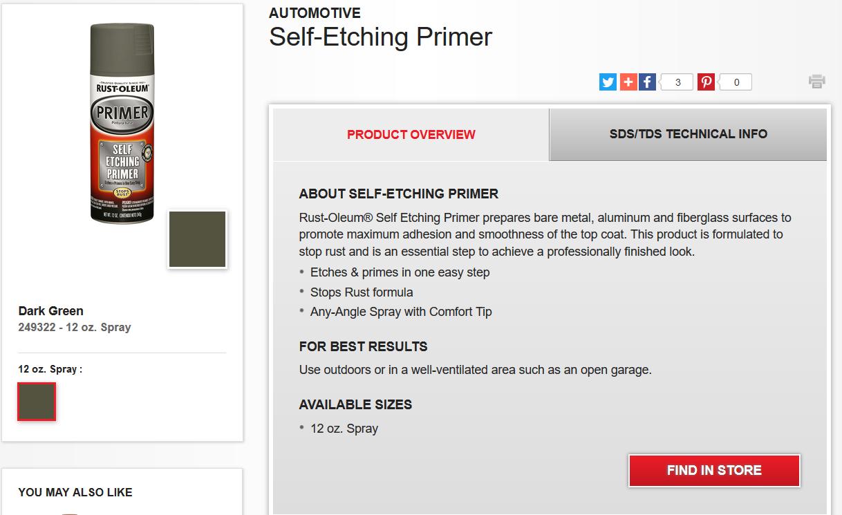

ClouDiver said he used self-etching primer (2449322?)which seems to be an automotive product and only available in aerosol:

Yes, I used the Rustoleum Primer and Top coat you have pictured above.
Thanks again Chichiflys. Good to hear. So I understand you just sanded, primed and painted, leaving the old paint where sound. Did you roll and tip both primer and top coat or just the latter?

TM - I roll and tipped both the primer and top coat. Hopefully it'll last a while.
