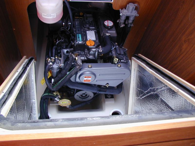

Dec 19, 2006
5,832
Hunter 36 Punta Gorda
2007-h-36
This is with my compainon steps easy to remove and work on motor and you can see the pump impeller is really easy to change for sure.
356 steps a little different but not much.
