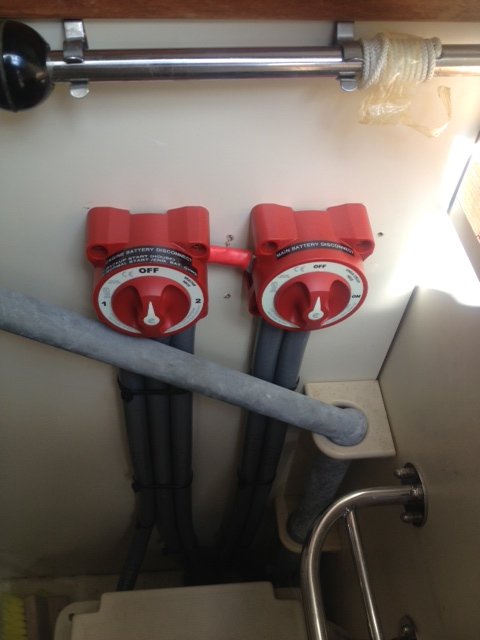

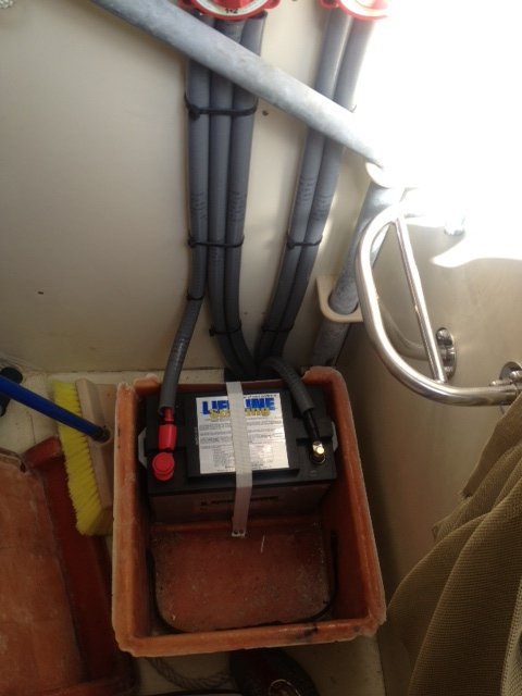

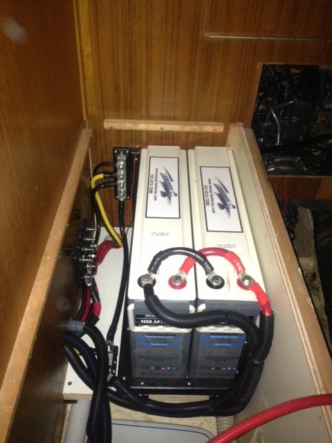

I put 2 Northstar Slimline M12-210 AGM batteries in a compartment under the aft bunk behind the bulkhead for the port side cockpit locker for a house bank (2x210 amp-hrs). I put a Lifeline Group 27 AGM in the old battery box in the port locker. The new house bank is almost on the centerline of the boat to balance the extra weight. The photos shows the house bank, the engine start battery and the new battery switches.
