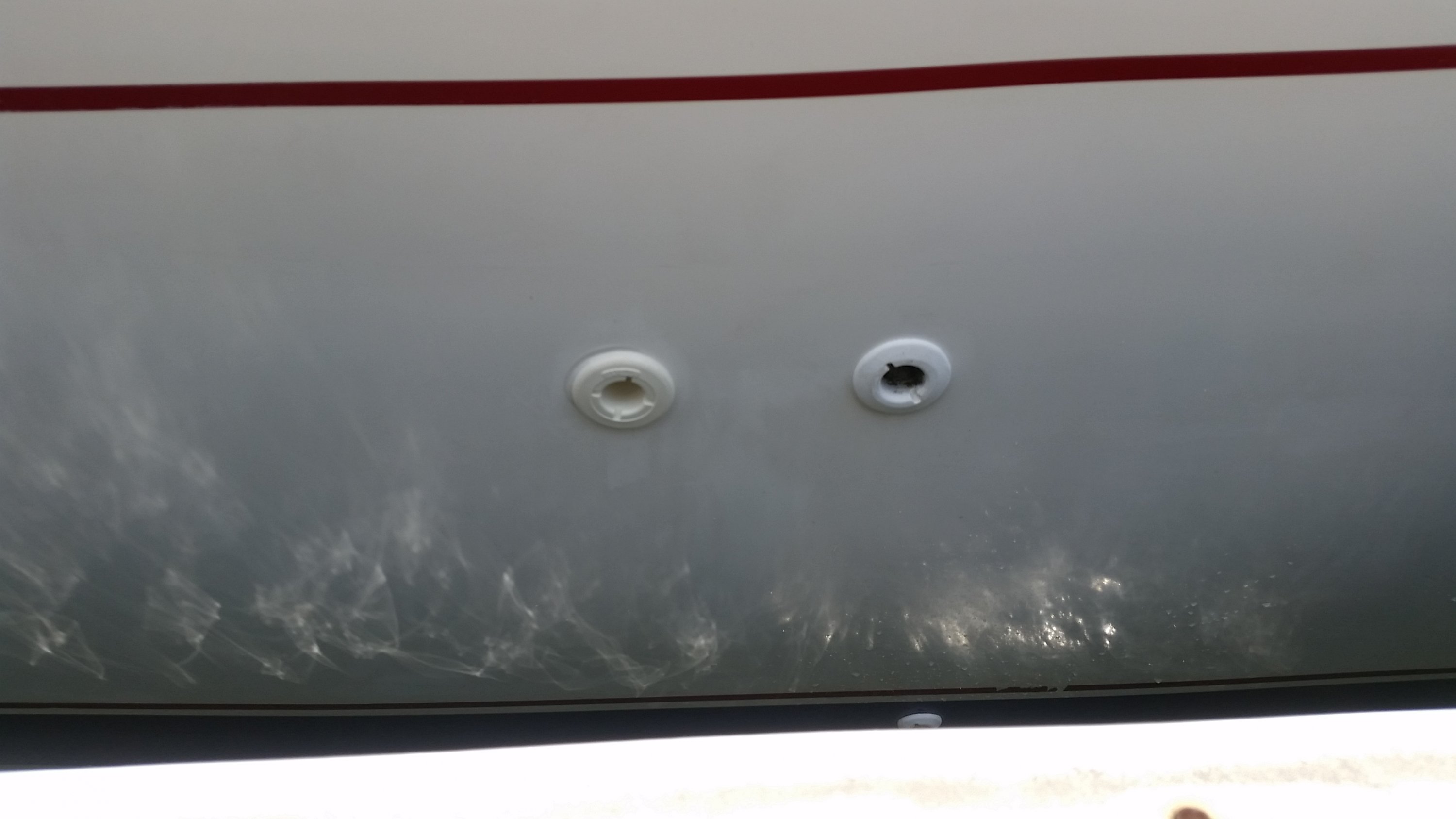

Started by pulling the back of the closet apart to decide where to drill the new hole for the discharge hole. I put it at the same height as the existing bilge pump discharge and about 6 inches aft. New discharge on the left

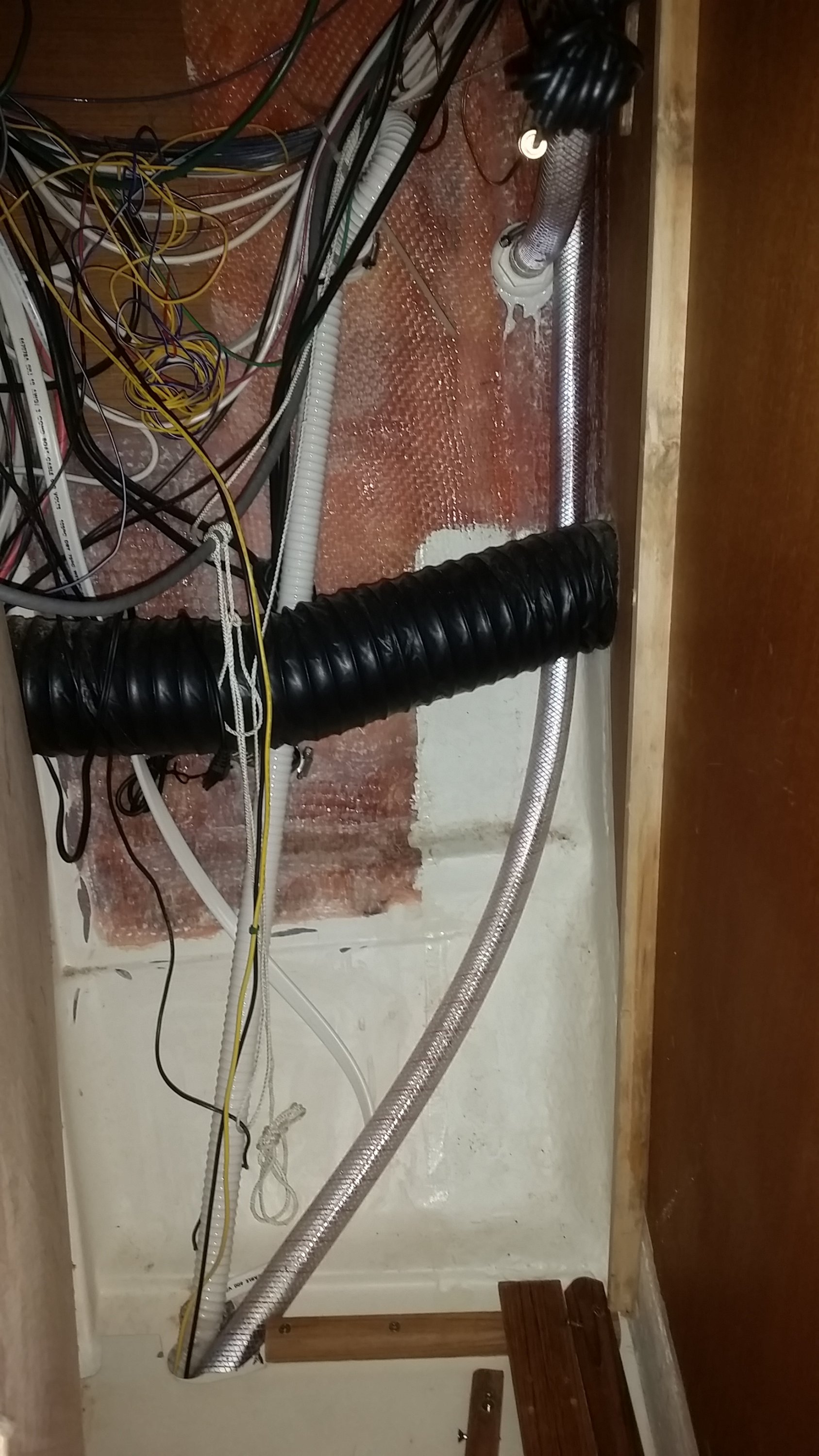

Inside view in the closet after installing the mushroom fitting and hose.

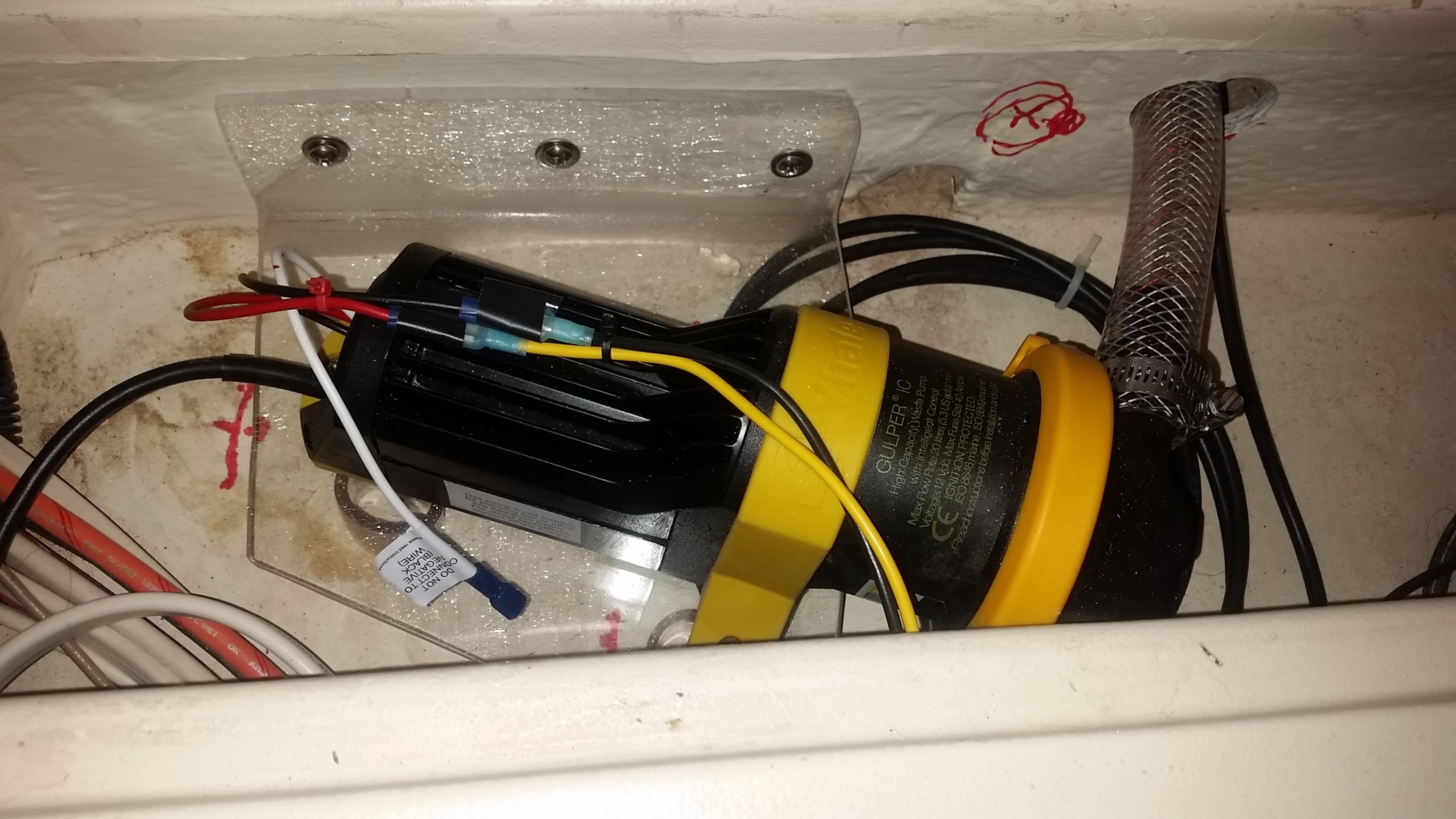

Then I ran 1 inch ID smooth wall reinforced hose to my chosen location for the pump, which was under the main floor, under a screwed down section adjacent to the upper bilge. I bent up a piece of plexiglass for mounting the pump and lag screwed into the stringer, also cut a piece of hose to stand vertically under the plexi to take some weight off the screws and provide a little shock absorber action. View looking inboard

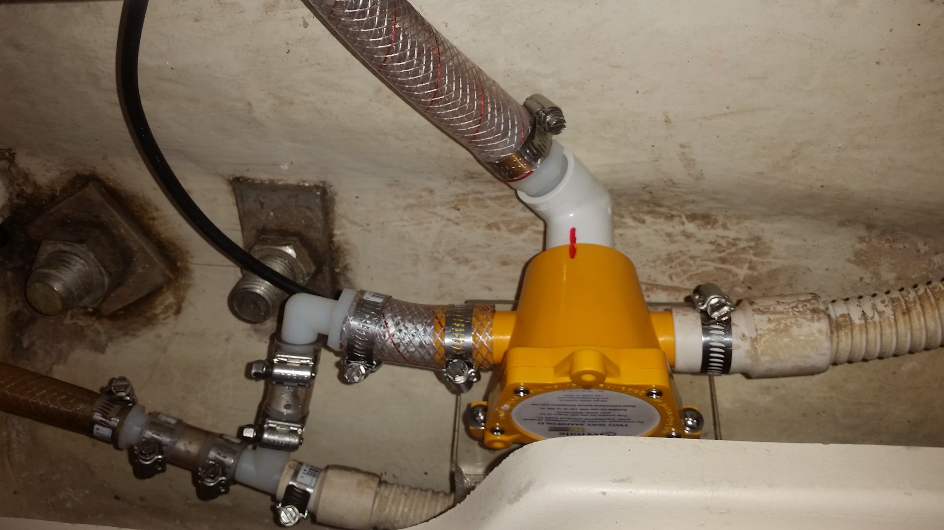

I spent some time at Home Depot's plumbing dept selecting a bunch of adapters and a tee to get the refrigerator drain and AC drain tied together and then to the forward side of the manifold. The manifold has 1 inch hose connections (smooth, not barbed for some reason) so the shower drain went directly on the aft side. To get the manifold as deep as possible, I used 5200 to glue a PVC elbow on the bottom of the manifold, angled to line up with the hose to the pump. Again, I bent up a piece of plexiglass to mount the manifold, the lag screwed into the stringer under the galley drawers. Sorry, picture comes in upside down no matter what I do... View is looking to port, toward the stringer under the galley counter.

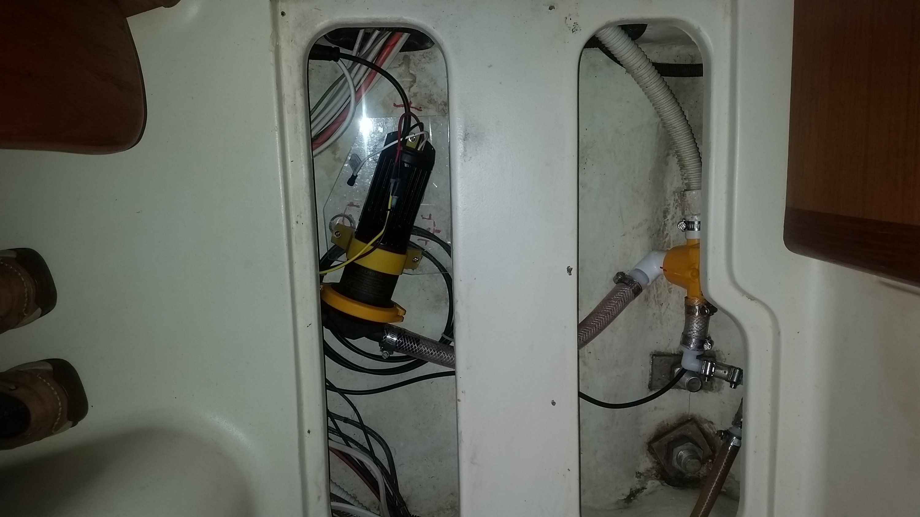

I don't have an autopilot, so I used that breaker for the power to the pump. The manifold has an electronic sensor to detect water, and turns the pump on automatically whenever water is detected. Here's an overview of the Whale system installed
