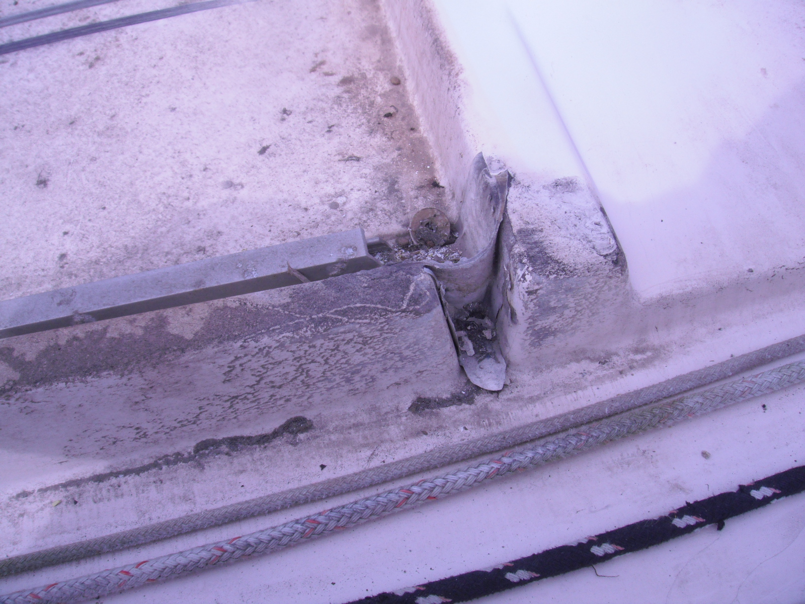

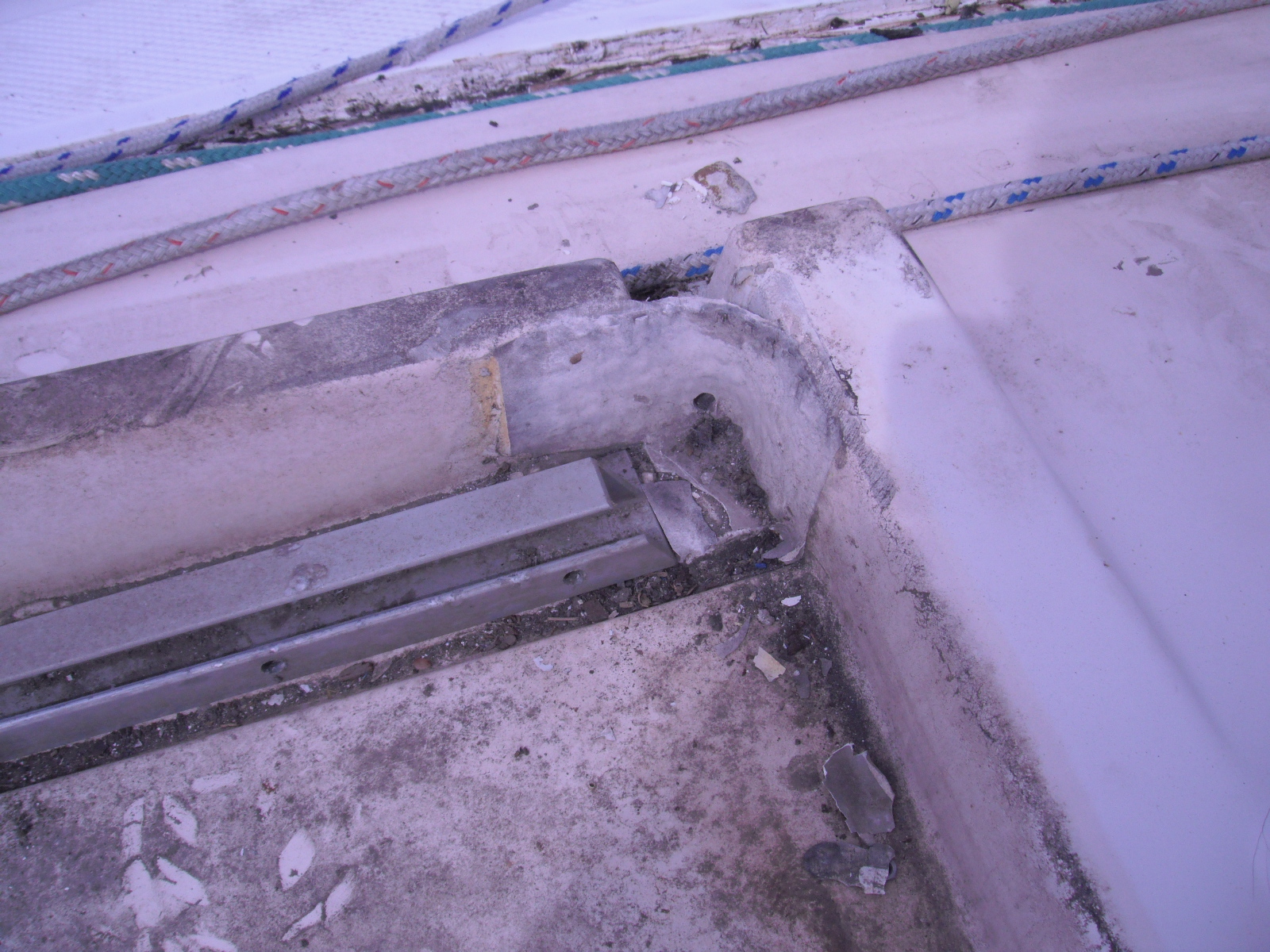

+1 on Mark.. additionally, there are drain channels (port & starboard) at the front end of the slider pocket that can become plugged with debris.. On my boat, I found the drains glassed over from the factory; They'd never been opened! I carefully bedded my traveler bolts but I don't think they leak..as Mark notes, they are threaded into the embedded plate. These shots from this site.. His boat had the same problem as mine, the drain channel was blocked at the front where it should channel water to the tunnels where the lines run and then down to the deck..

Thanks to both of you for your responses. I checked the aft end of the channels and they were both open. I got water dripping when I shot water at some pressure onto the companion way cover which probably splashed over. I've rarely gotten water onto the sink from above, but we've had some incredible storms. i'll take out each traveler screw one at a time, put some sealant into the hole and then reinstall each screw. That should seal up any future issues. I'm still looking for the leak that is coming down inside the cabin along the front of the dish and cup holder and then into the ice chest.
