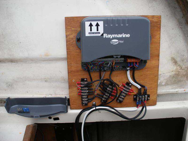

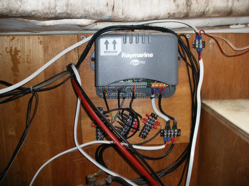

I used two battery swtiches on my last boat, a 27 footer powered by a rope-start outboard with a field alternator. Switch #1 was in the cockpit locker and directed which of the two house batteries the engine charged when running. Switch #2 was incorporated into the electric panel I made and determined which house battery powered up everything. See pix.
