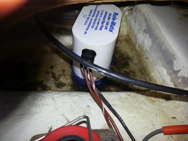

I have this little Rule pump with integral float switch. It has worked fine for quite some time. I also installed a switch above the slider to choose between automatic mode and manual.

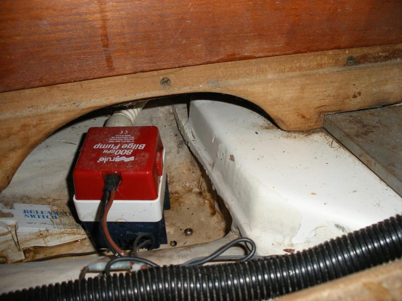

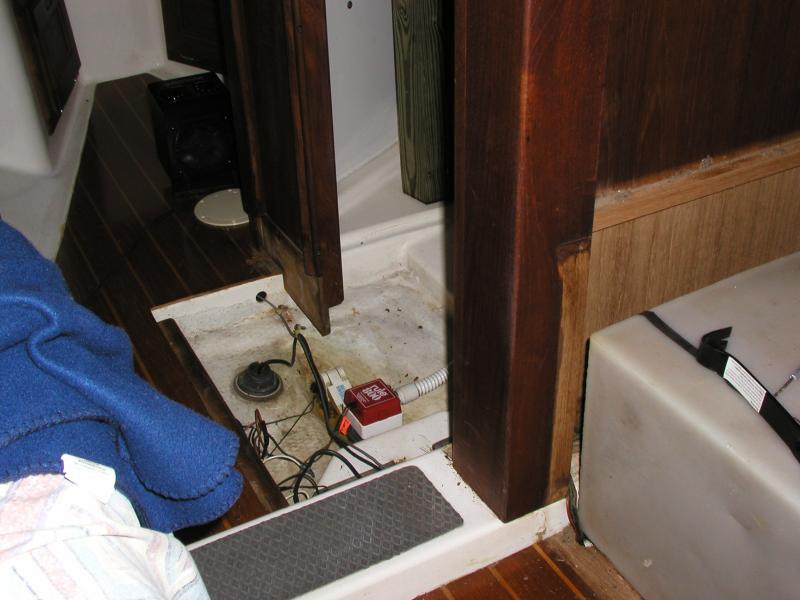

I have a small Rule 800 GPH bilge pump (that appears to be a replacement for whatever may have been there) that is connected thru a float switch in the shower sump to the power feed to the freshwater pump. It pumps out on the starboard side near the holding tank vent. See pix below...

Hey, Bub.. I have the same one as Dan.. It was original to the boat; we don't use it much.. No check valve in the line so a good bit of water comes back when the pump shuts down. I had one problem with it years ago.. There was a bad/corroded connection for that pump in the bilge.. pump would run but not make enough pressure to push to the outlet .. Fixed connection and all has been well
Pump is a little Rule 800 on a float switch. I found it interesting that the factory has it connected to the pressure water circuit.. it will not run unless the water pressure circuit is on.
