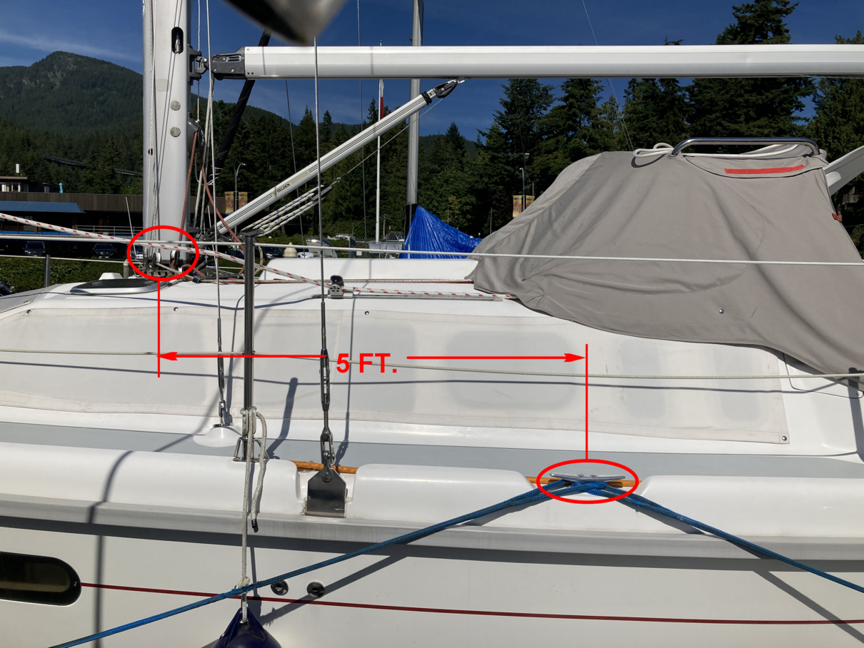

Curious about mine and took a picture today. 5 ft. aft of the mast and nicely pulls in parallel to the dock.
The engine and fuel tank play heavily into the location of the mid ship cleat.
The only way to locate the best position for the cleat is to experiment with different locations by temporarily positioning a line in different locations. Every make of boat is different.
