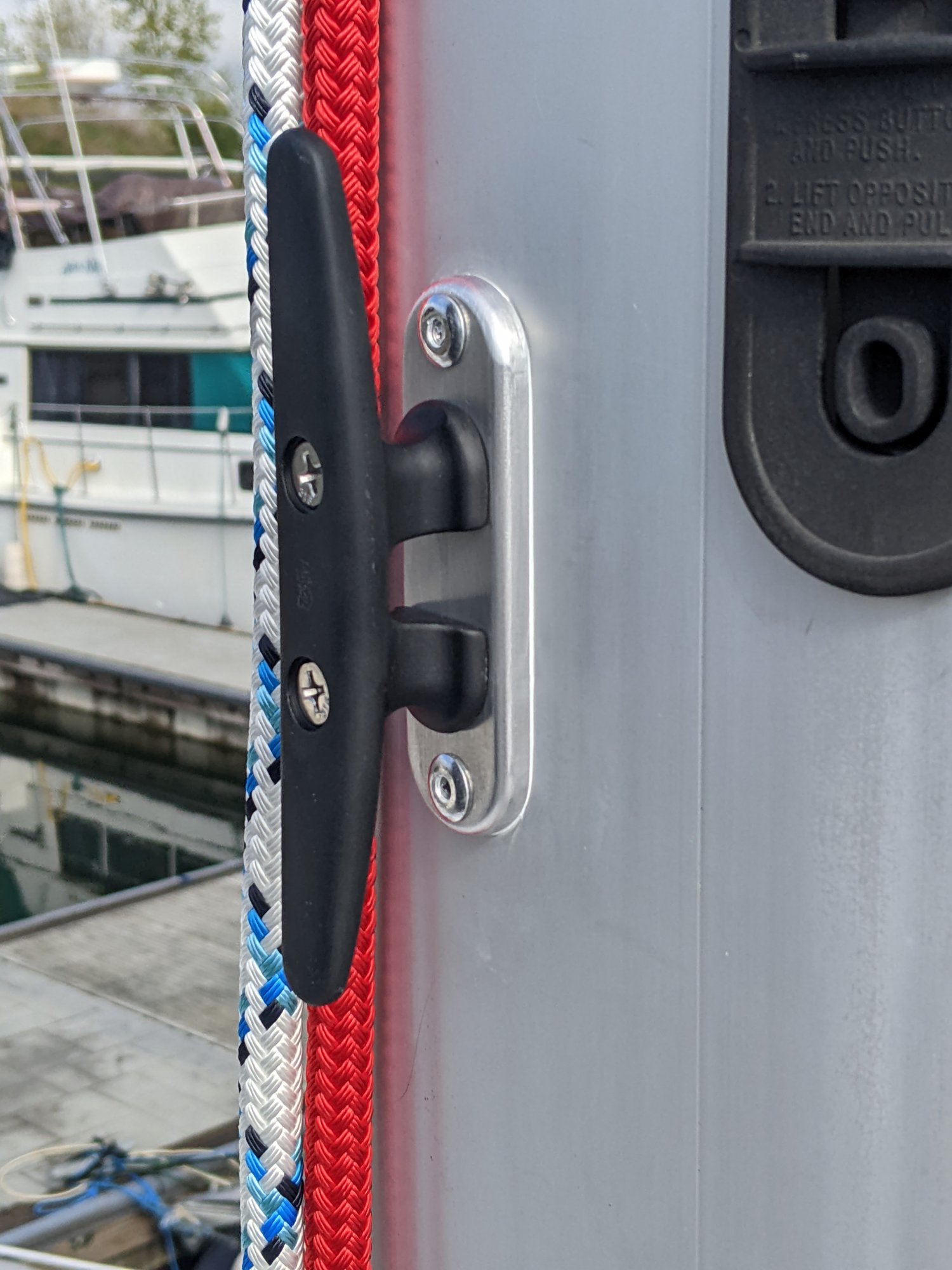

That depends a lot on what skills you have and what tools and materials you have access to. I wanted to put cleats on the mast but I was concerned about the thickness of the mast and its ability to hold a cleat using threaded fasteners. The one cleat that was already on my mast was attached using very long blind rivets but the cleats that I was able to purchase weren't compatible with that strategy and the very long blind rivets are difficult to source.
I recently installed two cleats on my mast so I could cleat off the main halyard (furling main) at the mast and run the topping lift to the cockpit in its place. I did the same for the jib halyard since it furls, too. The attached photo shows the 1/4" thick aluminum backing plate that I made. It is attached to the mast by 1/4" aluminum blind rivets and is drilled/tapped for mounting the cleat.
