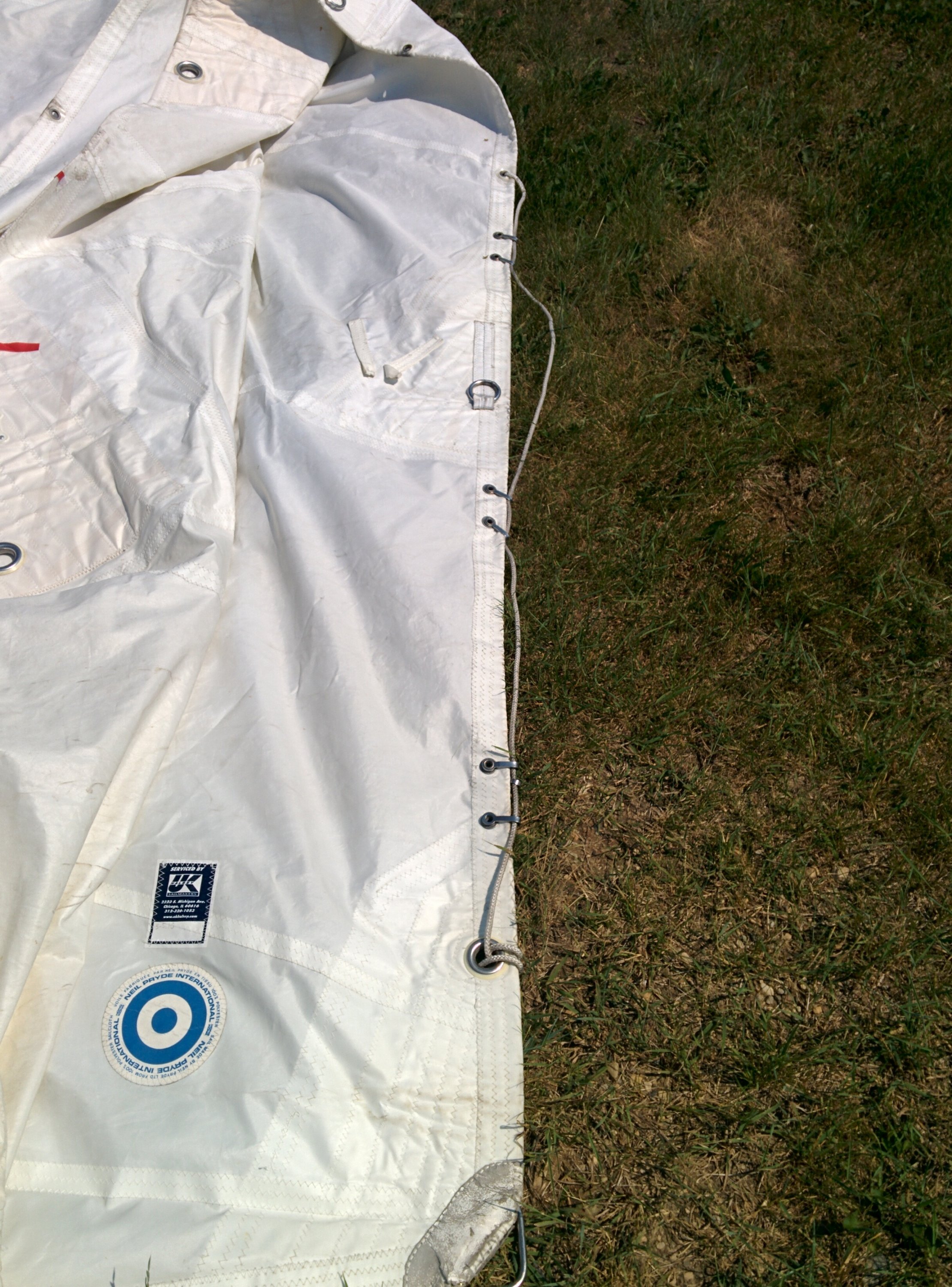

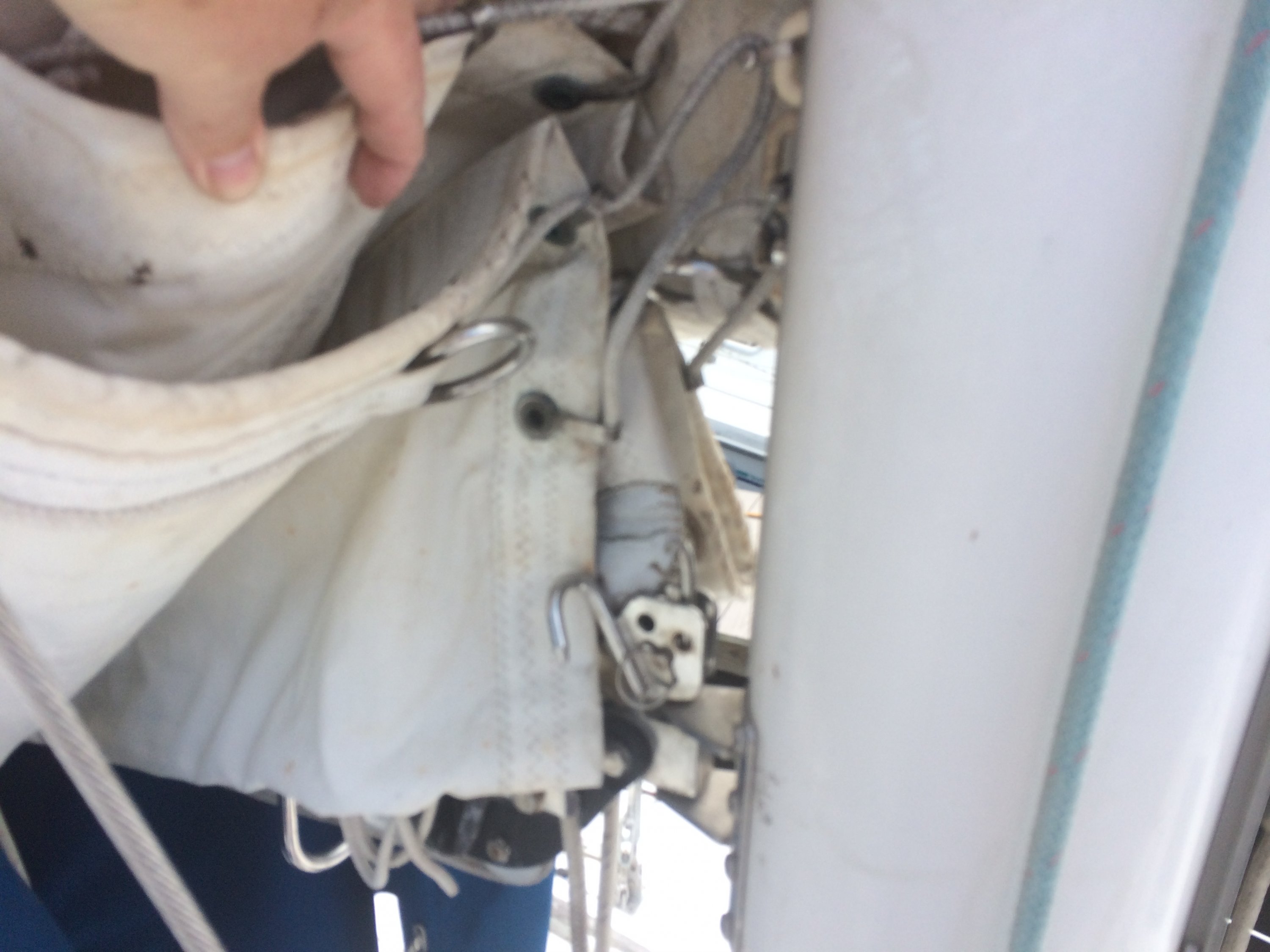

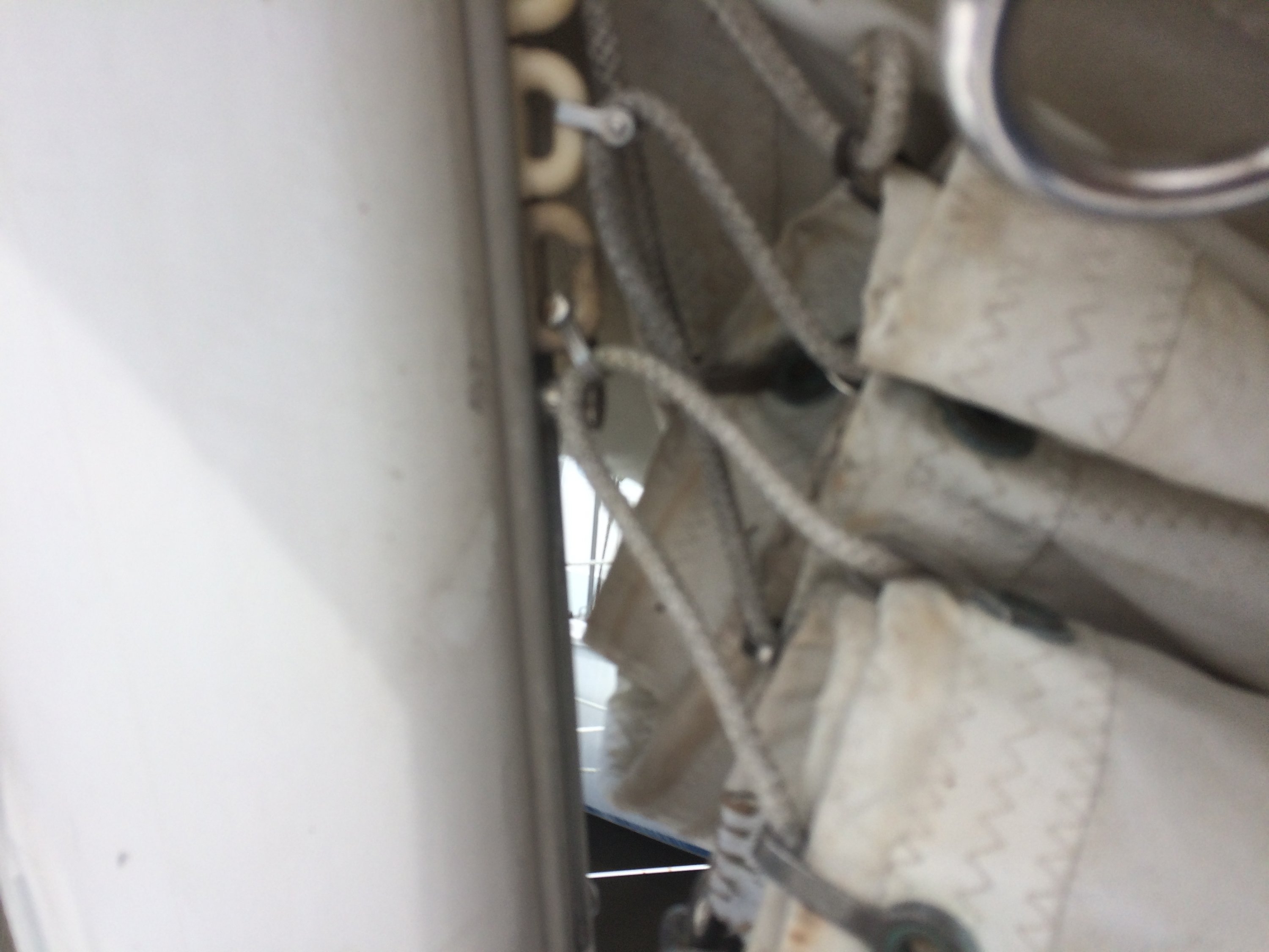

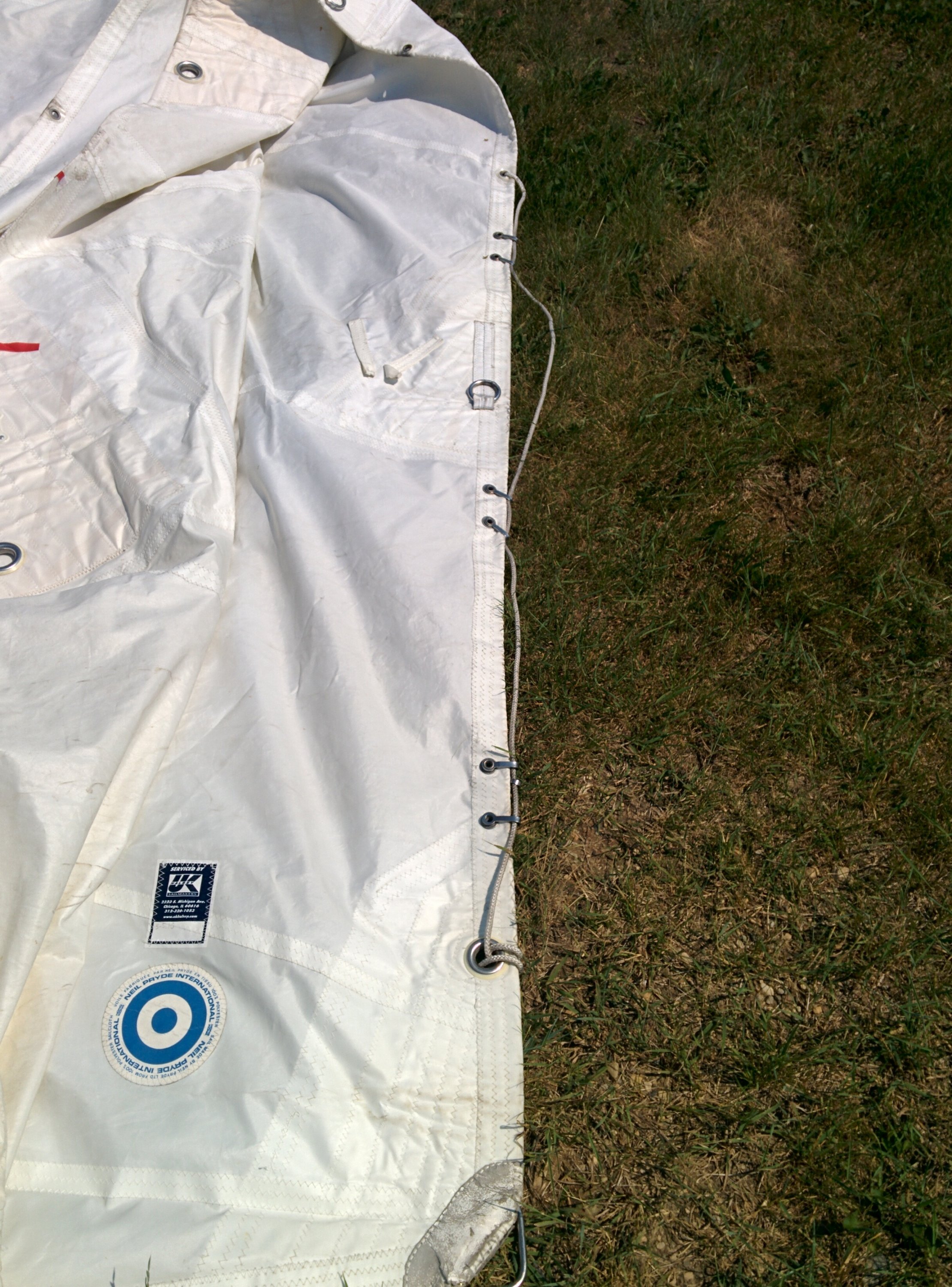

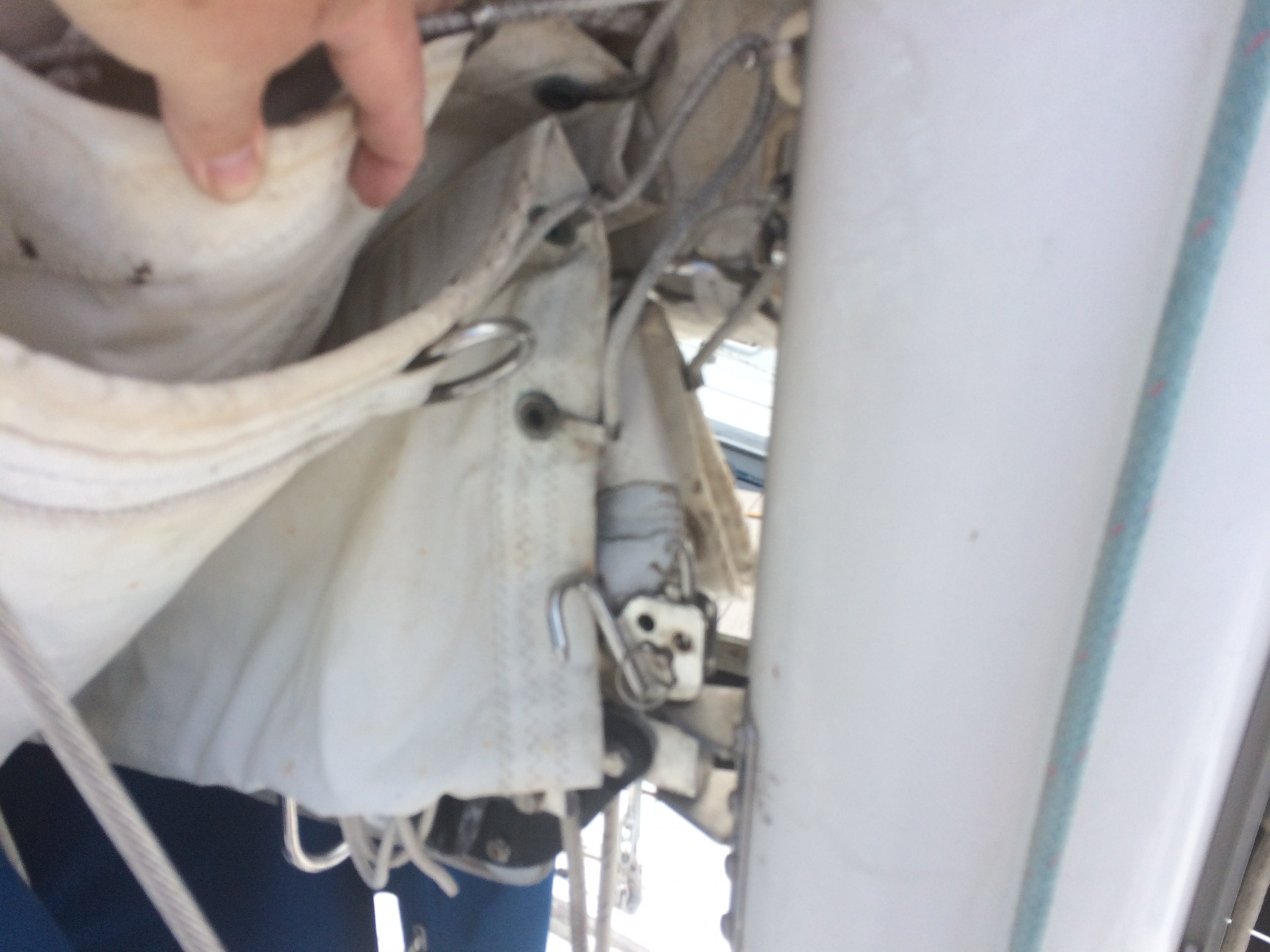

Here are a couple more shots of the jackline .. couldn't hoist the main because of too much wind.. This was the original rig, I think. You can see the bails on the main and the screwed ones on the slides.
In the picture with my fingers in it, you can see the top of the jackline just below the reef ring. It is sewn/spliced into the bolt rope.
View attachment 138592 View attachment 138593
Thanks Claude, that helps!

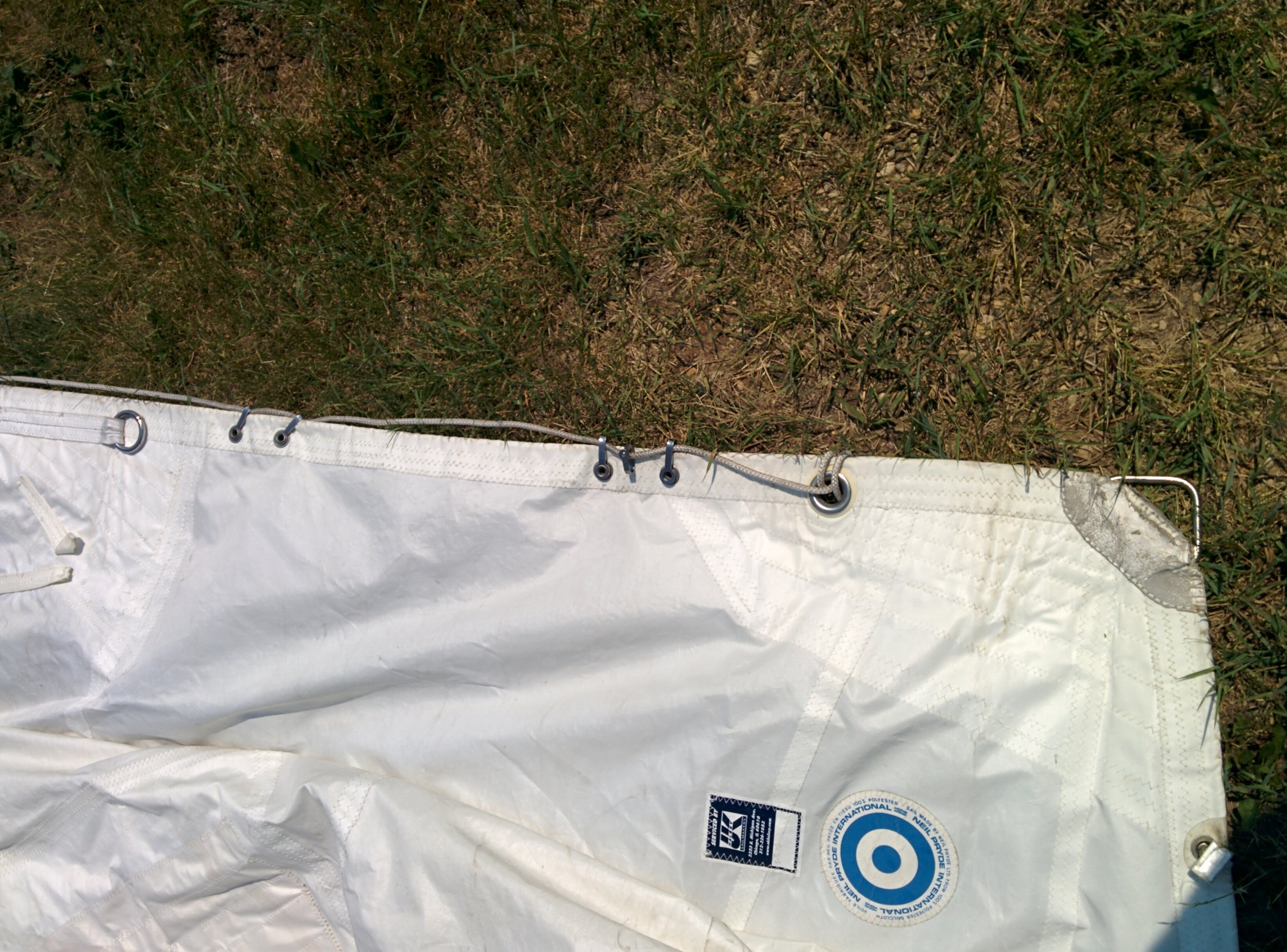

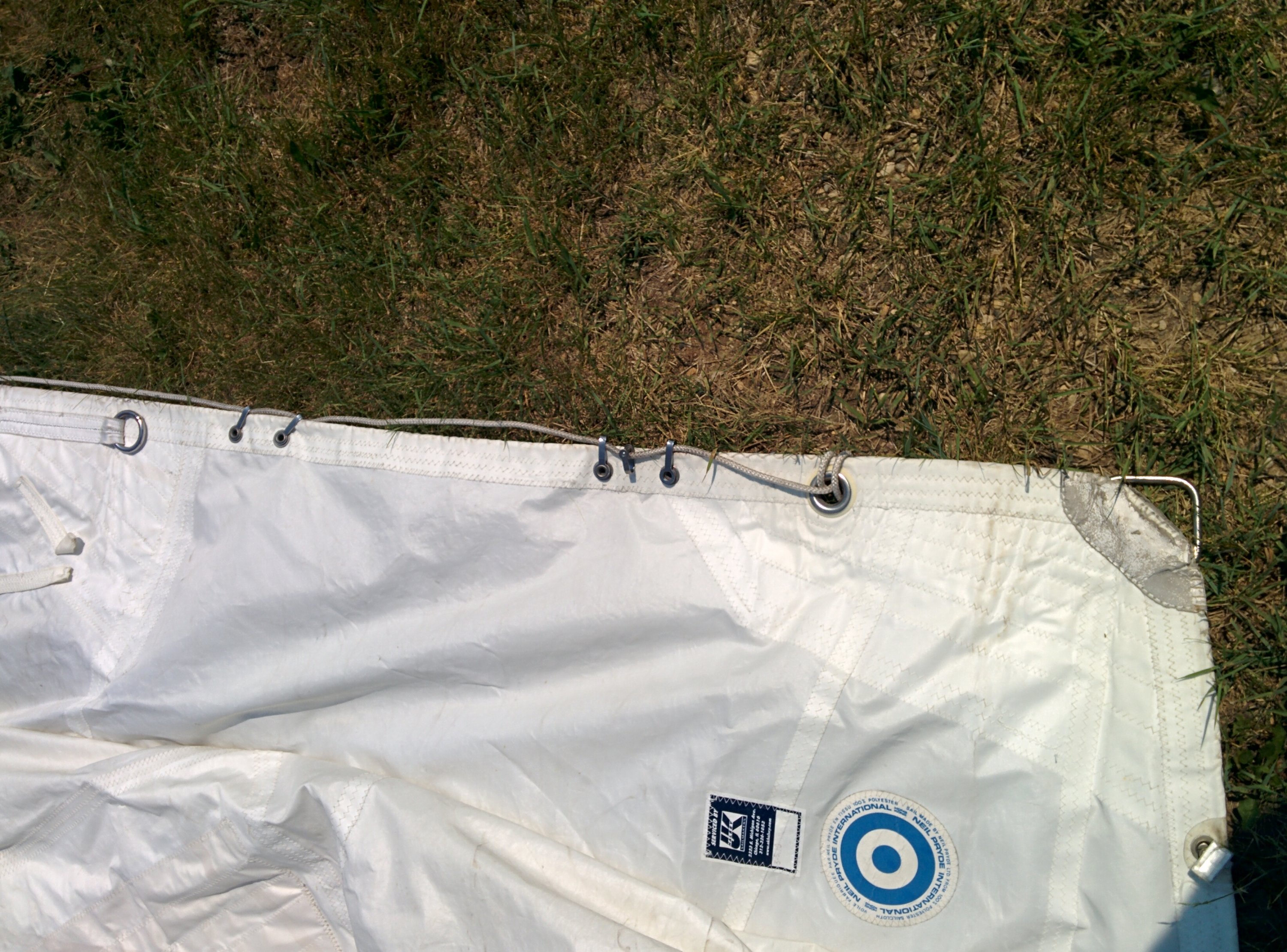

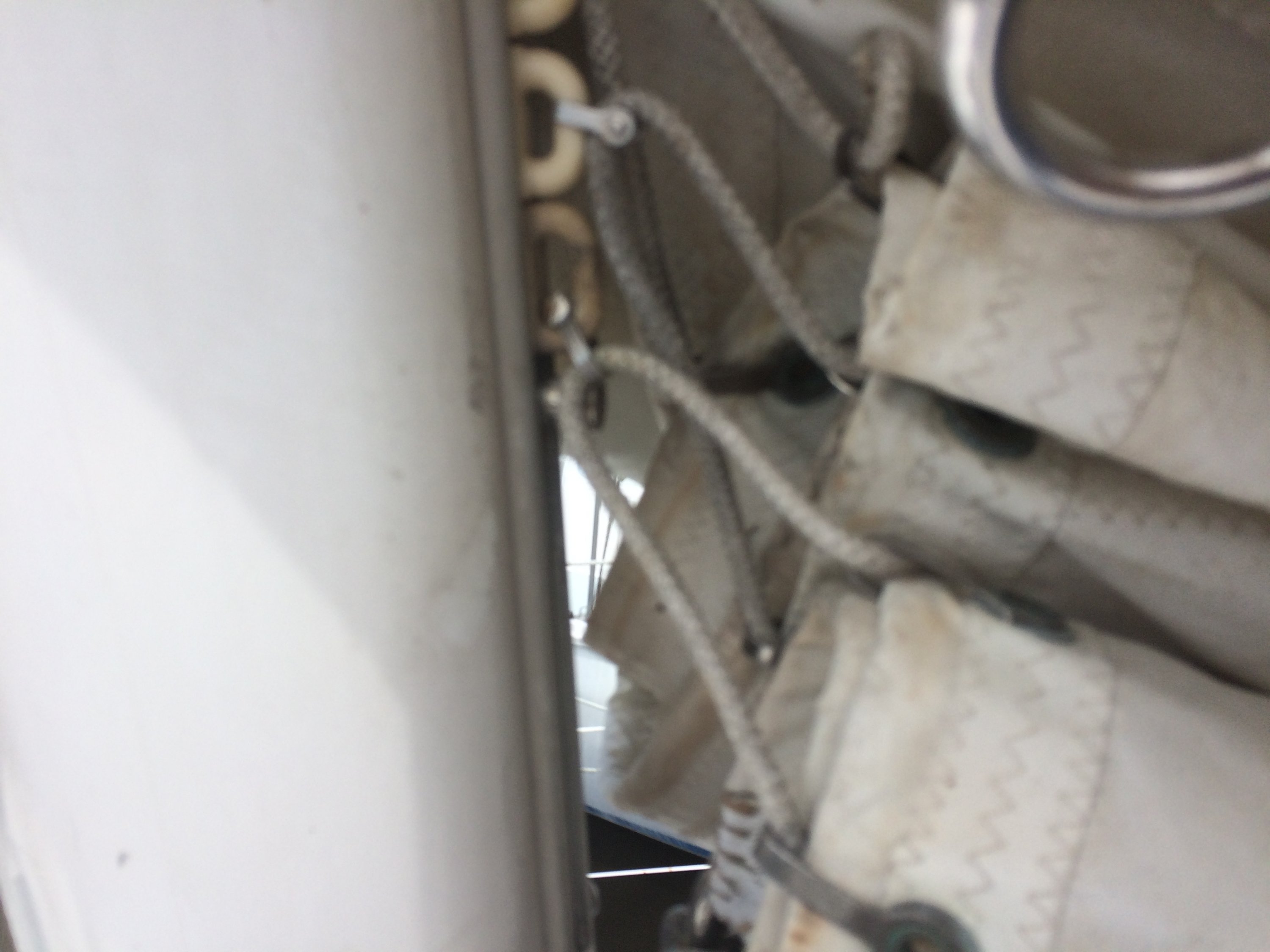

Here's another couple of pictures of my old main sail jack lines. I removed the slugs for my mast mate. The po had the slugs between the gromets so not alot of movement. h-34 mainsail.jpg H-34 mainsail reefing.jpg
Likes: kloudie1
pateco
Aug 12, 2014
2,207
My main sail has jack lines below the reef points as well.
