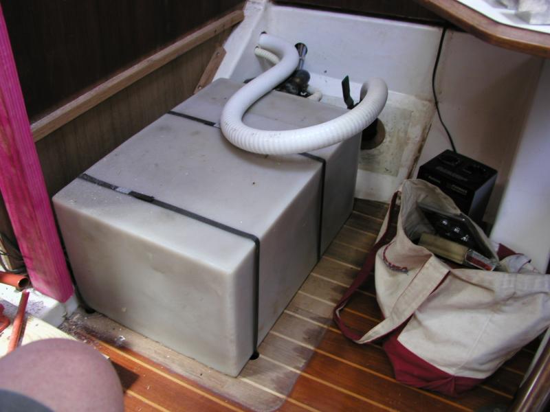

Anyone have a vendor and a part number to replace an original 1983 H34 holding tank. Here is an older pic from 07 when I purchased it. I have cleaned this up and installed new hoses etc. my issue is last year when I replaced the clamps and hoses for the second time since I owned the boat the bottom connection hose has a slow drip. Last year I could not identify the issue if it is a crack in the tank or if there is a hole in the hose after installed? If it is the tank I would like to keep the same positions for the connections.

Jim: Check out Ronco Plastics in So. Cal. They have over 400 different tanks available. They will custom fit the fittings to your spec. Their prices are reasonable. There is also a tank mfg back in your part of country which could save you some freight. Not sure of the name but someone will pipe in.
10,118
H 34 Holding Tank
Interesting, Jim.. The tank in mine has simple connections on the top of one side. I think this tank would work with your hoses, though you might have to use an ell in the input line. ??

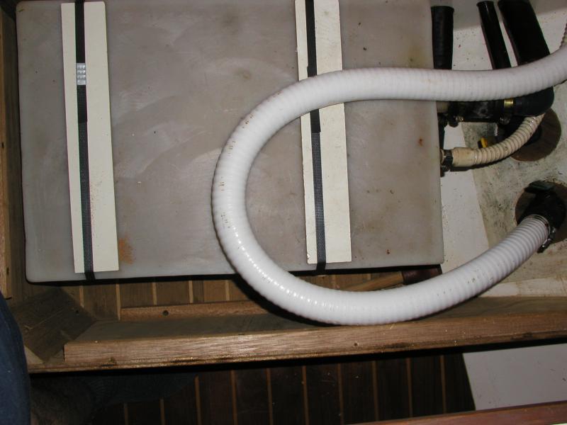

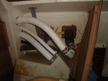

Jim the 1 1/2" hose that is connected to the holding tank is of a wrong type. This hose is used for bilge pumps. See Cloud's image - this is the correct type. I just finished a holding tank project and I found that not all 1 1/2" hoses have the same internal dimension. Use heat gun to soften them then tighten the calms. In some cases since the hose did not fit snugly I used plumber's tape to make them fit better then tightened the clamps. To pin point the source of the leak place a paper towel below the leak . Then wipe with your hand to feel the origin of the leak. It is more likely that the hose is not the right size.

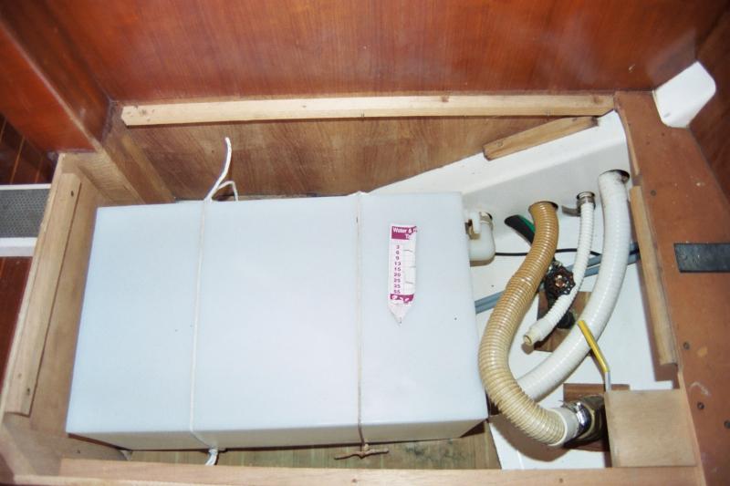

When I purchased my H34, it had a brand new, uninstalled Todd 15 gallon holding tank to be installed. This tank, though a bit small, fits perfectly under the forward dinette seat with some room to spare on the long sides and at the starboard end for hose connections. Overboard discharge was removed when this tank was installed.
All hoses were replaced at installtion with the top-of-the-line sanitary hoses. It was a bear to get the new big hoses over the hose barbs. Had to heat with a hair dryer and apply some dish soap inside the hose ends. No leaks!
Pix below:
