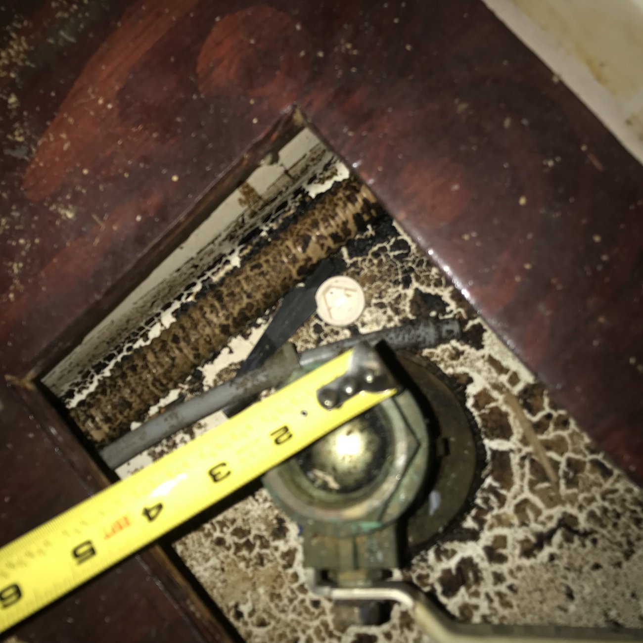

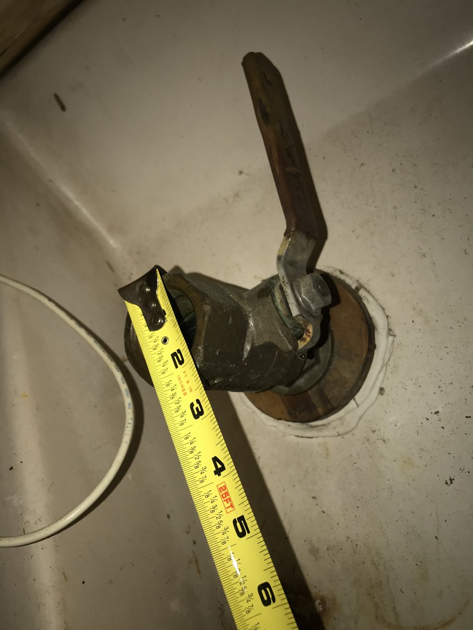

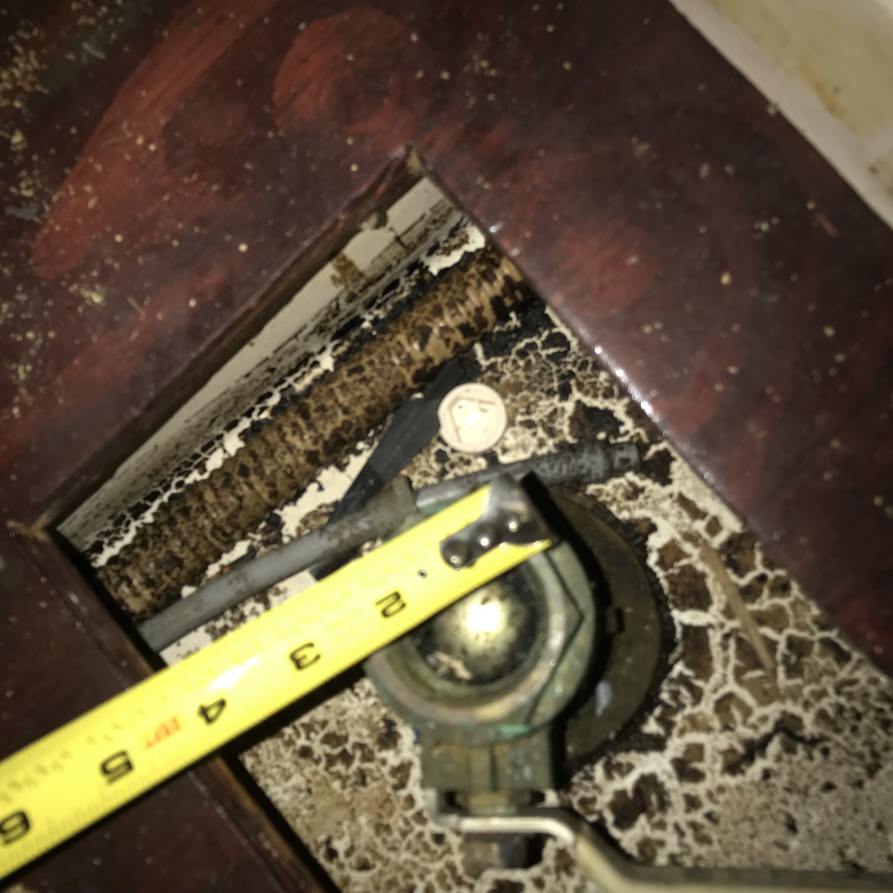

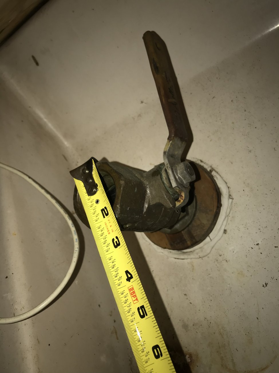

I just replaced the galley fitting on my '85 34. The inner diameter of the thru-hull, measured underneath the boat, was 1 1/2 inches. I bought a new thru-hull and valve together and they worked. For me the trick was using a ruler to measure the inner diameter of the thru-hulls in a marine supply store and working up. I find nominal pipe sizes useless. Manufacturers and spec writers can't distinguish between inner and outer diameters consistently.
