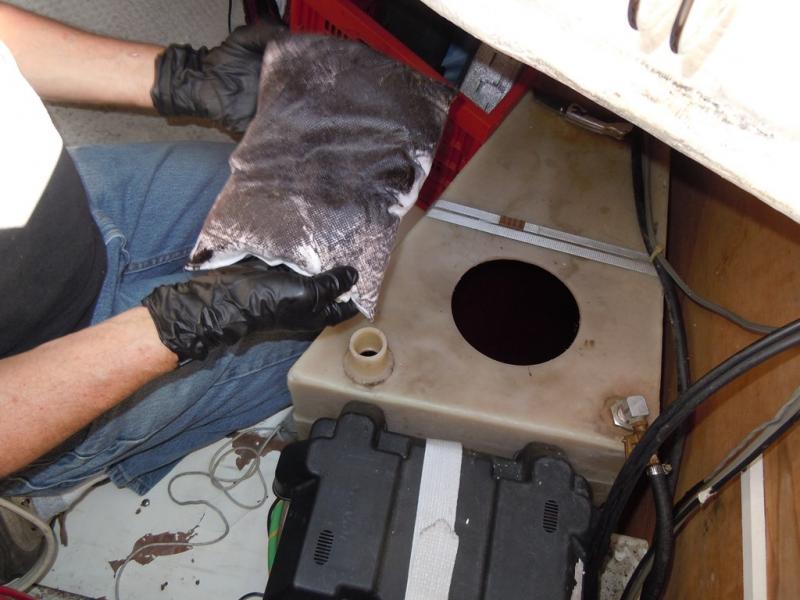

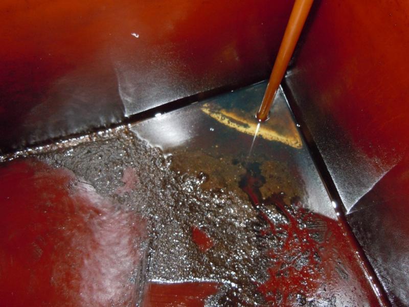

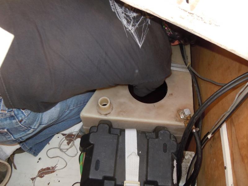

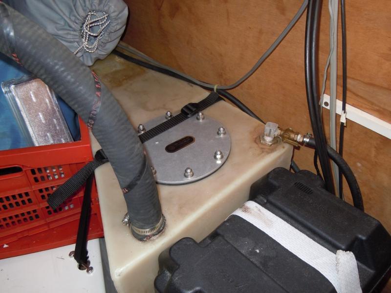

Splax,
Your question prompted me to write up a posting for installing the fuel tank inspection port. I just completed that project 3 weeks ago out of necessity. Once approved you will see the posting on the Boat Info >> Hunter Owner Modifications >> Hunter 34 section. I hope it is helpful.
Like Tom in Annapolis and Dan Johnson before me, this was a pretty easy installation. I believe much easier than trying to get that tank out of the boat as considerable disassembly would be required to pass the tank through the rear berth area and out the companionway. Then you still have the problem...how to adequately clean the tank through the little holes? Once that big hole is cut, you will be able to completely mop down the inside of the tank and feel assured that it is clean. We have disposal cans for saturated absorbent pads.
I actually reused my 7 gallons of cloudy fuel that I pumped from the tank. First I poured it from one Gerry can to another through a West Marine Fuel Filter funnel. Then I plugged the little end of a Racor filter element and poured the fuel through that (via a regular funnel. The fuel was very clear again, so I added biocide and Cetane booster and put it back into the tank. I figure I'll run it down to nearly empty before refilling the tank. Even with this treatment the engine is starting immediately again as opposed to the recent extended cranking to get it going.
So in your case, run it down to nearly dry, then stick a flashlight in the hole and see what's on the bottom. If you can see through your fuel and there is nearly nothing, leave it be. If it looks like a lot of gunk, the easy path is to install the inspection plate. I think there is a warning on some of the biocides that if you use too much it will make the fuel cloudy. I didn't have that problem because I never used the biocide. Mine was cloudy because it was full of algae. I'll never do that again.
