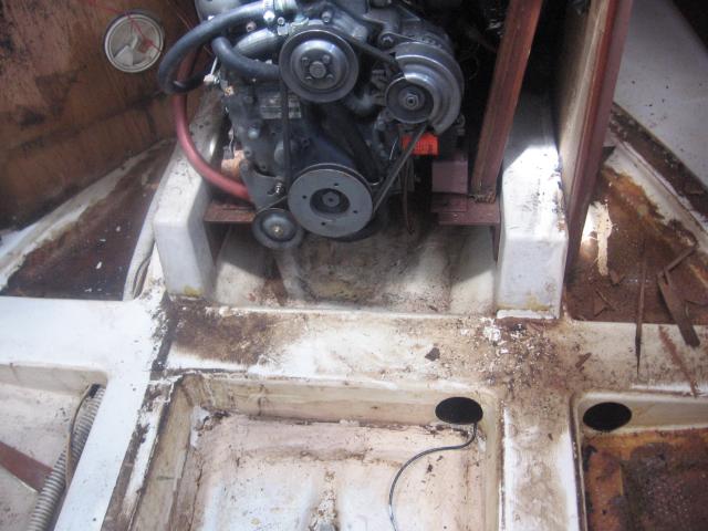

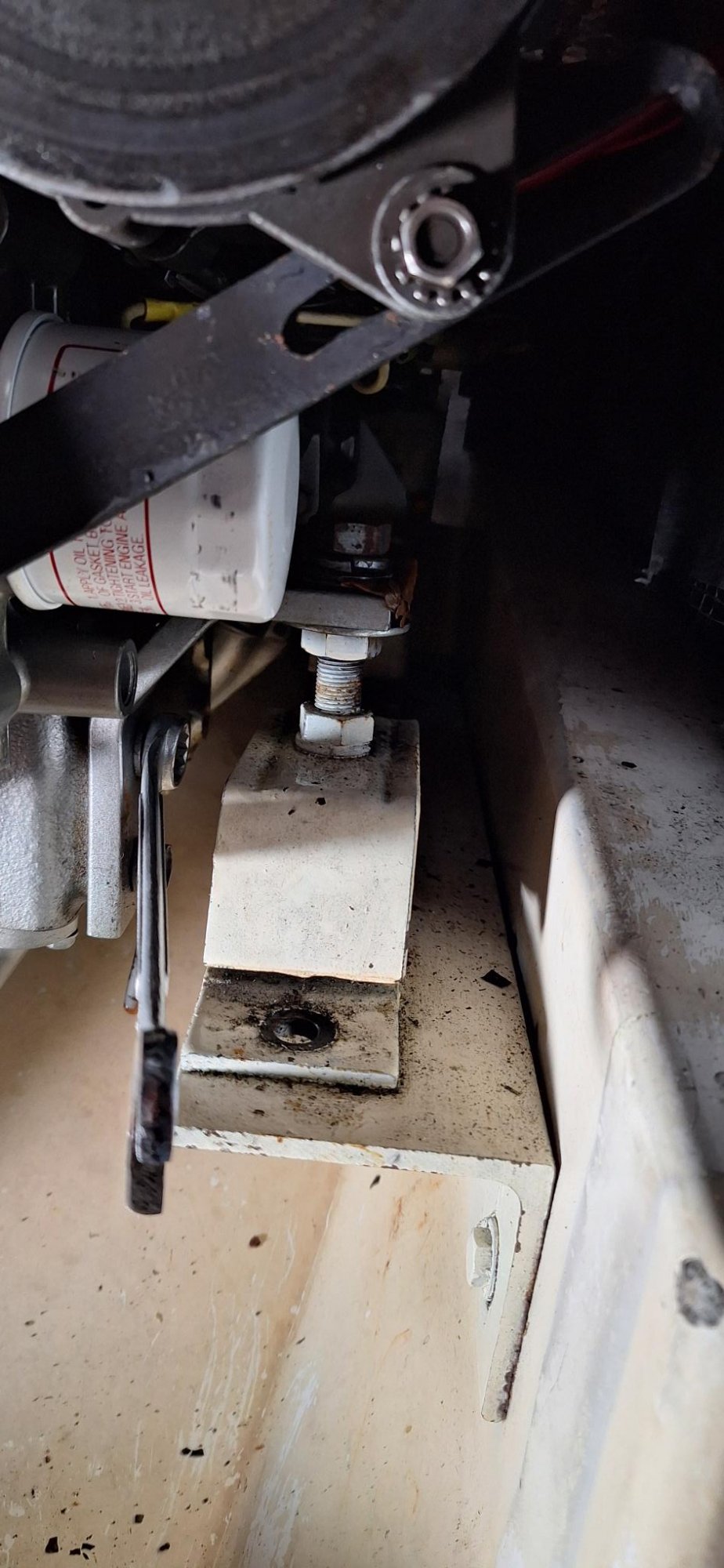

On the H-34, There is an angle iron lag screwed into the grid engine supports. The engine mounts are bolted to the angle iron ; that part is horizontal and the part bolted to the grid is vertical. I think it is plain old mild steel angle iron ... Attached picture .. you can see it on the left side of the picture just left of the raw water pump pulley..

Kloudie is right: they are a 90 degrees piece of angle iron. I replaced the motor mounts last year. To me they looked to be a bit more than 1/4 inch thick and 3`X 3`. The vertical part is indeed lag screwed into the grid, but such that there is a front to back angle on the horizontal part which gives the engine its main angle to line up with the shaft, with the final alignment being done with the motor mounts.
There is also a slot on the motor mounts which allows left to right engine alignment.

In a perfect world, the engine would be of a size that the motor mounts would stand on the stringers. That is not the case with this boat and engine combination. This the angle bars to tie the stringers together to provide a way to mount the engine and harness the power to the hull.
Your replacement build should follow the original design. Angling the bar makes sense as it will mean there is less need to induce that angle with the motor mounts.
Lag the bar securely into the stringers as the thrust of the engine will be on the way the bar is attached to the stringers.

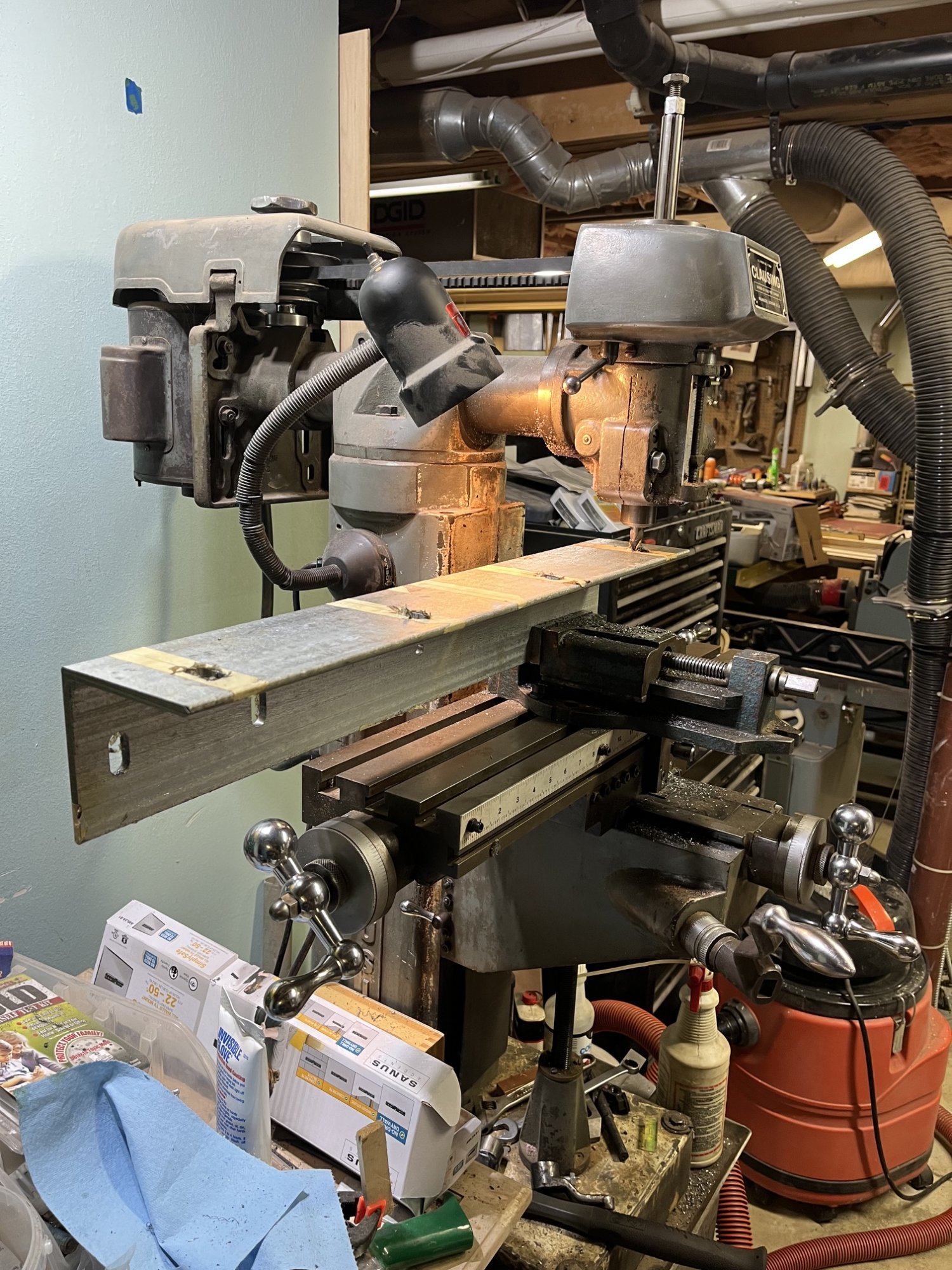

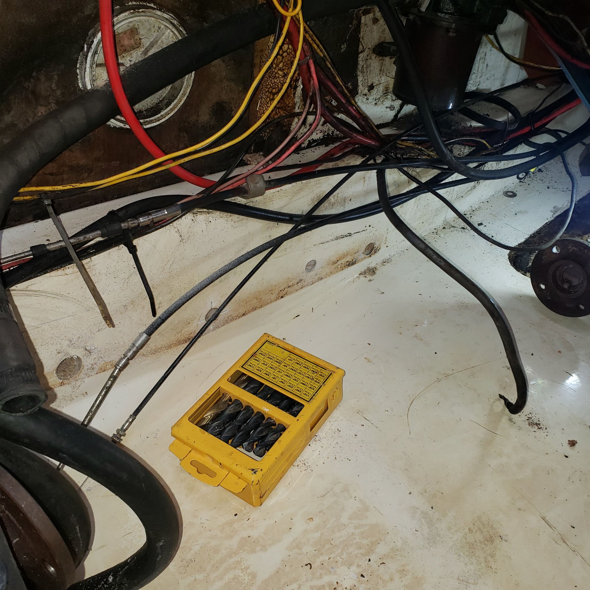

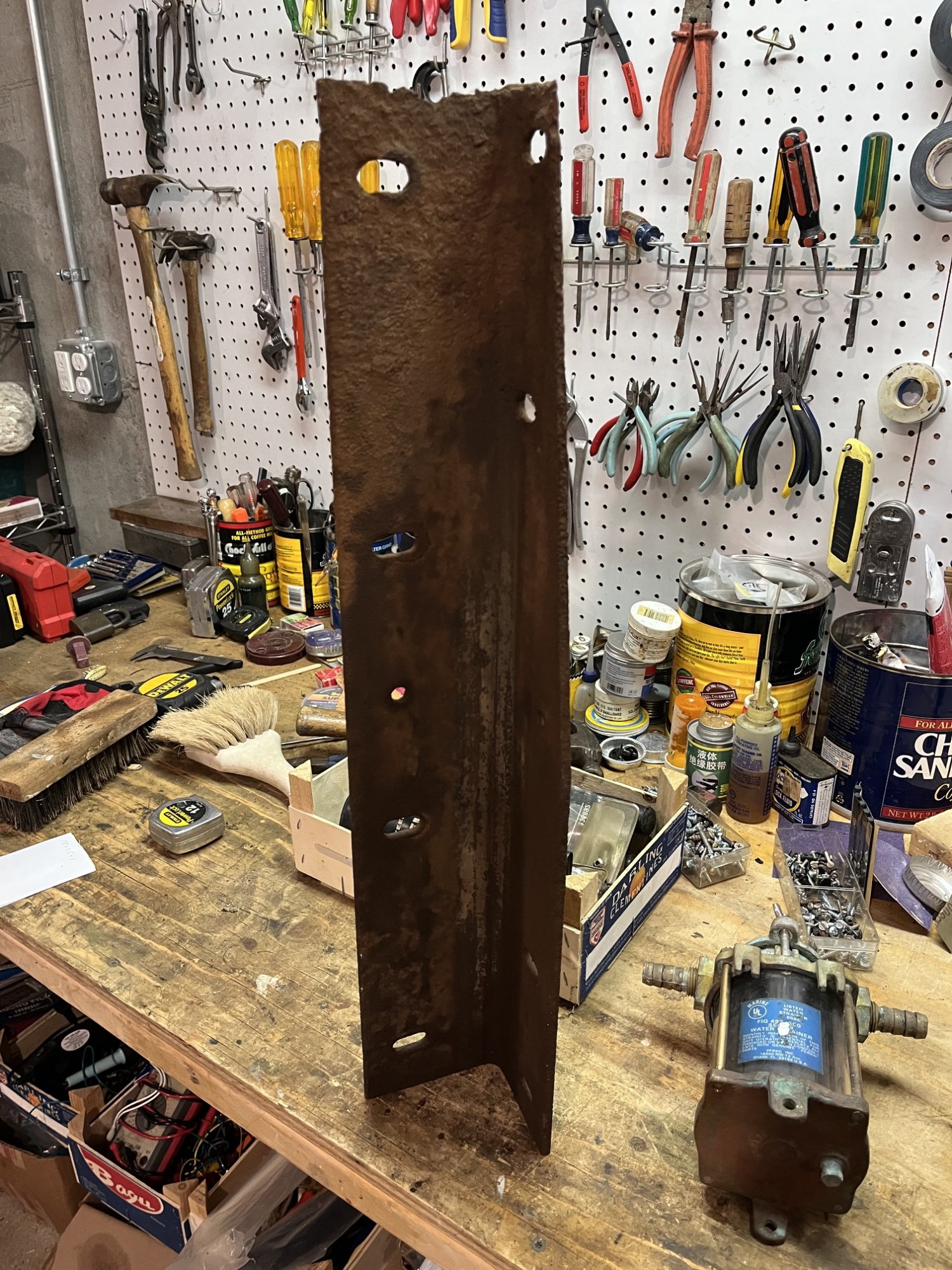

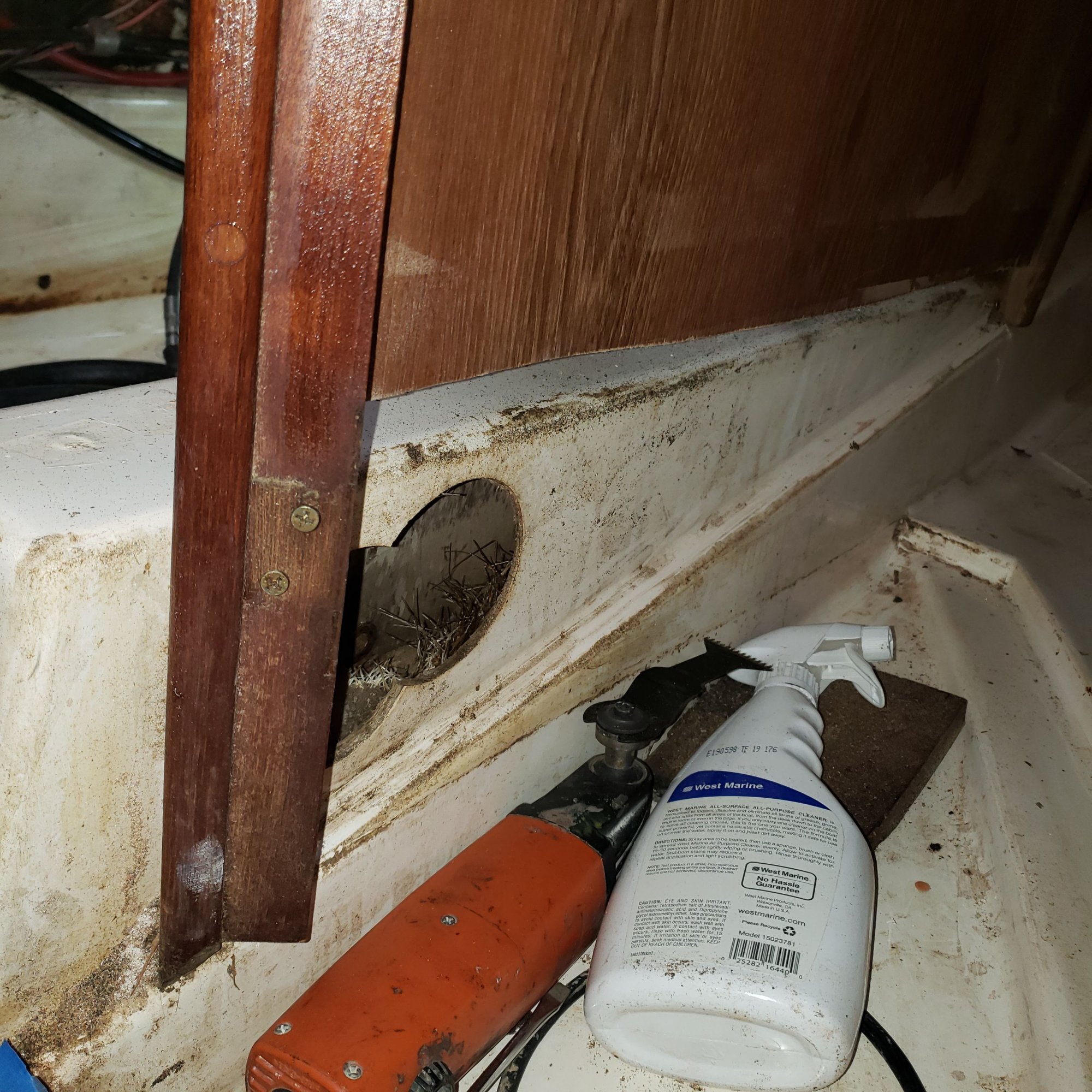

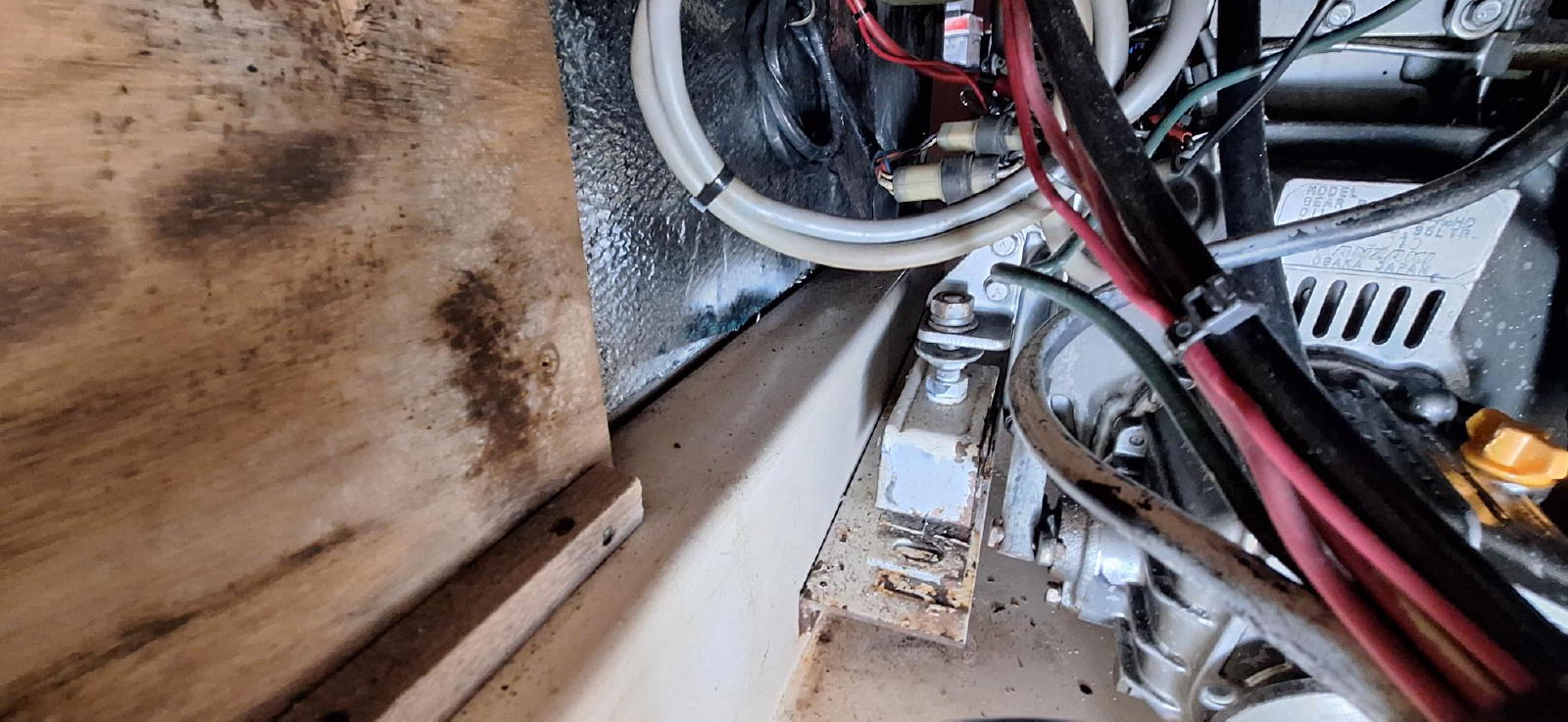

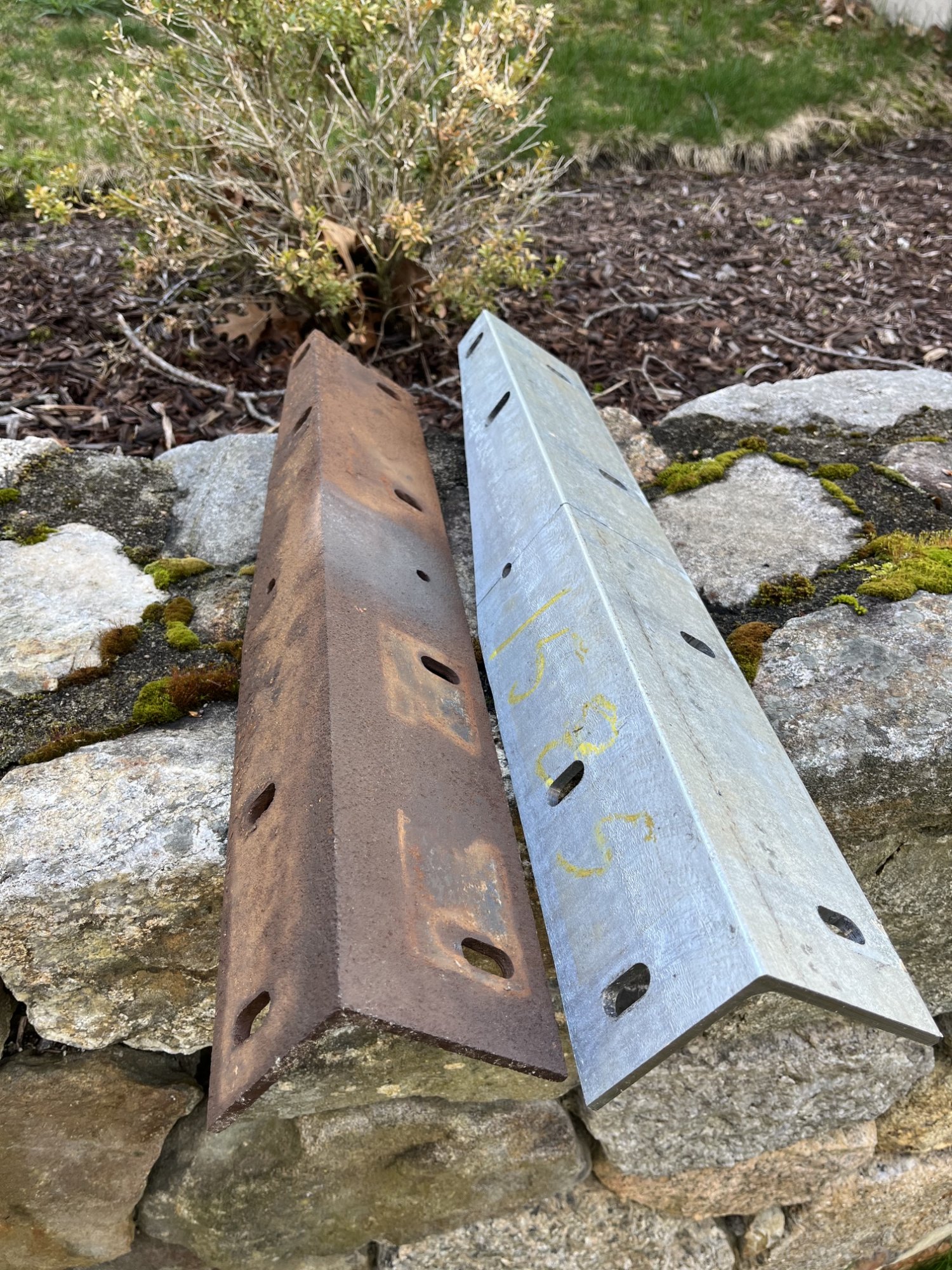

I removed the starboard stringer last fall and milled a new stringer. The original stringer is raw angle iron 4x3.5x24x0.25. The aft end was very thin, the aft starboard engine mount was a bit separated from the rubber blocks, and the forward engine mount wasn't in great shape from occasional diesel drippings. I replaced it using a piece of galvanized 4x4x24x0.25 angle iron cutting the one edge to 3.5 using an angle grinder. I used a friends' milling machine to cut the eight 1"x0.5" slots. Then sealed all of the exposed edges with rust lock primer and enamel paint. I did move the engine mount holes 1/8 inch as the bolts were on the edge of the slots. Total cost was under 70.

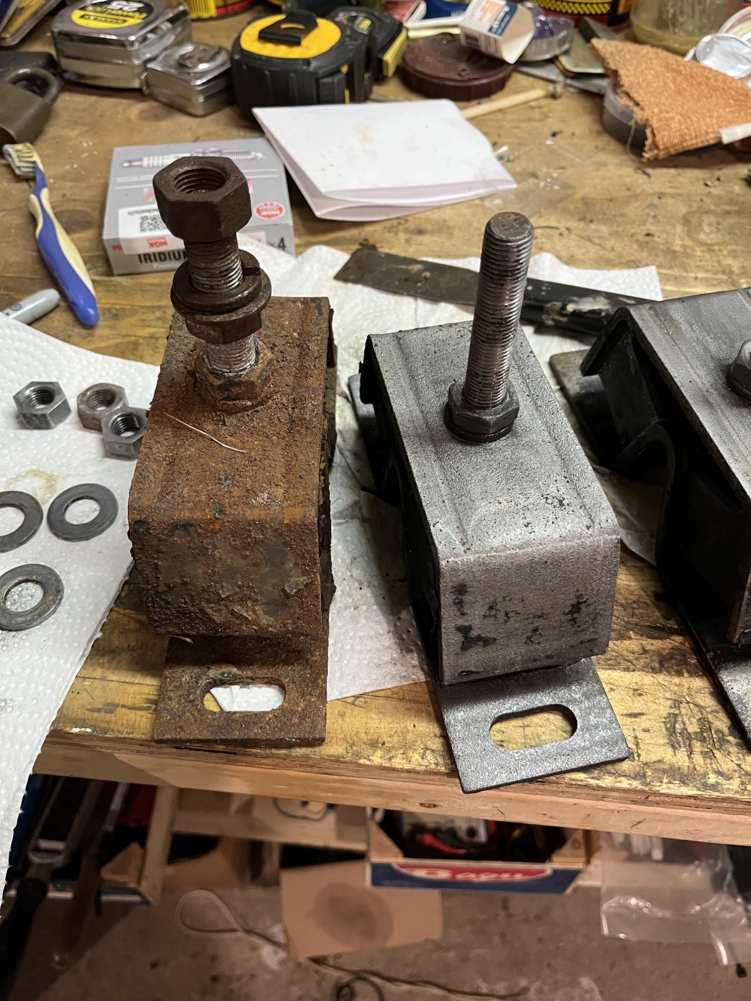

While I was at it, I took a few old engine mounts that weren't in bad shape and cleaned them up using a wire brush, an "Evapo-Rust" bath and painting them with rust lock primer and black enamel. It's all installed and aligned. Below are some in process pics. I wish I had taken a final picture. Careful about lifting the engine. I used a total of three safety lines to hold the engine up.
