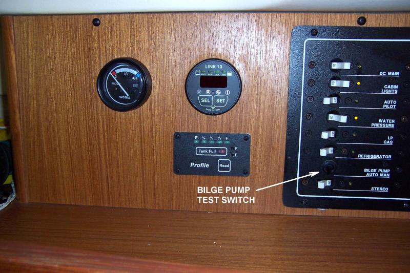

A nice extra is to have a bypass switch (monentary ON) in the circuit so that one can quickly test the wiring to the bilge pump to make sure everything is in working order.

And the answer is yes.:D It is both. Depending on the pump you have, many come with both a brown and a brown with white stripe. I guess those may be the ones with internal float switches which is the case with mine. Either way, power to the float switch comes directly from the battery. On our 34s you would see (if its still there) a brown wire that connects to the common terminal on the back side of the battery selector switch from the engine compartment side. Lift the float switch and the pump comes on even if the battery switch is off. The second wire from the pump or a wire on the other side of the separate float switch (not the same as the one directly to the battery) goes to your DC panel. If you look, and it hasn't been changed, there is a switch (third one up on the left)labeled bilge pump. There is also a fuse (bottom on the right side of the 12 volt portion) labeled automatic bilge pump. The second wire goes to that fuse. Flip the switch and the pump runs even if the float is down. That second wire is back fed with 12v even if the float activates the pump and the manual switch is off allowing the light to come on, so you know what that noise is. Nice.

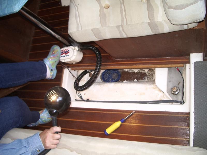

I bought some 3 conductor (14 gauge) tin plated copper wire at West Marine that worked nicely. One brown, one red and one black in a gray sheath. After crimping in the bilge and waterproofing (either use heat shrink connectors with adhesive or liquid electrical tape) I fished through the holes in the upper bilge area to the engine compartment. I carefully stripped away the sheath and connected the red conductor to the battery switch and pulled the other two up into the DC panel. The old wires were just copper and completely corroded. Time for new. While I was at it I ran a second cable to the shower sump and did something similar with an automatic and manual switch installed next to the shower faucet. You can see the two cables in the bottom of the attached picture.

Really like RJ test switch.. beats throwing water into the bilge to test.

My shower sump is the same way. It was wired to the fresh water breaker and meant to be used only for showers when the water had to be on. As above, I installed an auto/manual/off switch. Its only other function besides pumping during a shower is to facilitate cleaning that sump with fresh water after I have pulled/replaced the speedo paddle wheel that is there. After 30 years, I finally got lazy and just leave it out all the time. I just read the speed off my GPS that is mounted at the helm.
