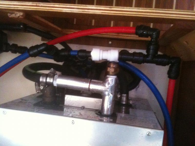

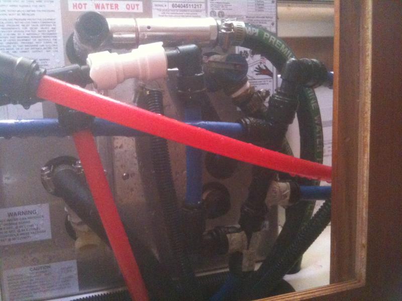

Like Scott B, I bought fittings and did a bypass. The fittings are Seatech 15mm quick connect, available from freshwatersystems.com and other vendors. I bought a stackable elbow (Part # 1118-1515) and a union connector (Part # 1115-1515) and I cut about a 4" piece of tubing.
For tips on Seatech installation, see the video at http://www.youtube.com/watch?v=QOkgT9ozoGA or search youtube for Seatech.
I have some photos that may help if you're interested.
