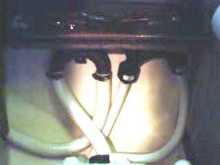

The head can wait. We of the Northern latitudes have to sail first, work second. I've already had to schedule the haul date with the marina, October 28. :( My H37C head used to sit on a shiny f/g shelf, part of the inner liner. My new head, a Raritan Cricket, had a different bolt pattern. I mixed up a little West System to a peanut butter consistency to fill the old holes. Then I cut a piece of oak, shaped the back edge to fit the curve and slant of the hull, and stained/varnished it to match the teak bulkheads. This became the new mounting for the Cricket. Drilled holes through the oak and the f/g shelf and used 1/2" longer lag screws. And yes, add that vented-loop as seen in my picture. About $20. plus some hose.
