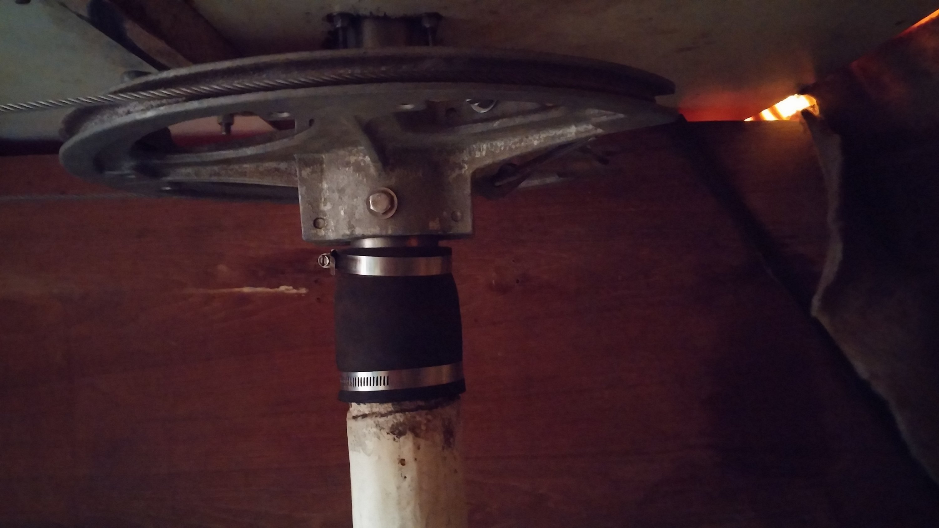

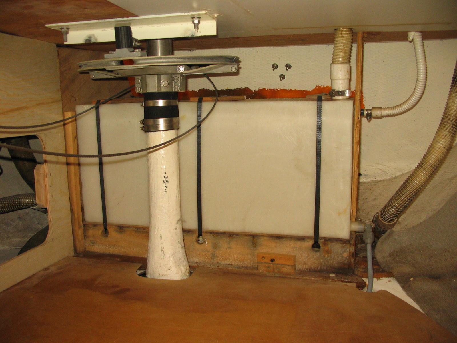

I have a 1983 H31. I would like better access to all that area and equipment below the stbd. lazerette. Right now, I would have to drop through the rectangular hole in the laz, and am concerned about getting back out, due to the depth of that area, and lack of footholds, etc. I am considering enlarging the hole in the laz, at the cost of a few inches of mostly unusable "tray" type storage, to make ingress easier, but egress is still what worries me.

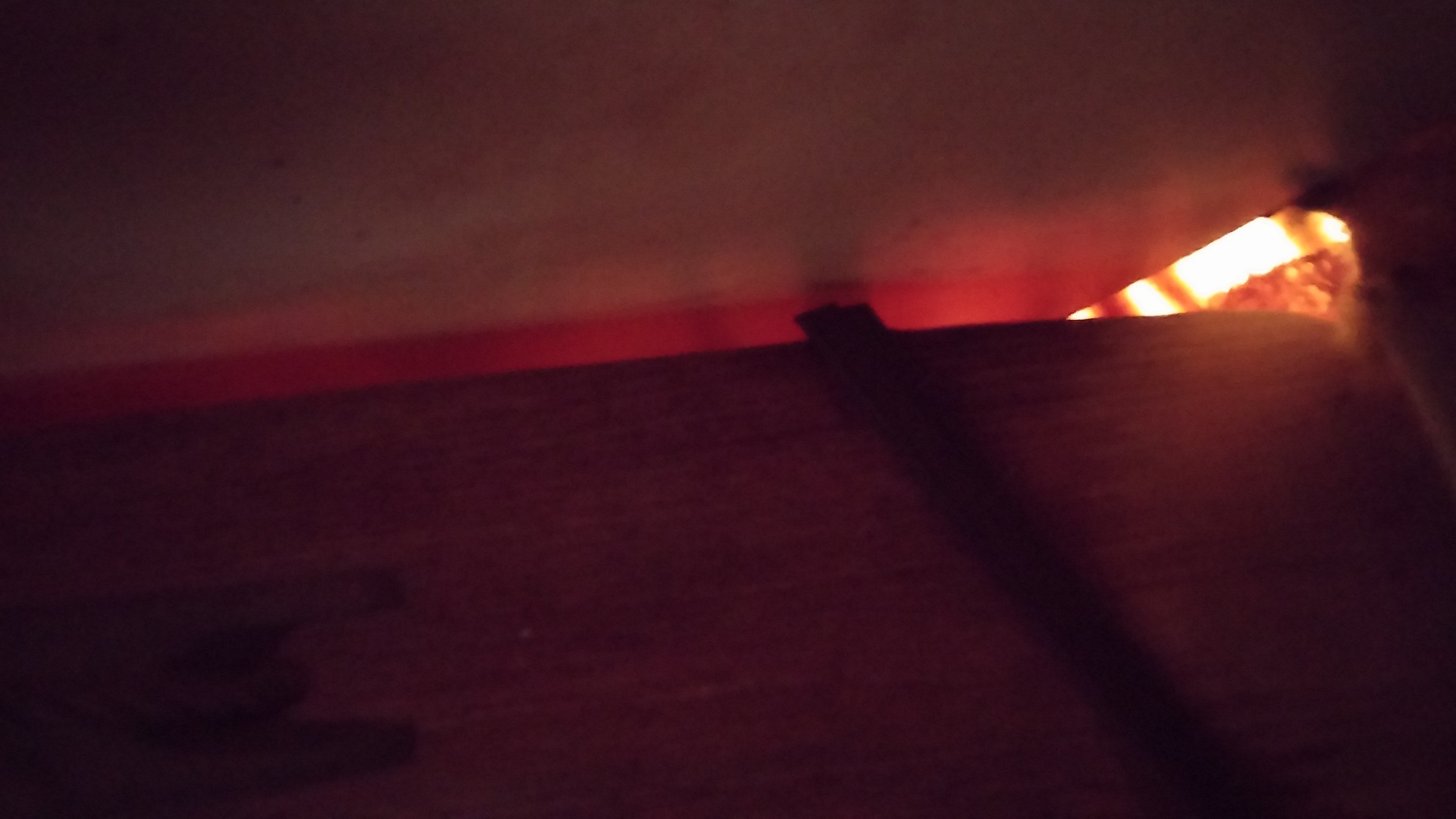

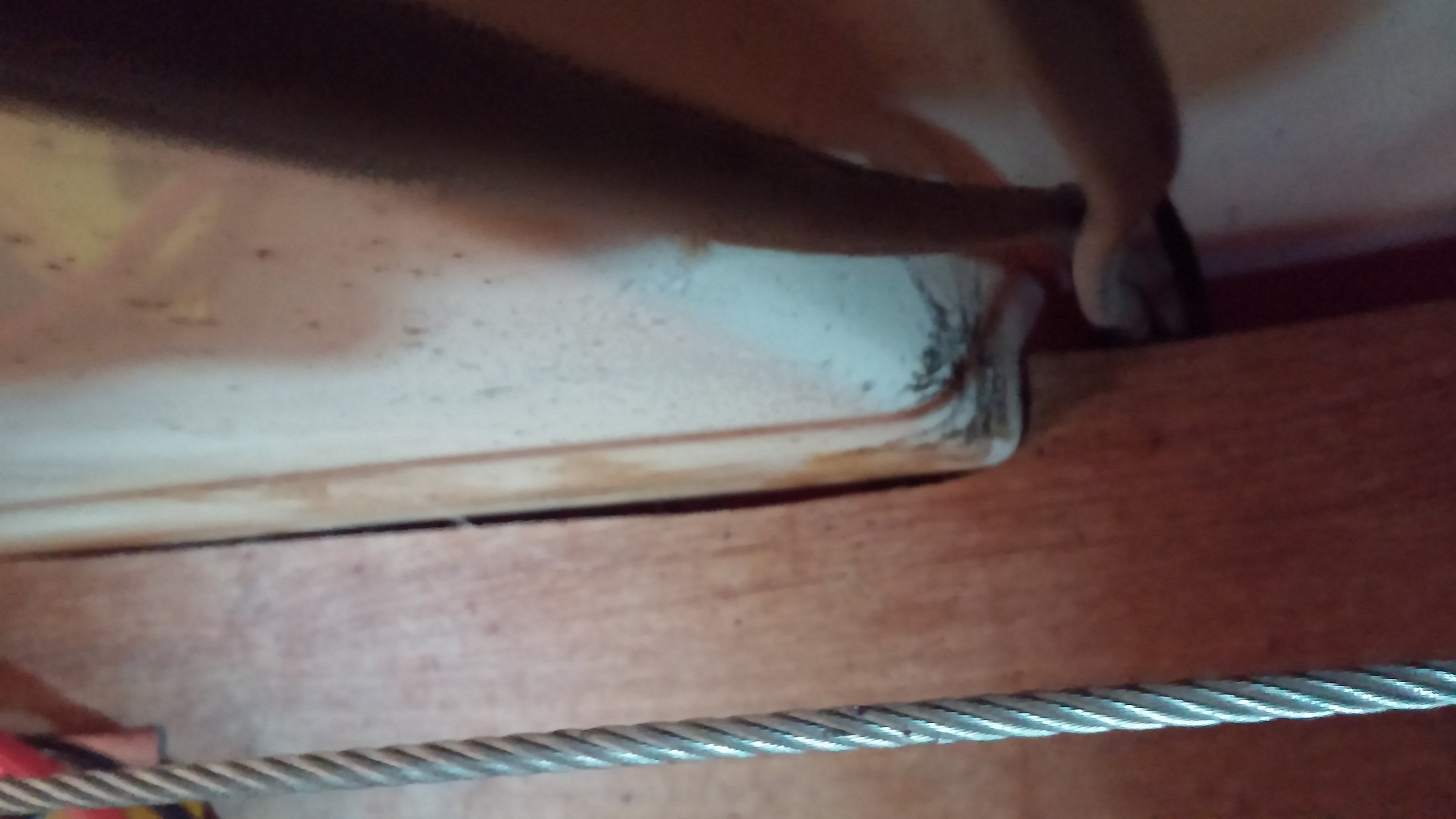

There is a teak bulkhead under the cockpit that runs along the centerline of the boat, dividing the quarterberth on the port side of the cabin from the area on the stbd. side that I want to access (see pictures if I am successful uploading). This wall does not touch the underside of the cockpit floor, so I'm thinking it is not structural or weight bearing. Would there be any problem removing part or all of this wall?

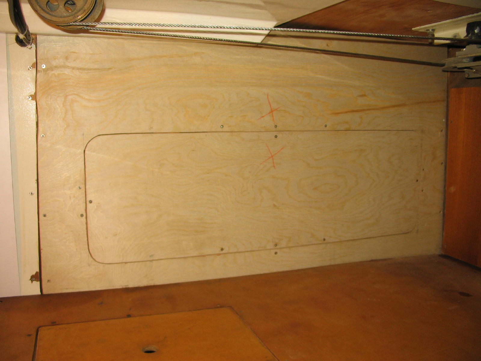

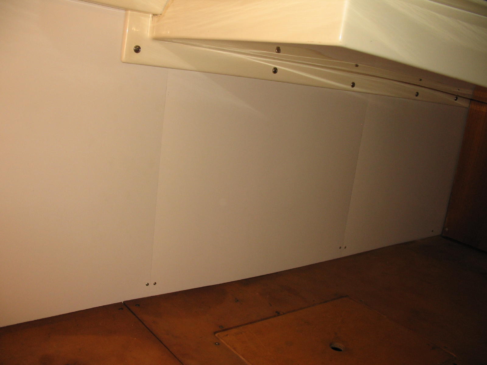

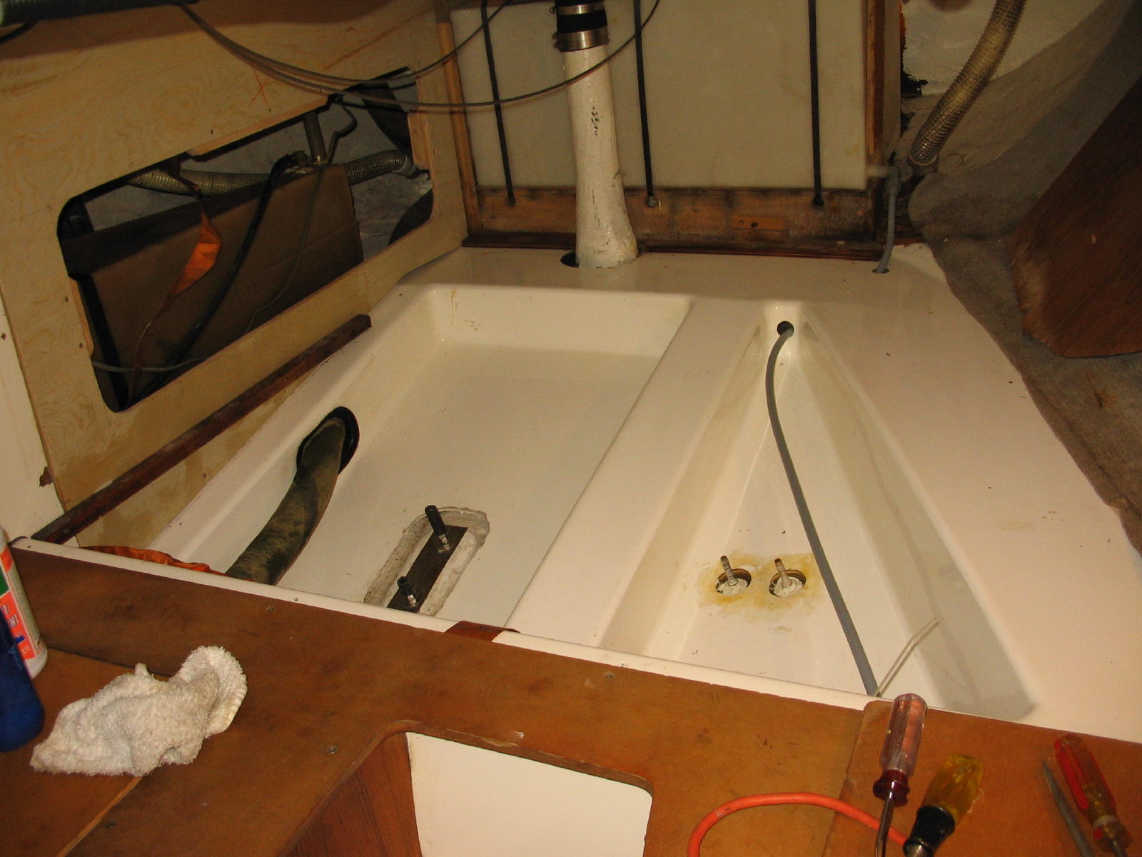

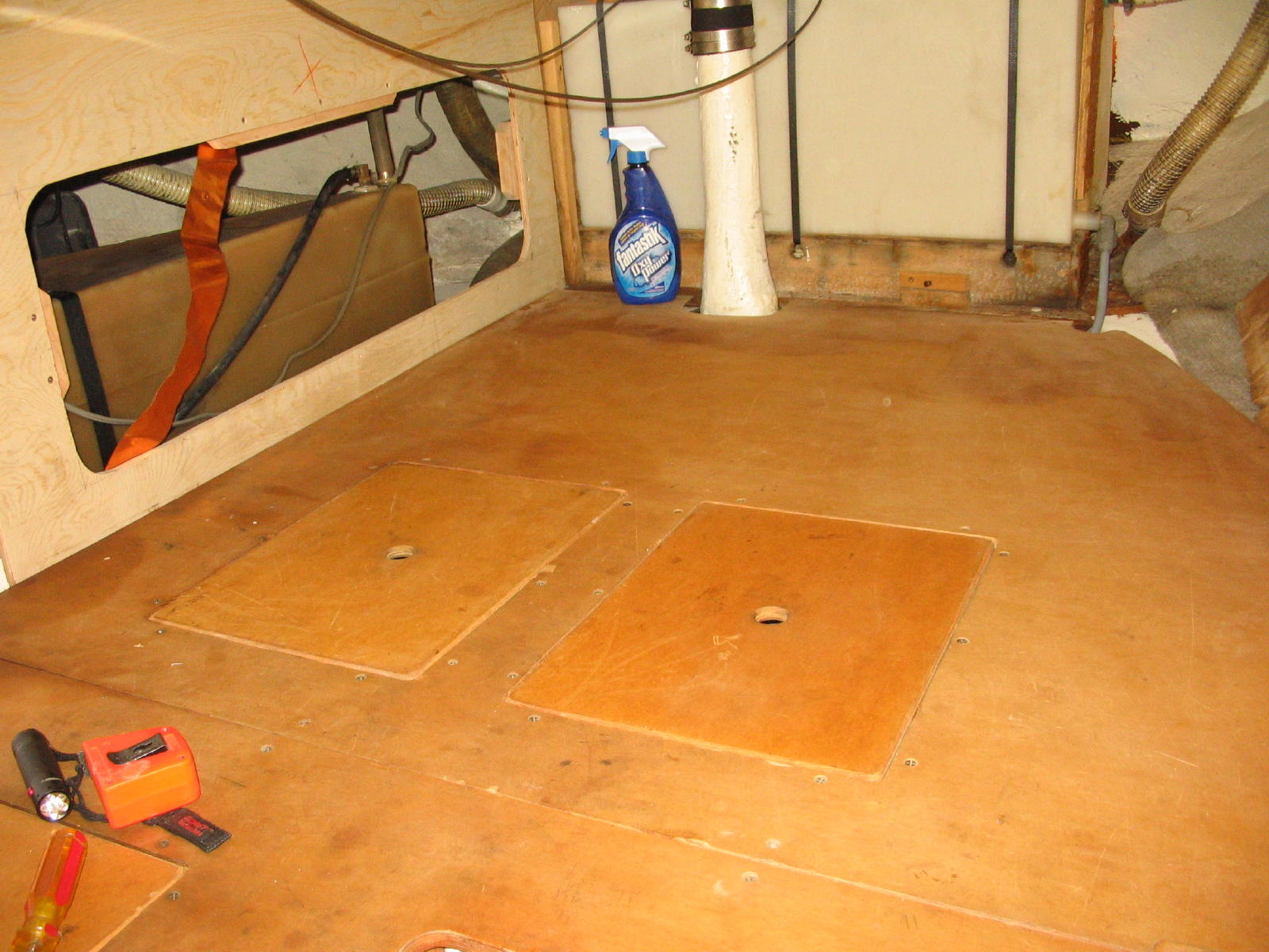

Here are the mods I did to gain access from the stern cabin on my 34. I cannot get in the laz through that but it has given me lots of room to reach in much easier. the opening is 30" X 15" and removable easily. Of course I have to take the white paneling off but it provides access to reach in there much easier. In fact I got the old fridge compressor out through there last summer. Hope it could work for you.

I was able to get in and out of the 31 though the lazarette ( I'm 6'1" 260lbs) It was tight but doable. But the placement of the batteries on the 34 made that impossible. I cut a door out of the side panel (it is not structural or weight bearing) and installed hinges so it just swings open. I didn't feel the need yet to finish my entry like Claude's I can service my batteries and fuel tank from the aft cabin.

Claude, that is brilliant and nicely executed. To egress we have a small step still made from plywood to make the exit easier. We have an '83 H31 as well.
