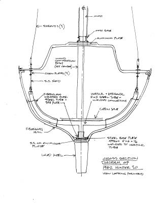

Here is a quick cross section diagram of my 1982 H30. Hopefully it's legible. The design is very different than the H30's of other years. The vertical and horizontal steel tubes are welded together and fiberglass wraps about half way up the vertical tube in the bilge.
I cut the fiberglass off the compression post base two years ago to inspect the condition of the steel. I was releaved to find just surface corrosion (The boat has never been in salt water.), so I simply wire brushed it clean and primed and painted it. I also filled some gaps under the base plate with thickened epoxy, then sealed the edges of the plate to the fiberglass bilge with 5200. I have no intention covering it with fiberglass again.
As you can see from the diagram, this is not just an isolated compression post, the horizontal tube actually bends upward like a pair of "ribs" to to a connection with 3 stainless steel rods which fan out to the chain plates. Sorry, I don't recall the exact design of the connection.

Dalliance - Thanks a million! Picture's worth a gazillion words! Design looks quite seaworthy and I think I have only surface rust. I'll repeat your fix on 'Bout Time and then off to the races. Thanks!!!!!!
