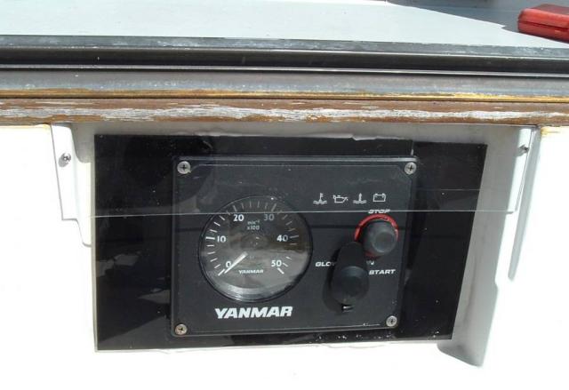

The '77 was pretty unique I think. Doesn't the '78 have a 'T-shaped' cockpit like my H37C? And I think the '77 seating went around in a 'U' shape. I think a picture of the instruments and holes would be helpful. Sounds like it is on the front of the bridgedeck like mine(photo).

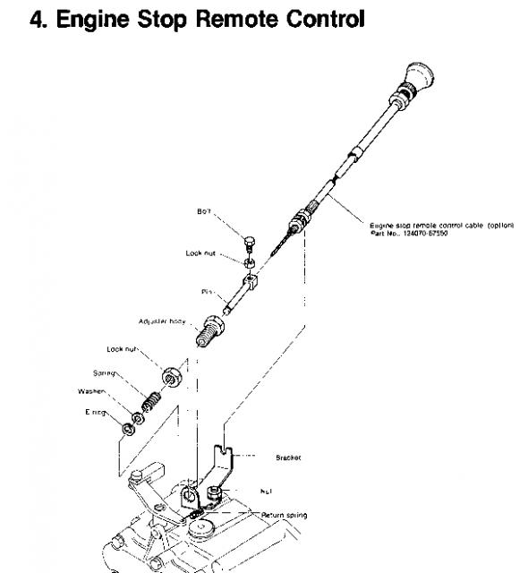

Most if not all older Yanmar engines installed on Cherubini's do not have "engine stop controls". Adding one looks to be a fairly easy task if you want to go through the trouble. I have toyed with doing it. But it is on the bottom of the ever growing list of things to do. Here is a diagram of a remote stop control.
