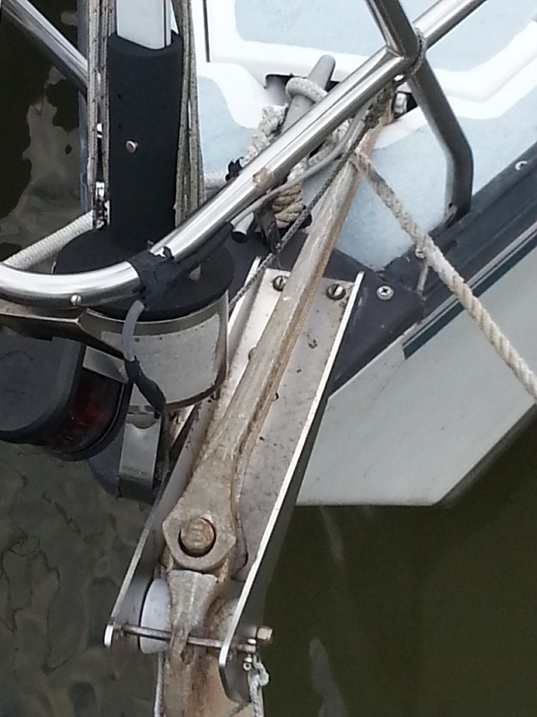

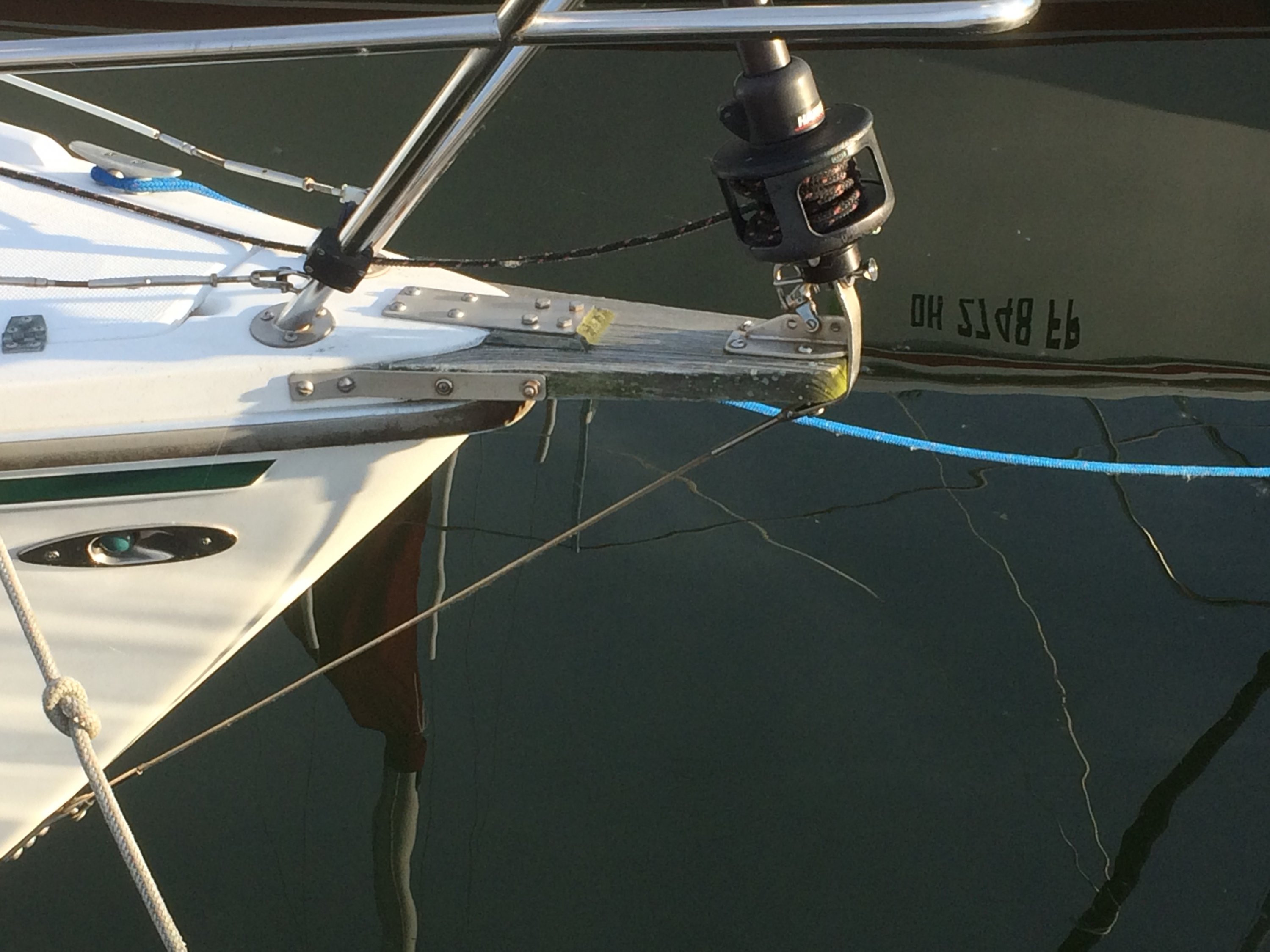

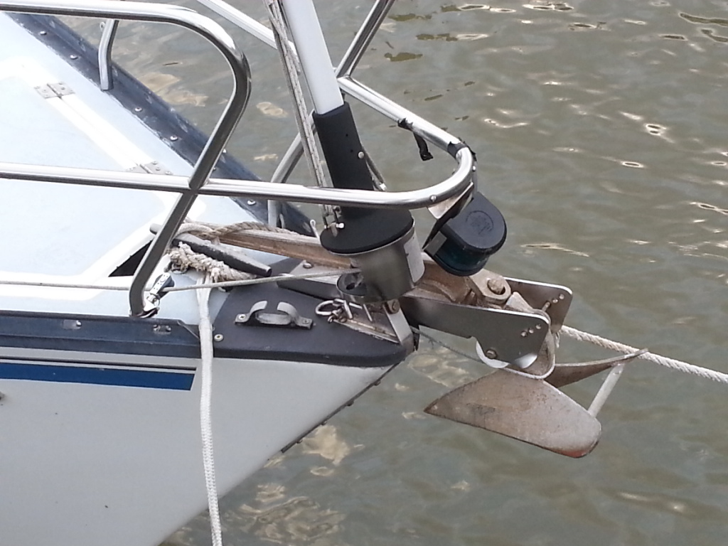

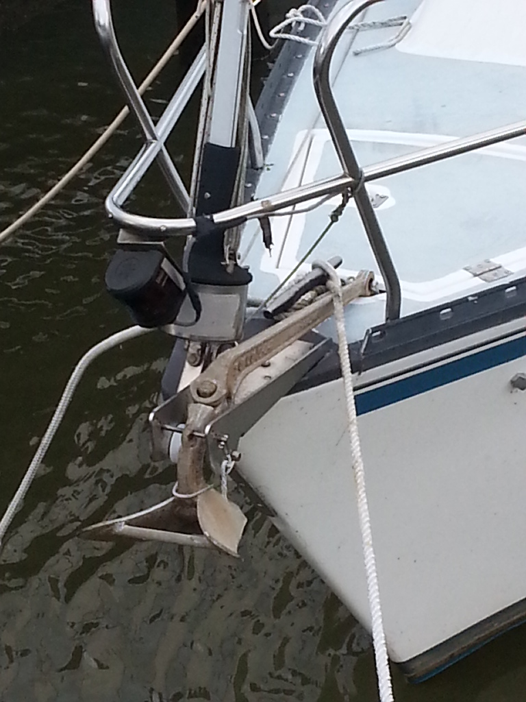

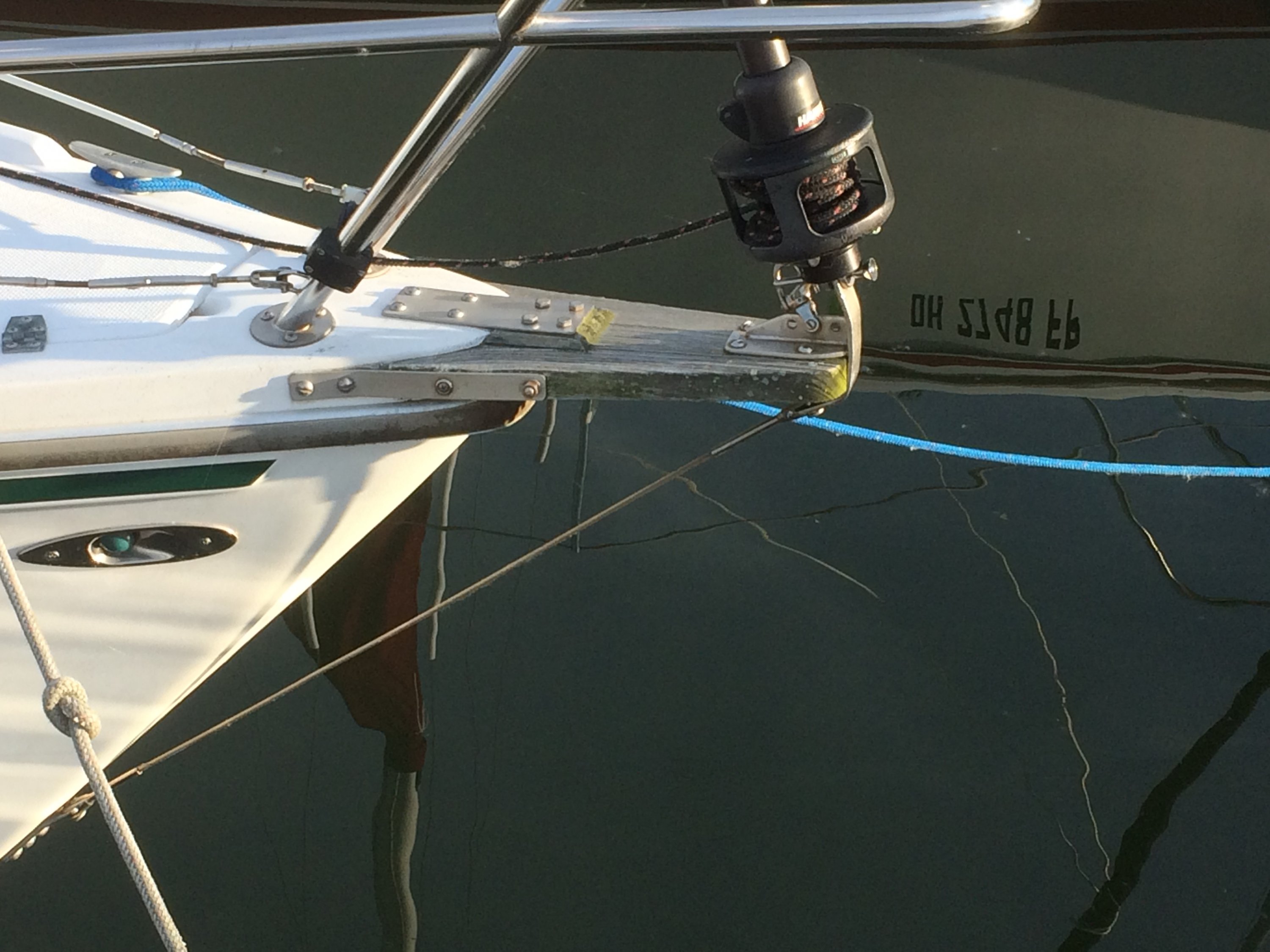

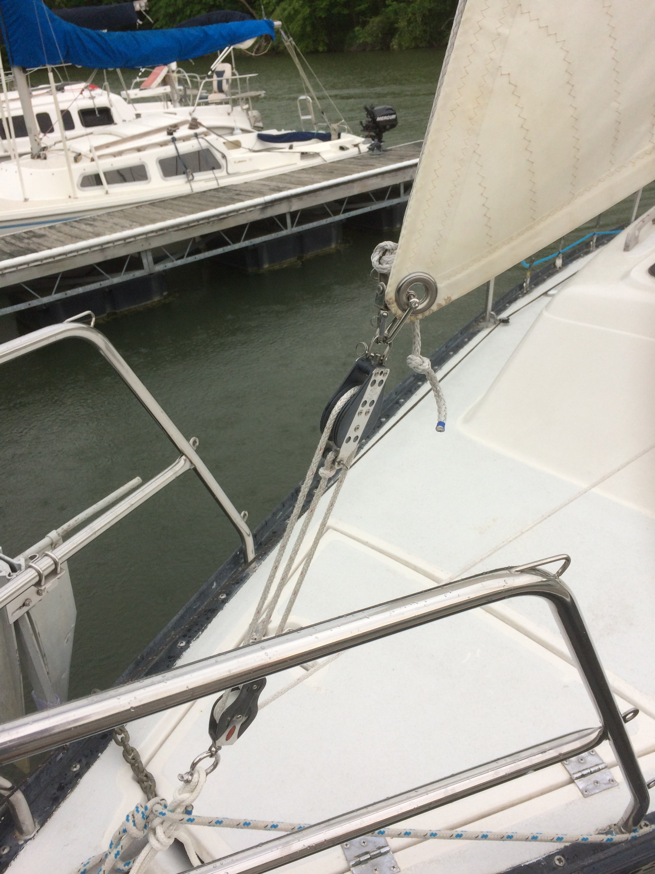

"Anchor roller" - the attached photos are not my boat, but should give you some ideas. I haven't seen the underside up in the v-berth, but probably needs a backing plate or at least some oversized washers to keep from the bolts from pulling through.
You might consider that it would be easier to just get a folding Danforth anchor that fits in the locker.
It's another of those projects that's on my list, too, but I don't cruise enough to really want it.

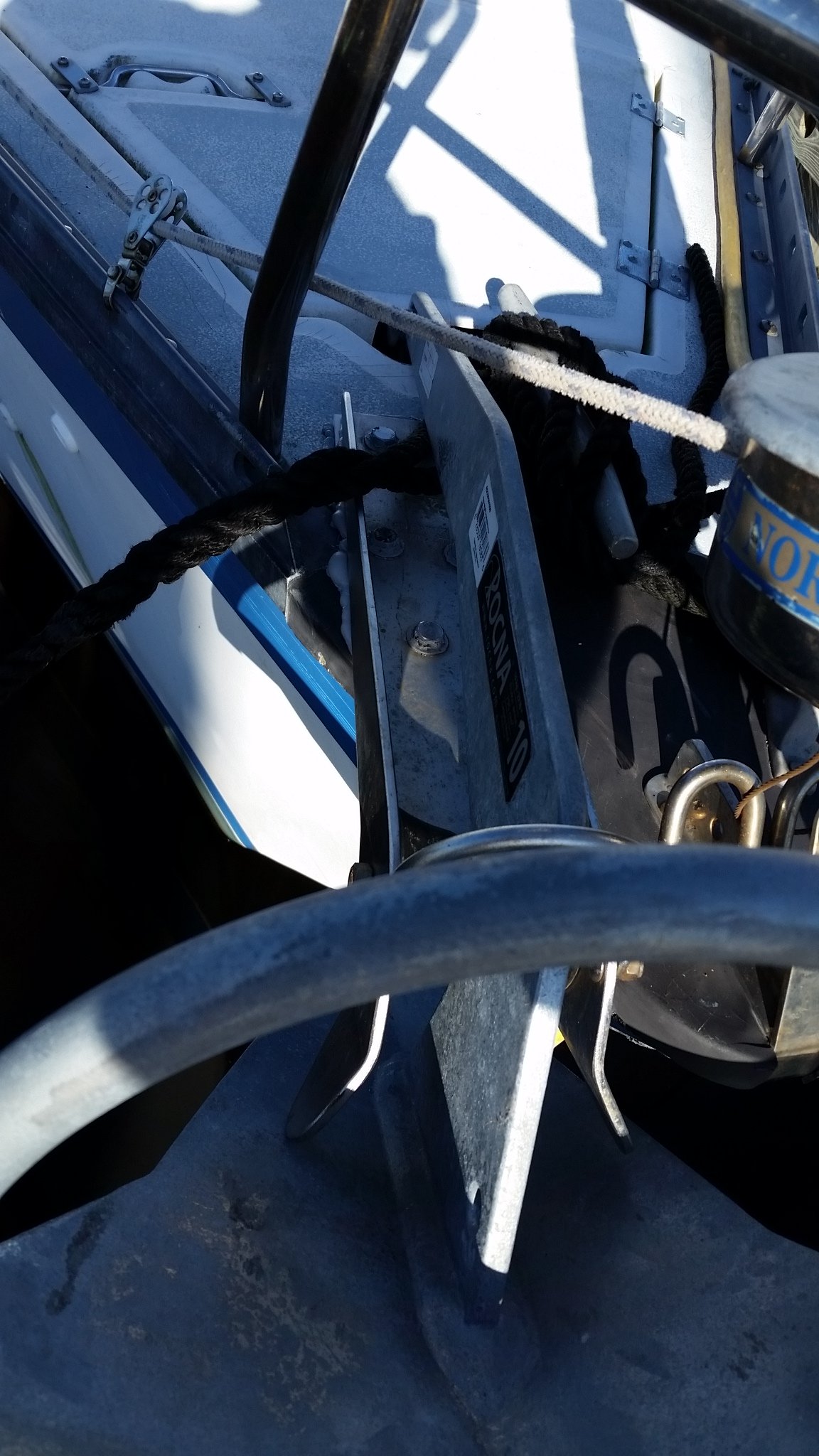

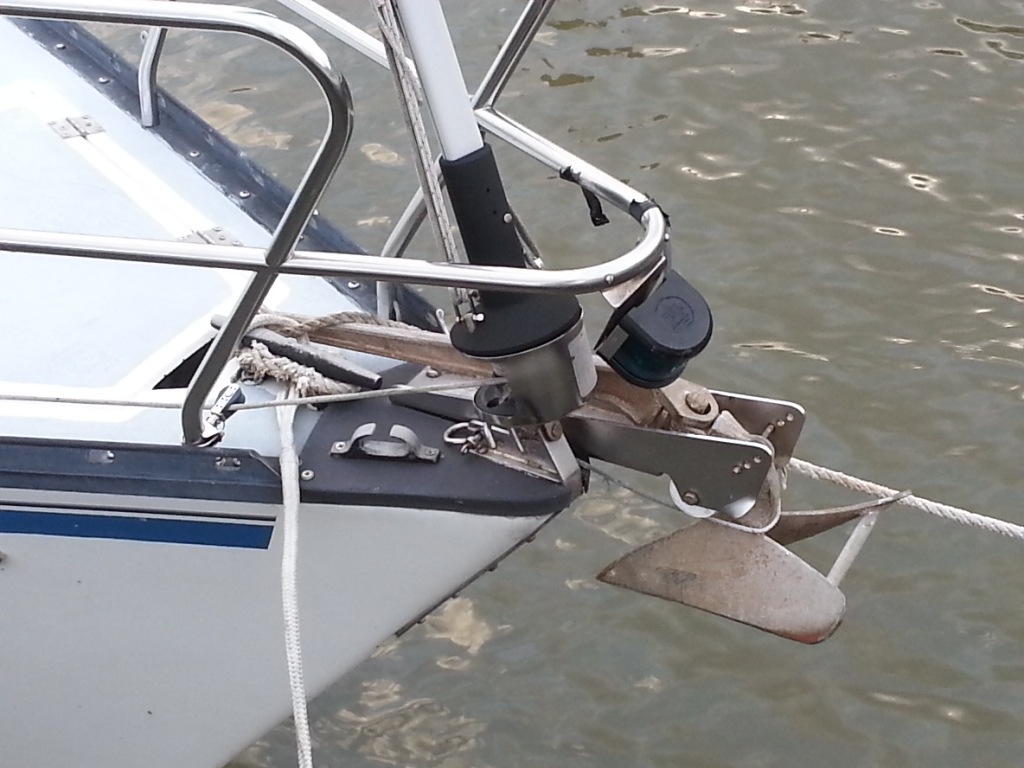

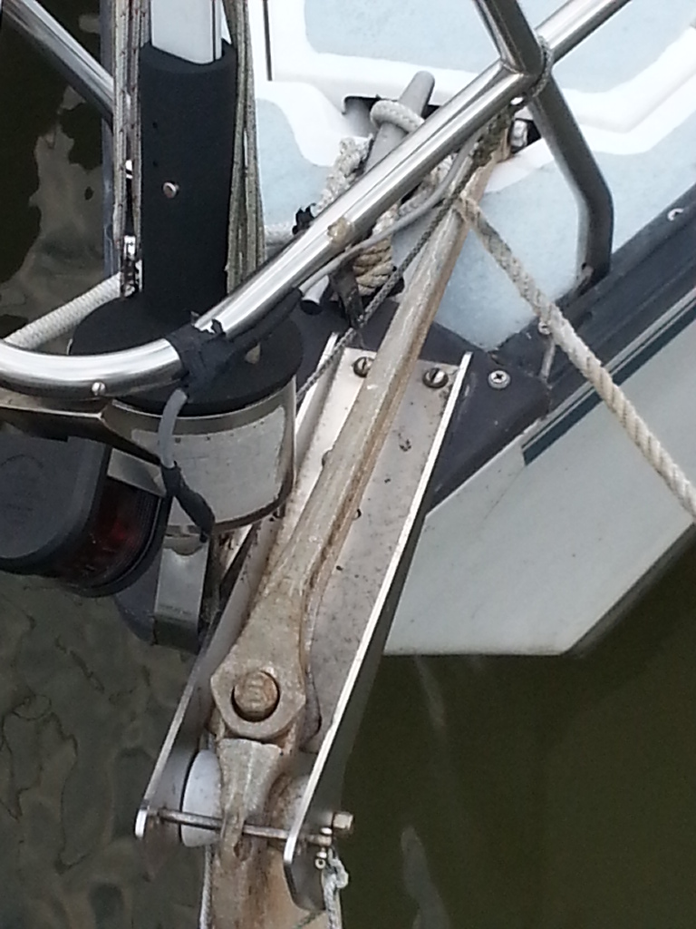

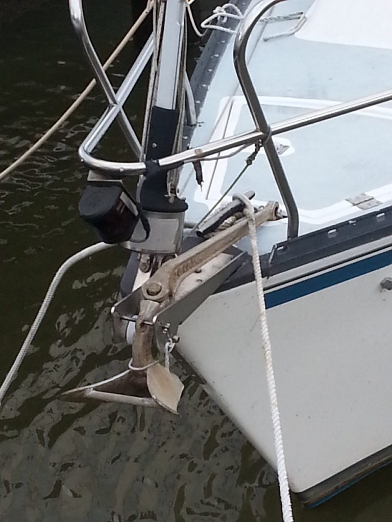

I installed a bow anchor roller to my H27 to handle my new Rocna 10kg. It was a tight fit around the roller furler but has worked out nicely. The anchor roller channel extends a little aft of the cleat, so I installed another cleat in the bottom of the anchor locker so that there is a straight run through the anchor roller channel. The anchor roller is thru bolted so access to the backing plate, nuts and washers was a challenge, but doable. Here is a pic:
