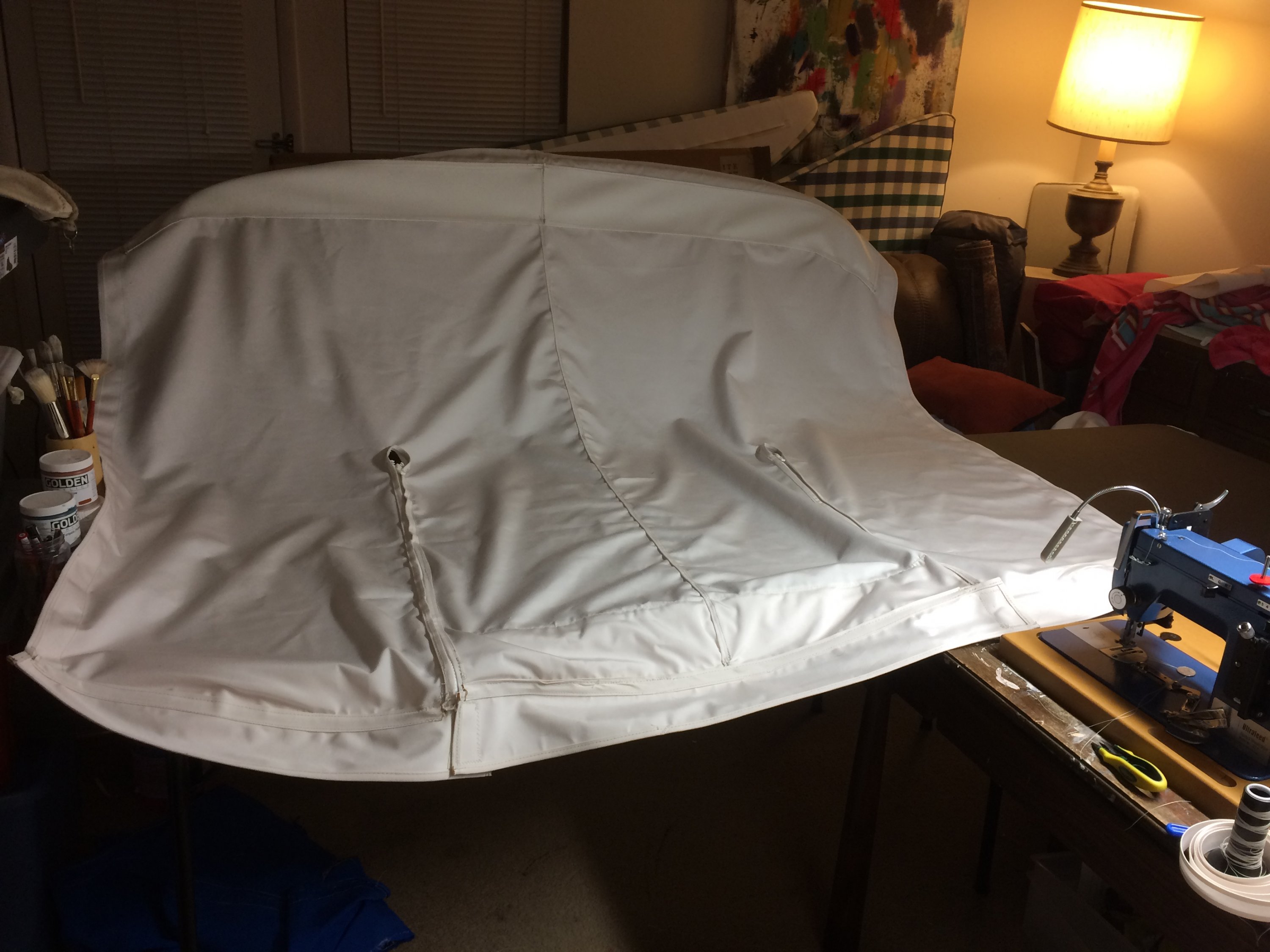

Sorry I don't have any photos showing the details, but when I sewed my new bimini a couple of years ago I put in the short zippers that come in from the sides. It was that way on the vinyl bimini that I replaced and also what Sailrite showed in their how-to video. The shorter zippers reduce the chance for leaking. I don't find it a hassle to get the bimini on and off.
An adjustable backstay isn't near the top of my list and I know I hadn't even thought about at the time, but if you think you might do it soon, then the other zipper option you described sounds like the way to go. Good luck with it.

I was following the instructions and methods that other people have used before with success, so I didn't really even think about the tension. The bimini is not one solid piece of material, it's several curved sections sewn together to accommodate the curve of the bows. Any stress is on the seams, not sure I'm capable of tensioning it so much by hand with the straps that I pull the seams apart.
But your mileage may vary.
