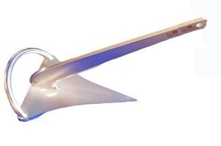

I need something that will dig in so I'm thinking plough or spade as in Delta, Bugel types etc. (not CQR)
What's your poison, as in type and weight please?

A Delta or any of the 3rd generation plows will work great. We had a Delta hold us a meter off the mole while med-moored at Thíra with 50 knots on the nose. If it slipped we would have been royally screwed.

My conditions will be mostly weed, weed on sand and/or rock but very rarely mud. My last set up was, forward bowers 65lb CQR and 75lb CQR that I changed for an 80lb Delta type and the stern bower was Alloy Fortress. The only reliable one was the Delta type.

I am looking at a 9kg (20lb) Bugel spade type anchor as my main rode, do you think this is heavy enough for a H260.

the best priced deal over here for me is the Bugel. The Spade S80 is about £500 delivered:banghead:
