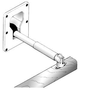

I have the H26 with a tiller and I have a hiking stick on the tiller that I can lock into a "lock box".
I could not find a pic of mine on my computer but I did find the part on line. It looks like this
The box is cut into the combing in the cockpit (where you lay your back).
The set up works very well and I've had no problem with it coming undone. You can also use the setting on the hiking stick to set the tiller off to one side or the other to get the tiller out of your way.
https://www.westmarine.com/buy/forespar--tiller-lock-box--190934
or search boat tiller lock box.
