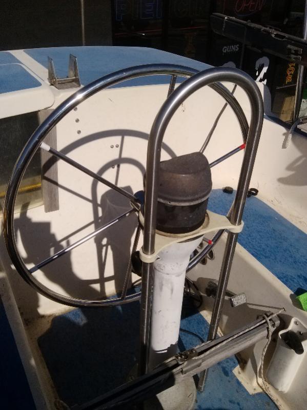

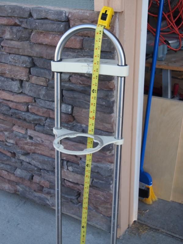

Hunt around for a used one. Craig's List, eBay, sailing forums. I found a used one, looked new, $50 on CF. Included FedEx.
Love the added hand hold it provides walking up and over the cockpit seats. Makes for a much more enjoyable sailing experience, without denting the bank account.
First image is at sellers location, second image is on my Crealock CM 32
