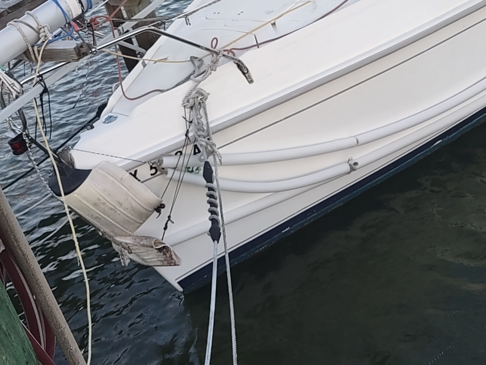

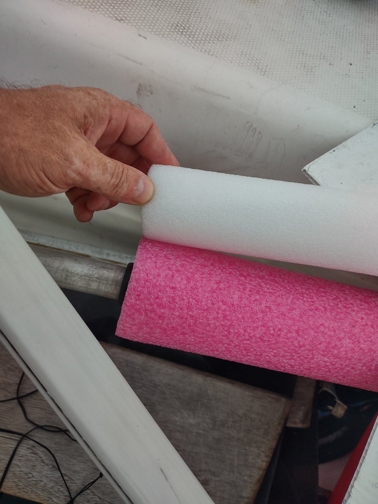

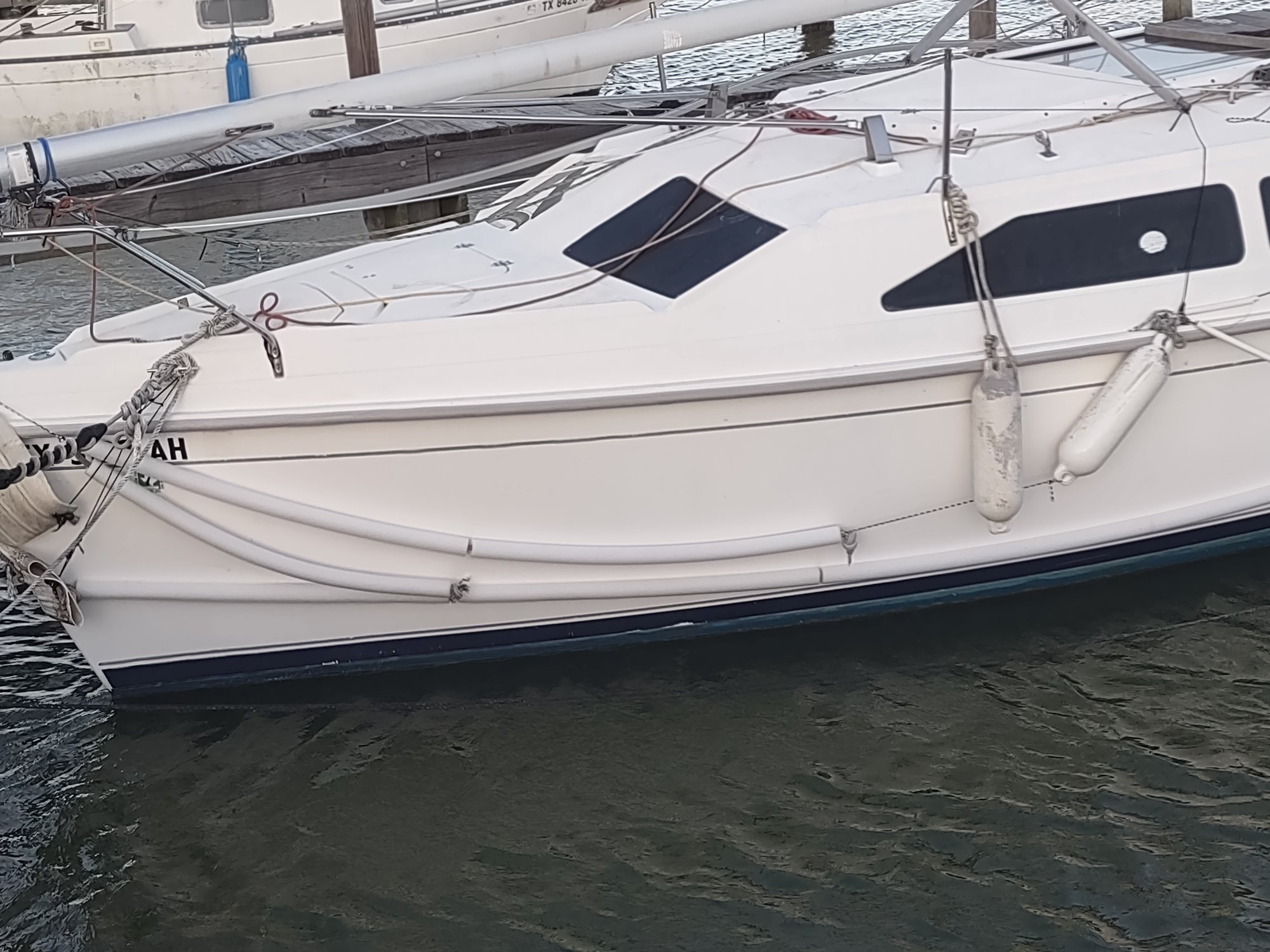

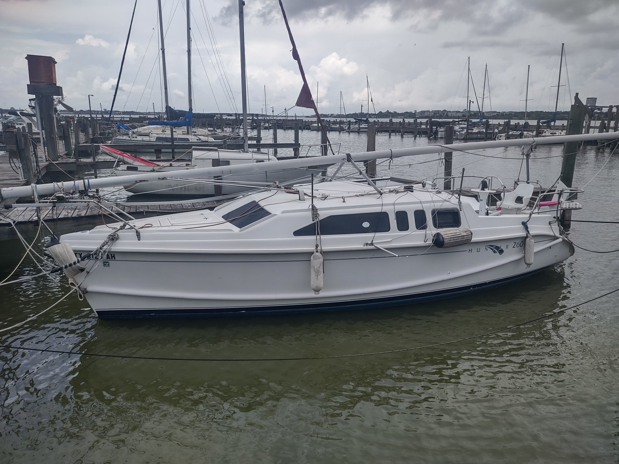

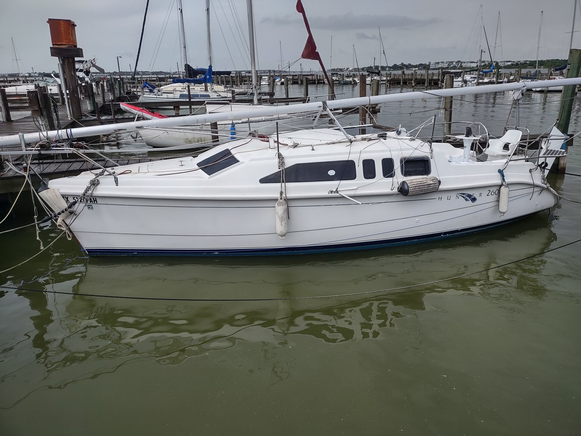

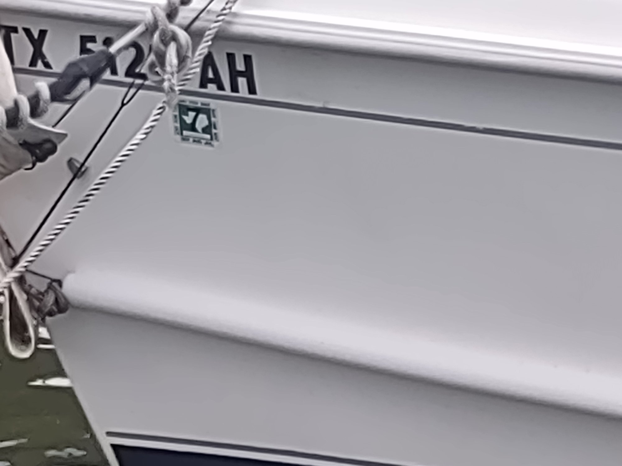

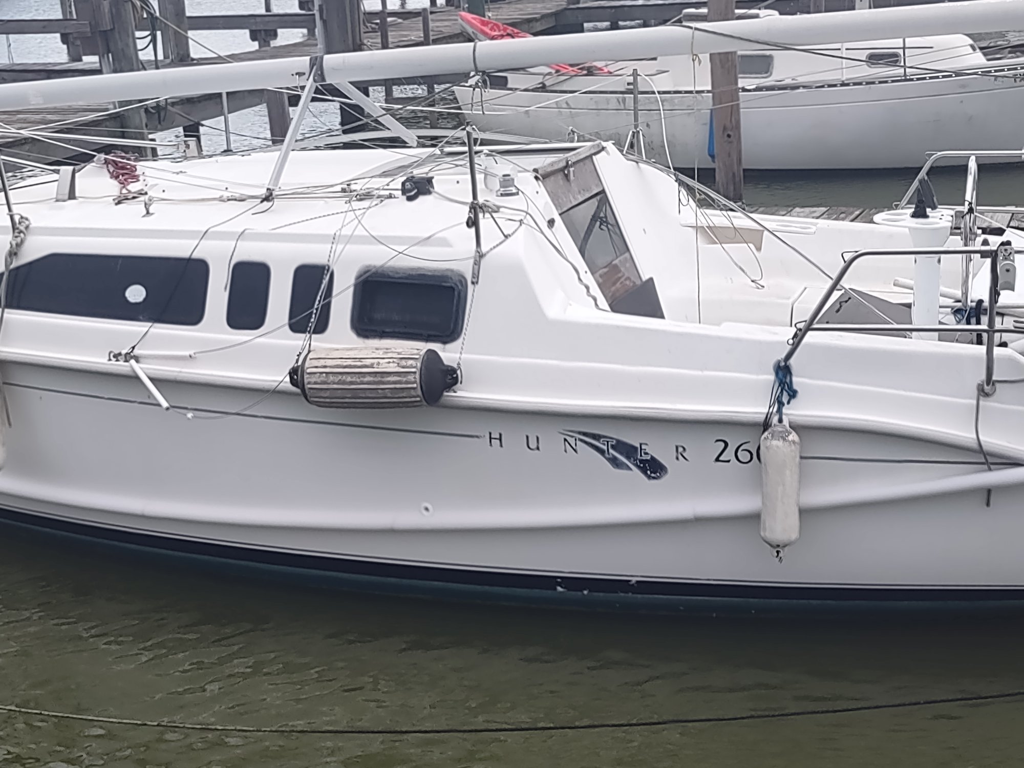

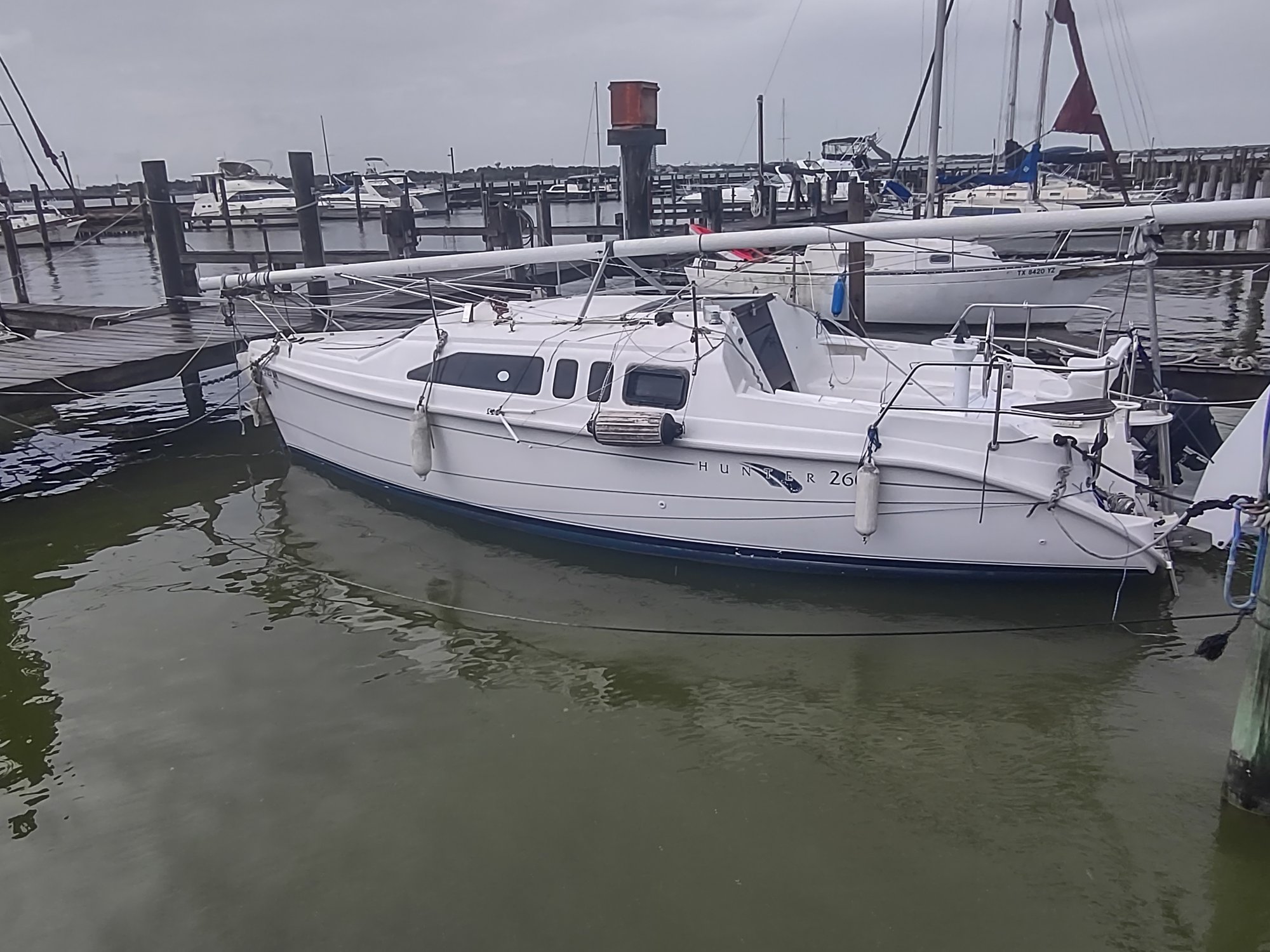

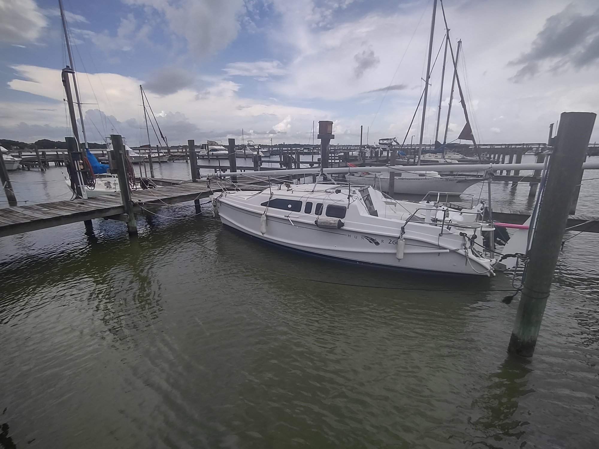

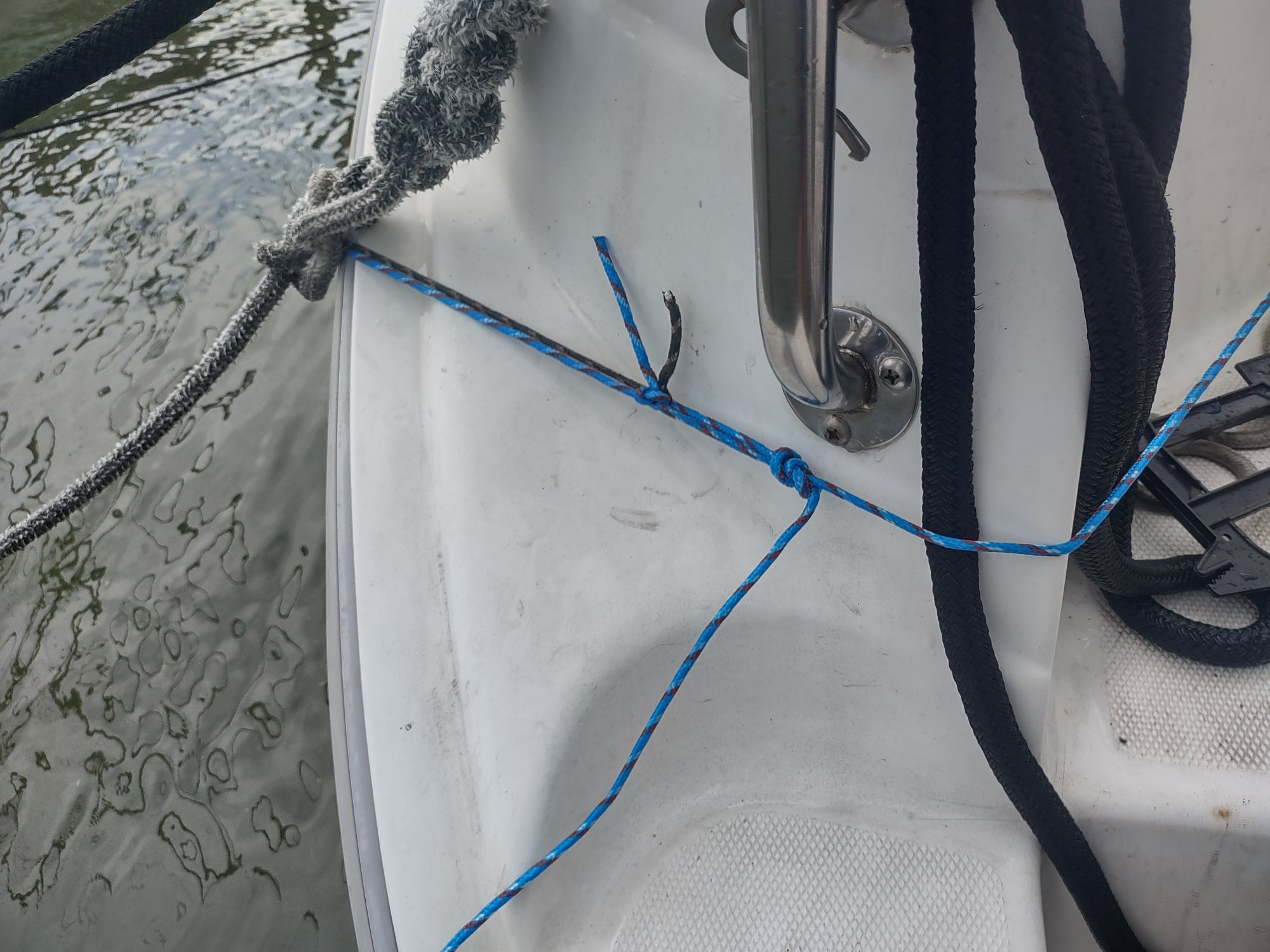

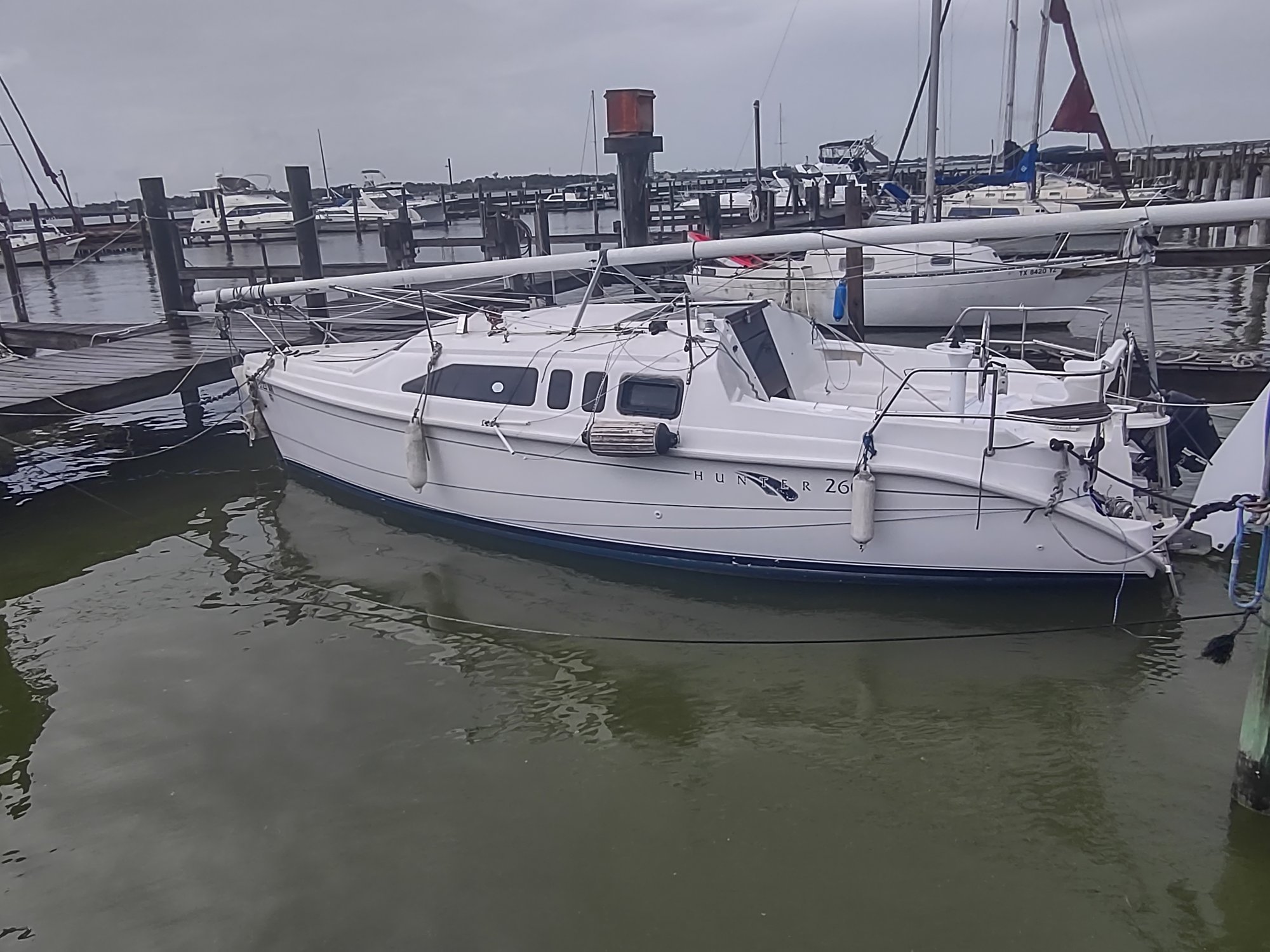

For marinas with sharp low docks (like Galveston) I am trying foam noodles on long long rope, from front tow hook 2 ft from water to rear corners. SEE PICS. I tried a few rope paths (see pics) including real low, to see what is possible given hull curves and where rope would stay, and went with medium height. A 2nd even higher could be added. Bigger noodles would be better. Can pull this up when sailing. I wish someone sold cushiony rope. I used 6 46 inch noodles, rope is over 20 ft. Overall it seems to work and is better since it sorta replaces 5 vertical bumpers with a single classy 1. D

Interesting idea. Please share what it is you are protecting against.
Most hulls are widest at their deck level. If you have boats entering the slip next to you then it would likely be more protective of your topside to hang several fenders (4-5) long vertical with larger diameter to the bow and stern and 2-3, equally spaced near to the middle of your boats widest point, that are slightly smaller diameter. That way you protect the whole side of your boat with a cushion of 5-7 inches. Also hanging them within 5 inches of the water provides coverage even for the low slung speed boats.
Pool noodles really do not handle UV exposure well.

Perhaps one or two pictures of the problem side, showing the noodle actually protecting the boat from the dock would help me understand your plan of action. At this point I'm not clear about it.

Yeah! Great idea. Sort of modern take on fender boards.
I'm imagining the noodle won't hold up very long in a storm with constant chafe. Maybe you could get some old fire hose material and stitch it to the outside of the noodle.

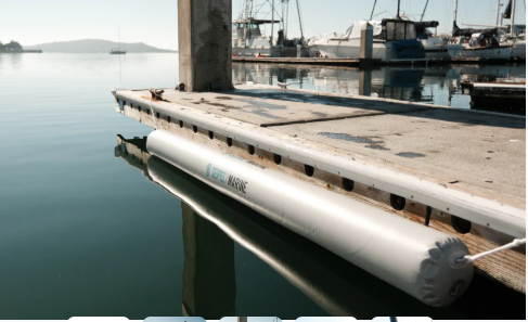

There is a similar comercial product but it is $pendy

can’t imagine how much protection a foam noodle would offer but to the point, wouldn’t it be a lot easier and safer to not hit the dock in the first place when entering/leaving? Or properly adjusting dock lines to keep off the dock?

A gust of wind can push boat into cement nonfloating dock, can't reduce all risk. It's why even good drivers use seatbelts. For the maybe quarter of people with nonfloating docks at high water levels a bumper hanging 1.5 feet off the edge doesn't cover the bottom 1.5 foot, this quarter at very high tides have nothing there and it's scary coming in at high water. Experiments are helpful. And now know it's possible given the ok rope curve GIANT foam noodles could be found for sale somewhere in the big world. Cheap rope and $1/ft foam noodle means 20 ft is $20, so seems cheaper than $500 20x3 giant inflatable, 25x cheaper. I used the thickest rope possible, so rope adds to cushion. What is the thickest spongiest rope for sale in world? Hmmmm, could even loosen rope and drop rope into water to float, which might help even when darn cement dock is submerged an inch. Floating docks are awesome, but not all have em. Happy summer!

Never put fenders horizontally. They can roll up the sides and pop out. I imagine the same goes for a horizontal noodle

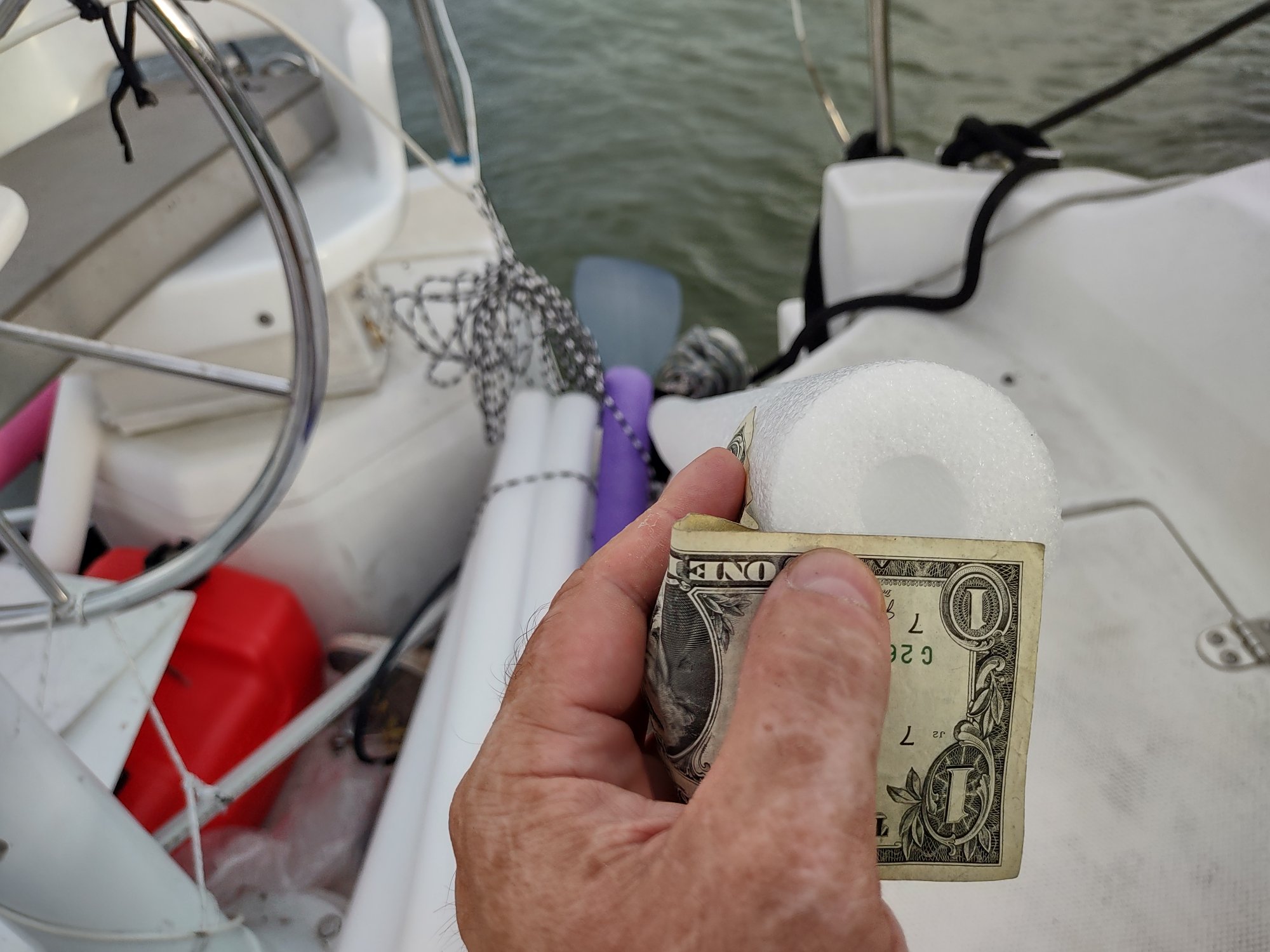

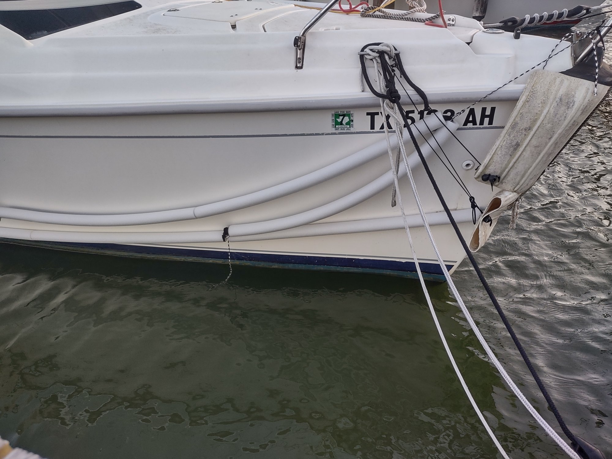

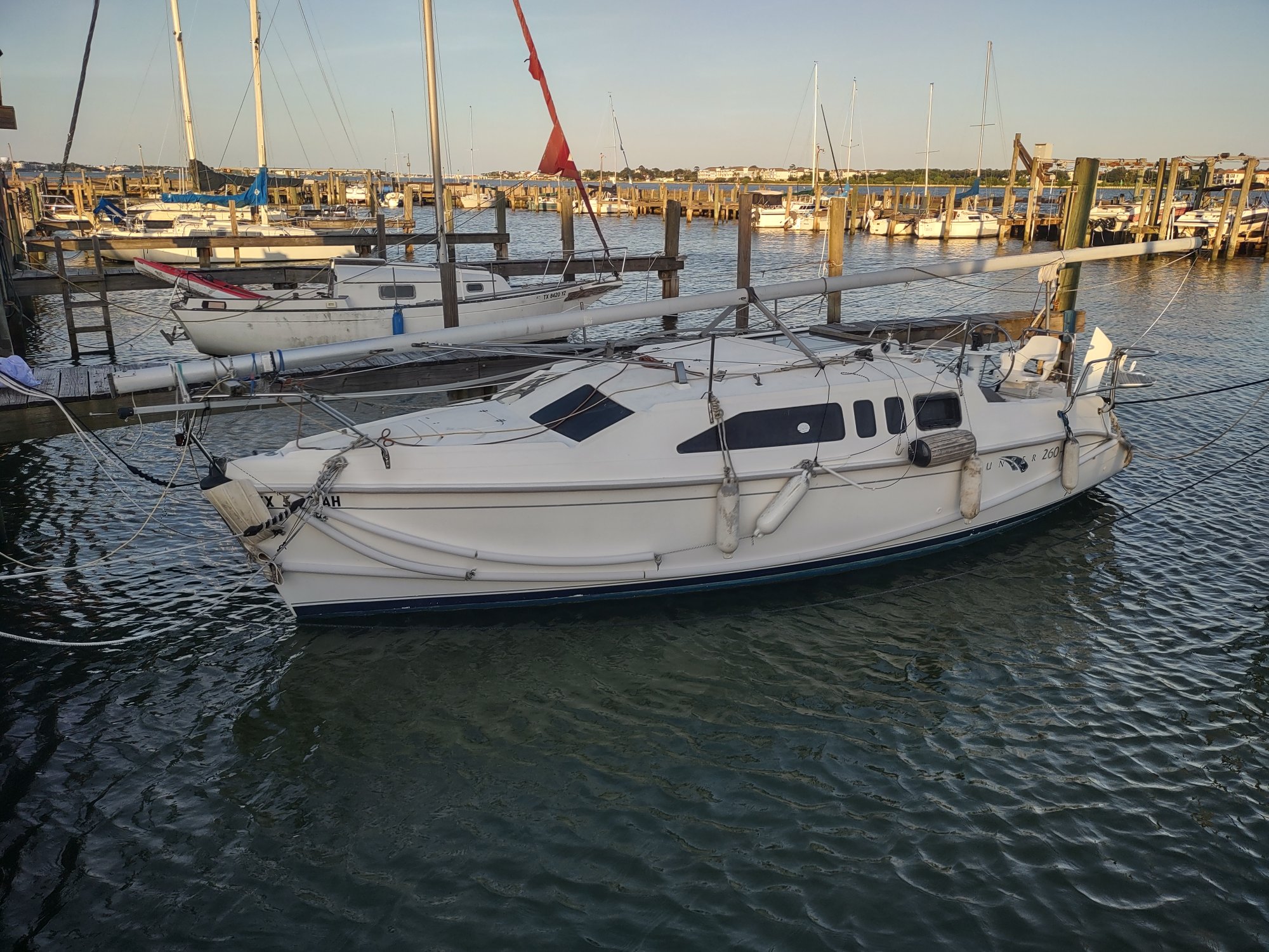

I added some more foam noodles to front 5 ft... Yes I know this is excessive bumper levels but I wanted to experiment on how safe can a single person make docking. After Sept I will remove and be boring again. There are thicker noodles so it could be done better using them. See pics. - D
24,650
I do understand the desire to protect your boat. Covering her in noodles is like wrapping a child in bubble wrap to prevent scraped knees and elbows.
You can learn a skill that will make you safe in all your docking single or with crew.

That's a very wide berth but the exact type that I had when I setup the V lines in my post above. It worked very well. It saved me from hitting the dock a few times and made it easier to dock. Polyethelyne foam compresses too much to provide any real protection in my opinion, especially when it's a hollow tube. It may be gentler on the gelcoat than bare lines

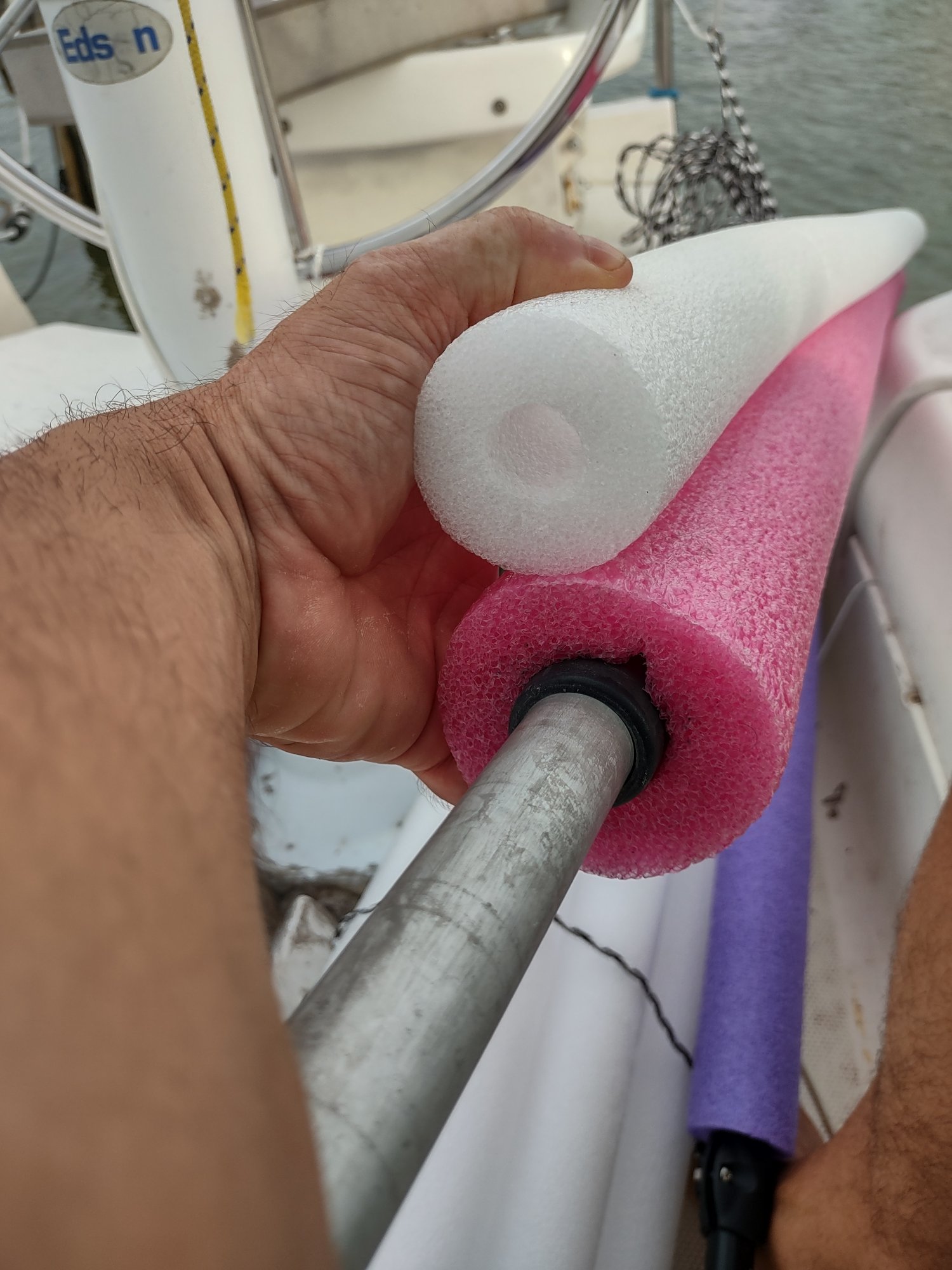

In middle of foam noodle is a thick rope I barely managed to pull thru, so that adds to the cushion. Honestly that the rope drapes in a nice low line is cool discovery. Hmm, maybe have 2 rope-noodles side by side even. Cost wise, at about $1 a foot of noodle this is $20 per side for 1 line, pretty cheap!!! Noodle-rope bumper seems a cool opion, maybe just on ugly boats owned by unfancy people. To everyone saying just be better a boating, wind gusts and also motors dying are unpredictable.
