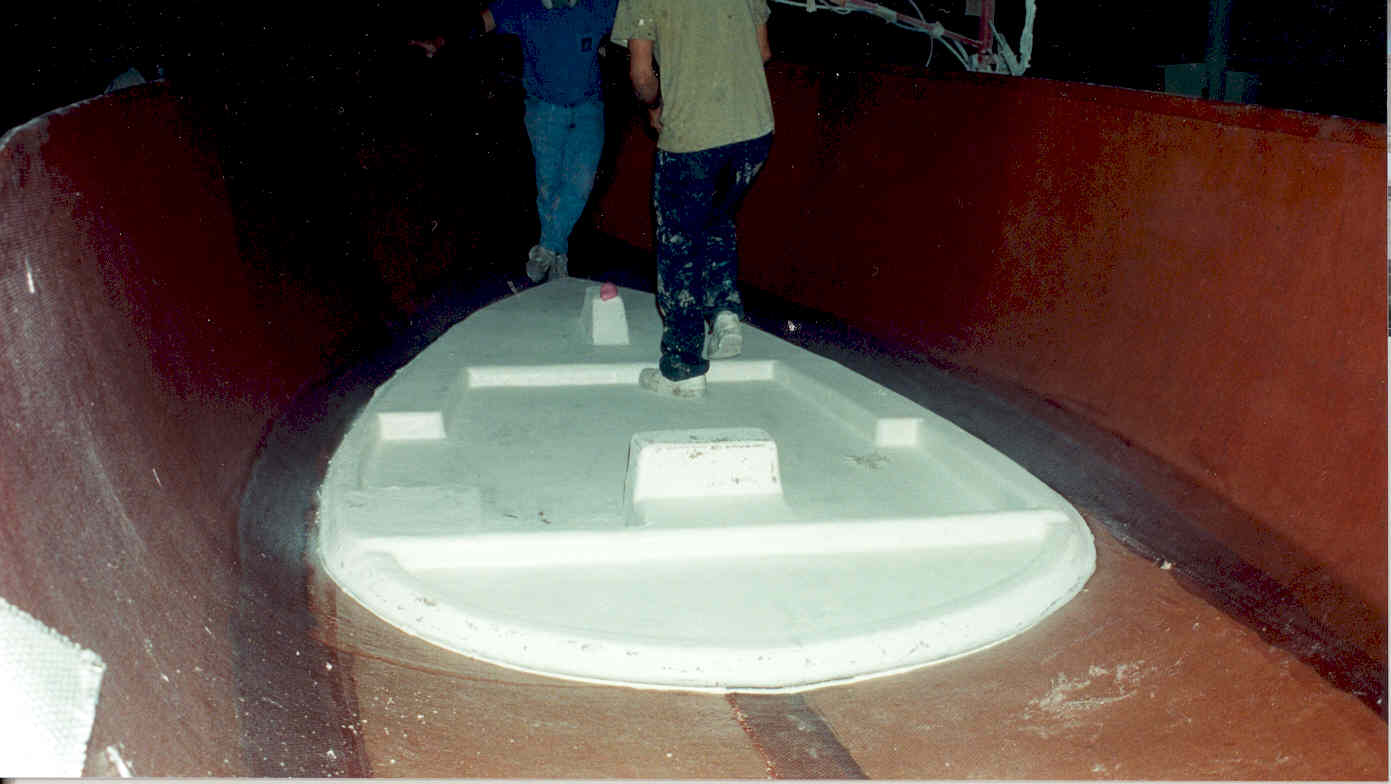

Is it flexing when on the water with ballast tank full? There is some flex in both areas as it is essentially supported by the top of the ballast tank. A bit more flex in the aft areas than forward as there is a bit of a cavity between the cabin sole and the ballast tank lid or further aft - the hull. It does seem to rely primarily on the shape of the fibreglass for its rigidity. It is somewhat less flexible when ballast tank is full.
you can look at the cavity over the ballast tank from the access panels under the aft berth mattress.

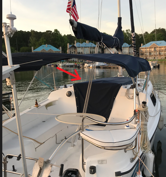

The companionway hatch (top hatch) is notorious for leaking and you will get water pooling around the bulkhead. That is what is most likely causing the delamination in the wood. You will want to get a companionway cover. They sell them right here at SBO. Here is a pic of the one I got from SBO.
I put my throwable float under the cover to give it a little pitch so the water ran off better.
