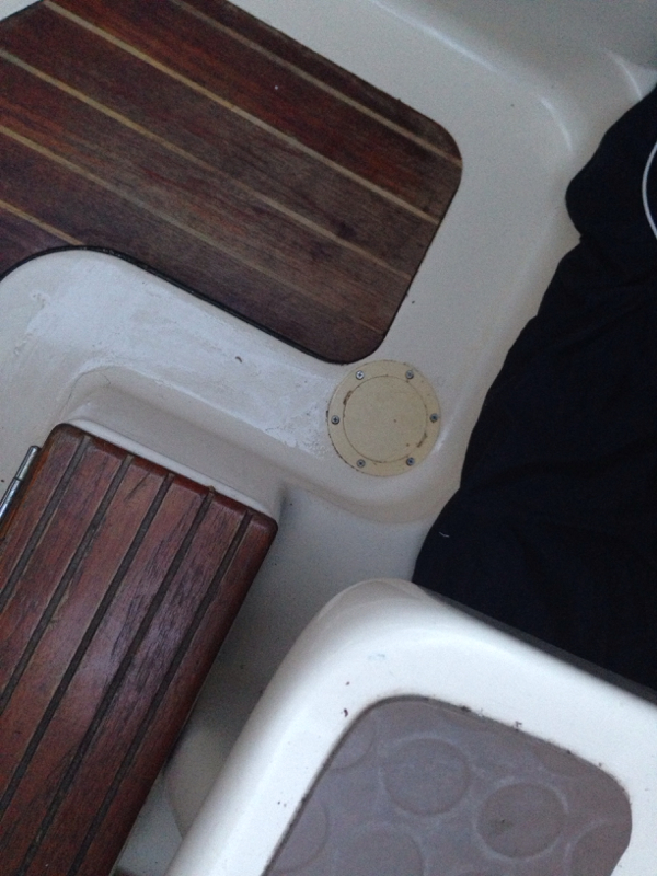

The inspection plate he is talking about is probably the one in the head. U open it and there us nothing there. The plate is about 2-3 " in diameter.
Here is pic of the indictment plate bottom in front of head?

Thanks for the picture, very interesting. My H260 does not have that inspection plate, it must be a post factory made modification. The inspection hole actually should just lands up above the ballast tank. You may take a flashlight and shine from under the q-berth in the direction to the inspection hole and see that.

Thank you so very much for your excellent reply. I will follow your directions at the end of the season. That inspection hatch still remains a mystery though. Is the major difference of the h 260 is the inboard power plant and the cost?

I have that same inspection plate but in the head area on the floor. I had water also but I put a dehumidifier in my boat to dry it out. Now I am just running my a/c to keep it dry.

I also do not have the inspection plate.

That is not a manufacturer installed inspection port but installed after the boat delivery. I am not sure why it was put there but maybe for two reasons, running something underneath which I do not suggest that route thru the boat or to inspect for water.
