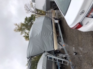

Mast up or down? Probably not what you are looking for, but I copied this 260 cover for my 240- mast down with PVC frame attached to stanchions to raise the tarp high enough to avoid water pooling on the cover. Works pretty well-

Thanks! Saw that - a possibility. Definitely mast down.

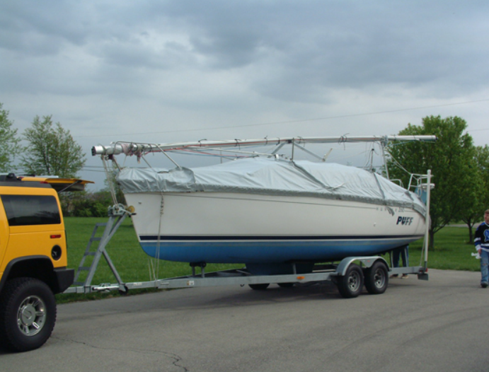

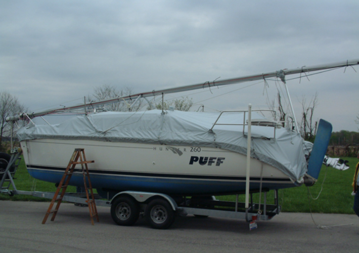

A bit concerned with our winter winds I could lose the whole thing - not around the boat during the off season. This is the sailortailor cover.
10,060
As a dealer, I bought and referred others to them as well. First and most important the cover is not draped over the mast. Secondly quality is good and price reasonable priced

Wow.... that is cool. Will it fit the 26?
Doubt it due to the sugar scoop stern. But they made this so a H26 would not be much different.
Looks pretty good but I'm always interested in alternatives. Watcha got?
10,060
the only major difference to be concerned about is first the 26 except for a few were tiller and the other is the upgradded transom on the 260. Otherwise the same boat. calll and ask them as they have the specs
