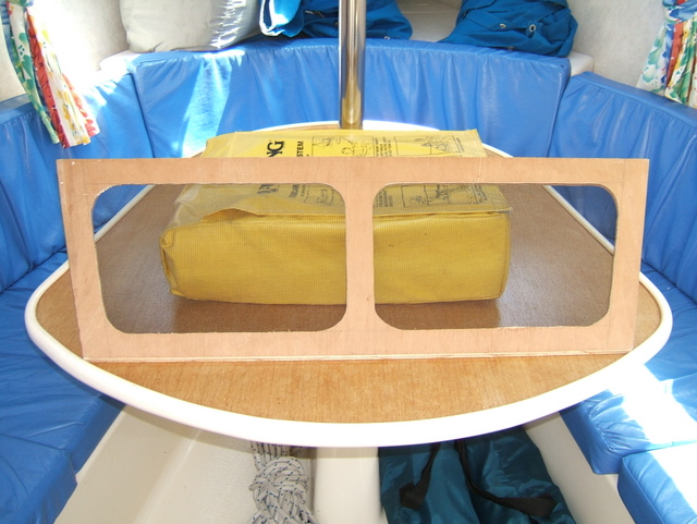

I cannot speak to the squishy floor issue, because I've never had that problem. But, I have never had rain come in under the sliding hatch either. I have had a little bit of water come in that way if I am not careful with the power washer though. All of my rainwater problems came through the hatch boards. The water just blows in at the joints! I put metal carpet strips on the edges with double-sided foam tape and 3 or 4 screws. Since then I have never had rain in, and we've had some really driving rains since I did the fix. The boat is completly dry. Oh, heres a picture of the hatch board screen I saw while looking for pictures. It's just two 1/4 inch plywood pieces, screen, and lot's of silicone caulk to glue it all together.
