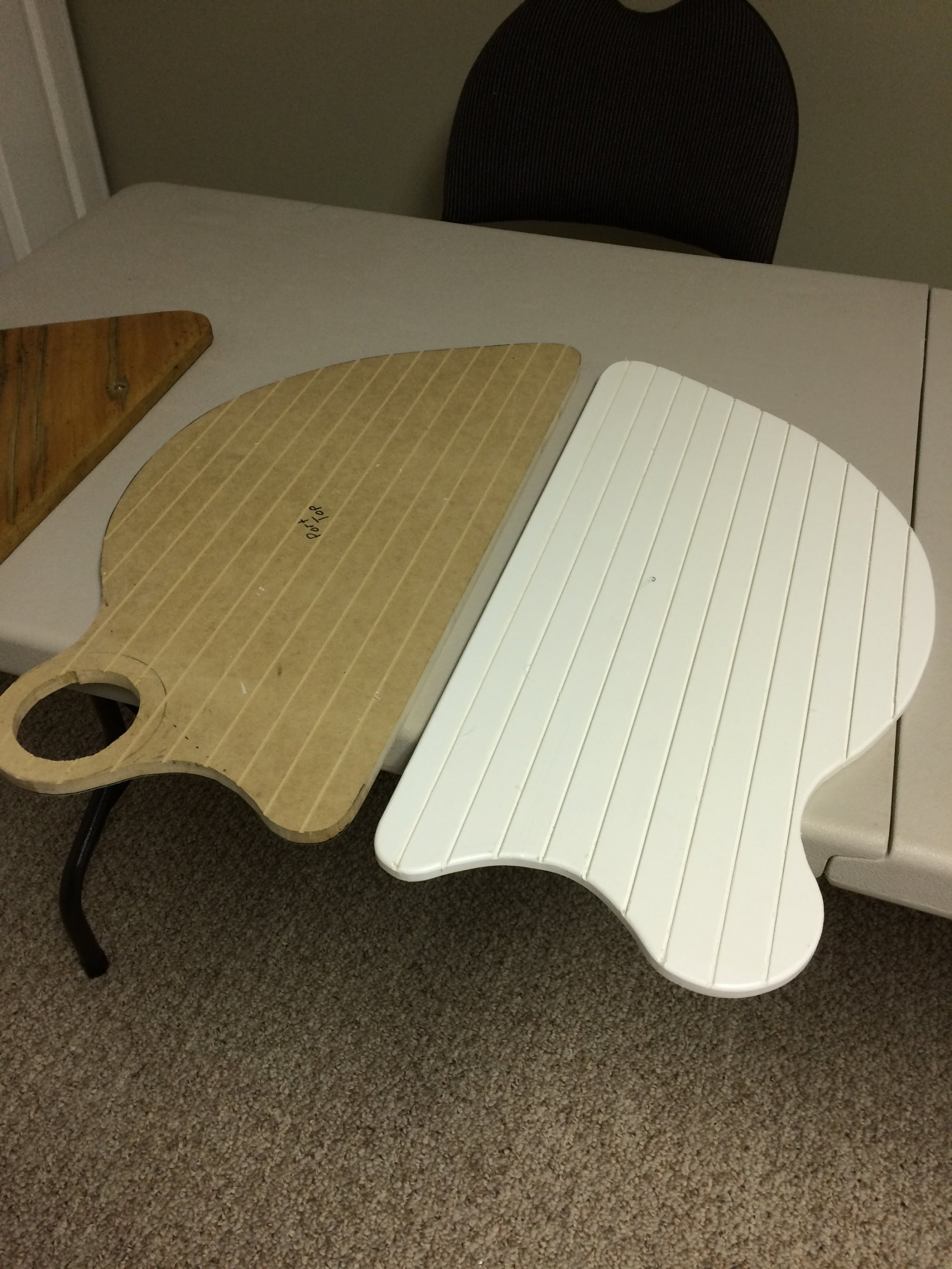

I'm making some progress on my seats. Here is a pic of the starboard seat minus the cup-holder hole. I hope to start fabricating the port one this weekend. On the left you see a MDF prototype which I used for sizing.

I'm not planning to add the teak strips as I permanently leave the cushions in place.

Looking good! Really nice job Fred! Be sure to post pic's once installed on the boat.

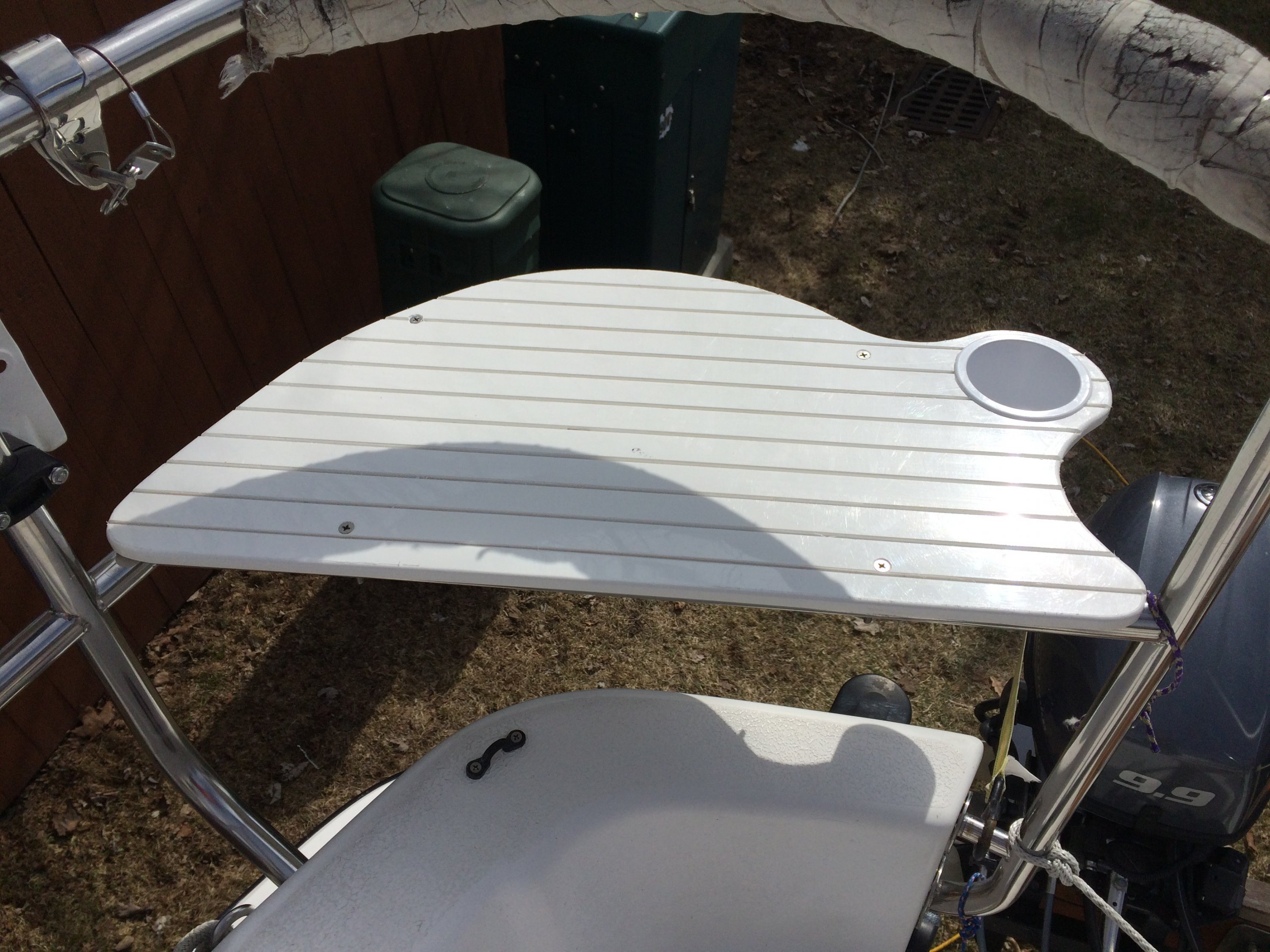

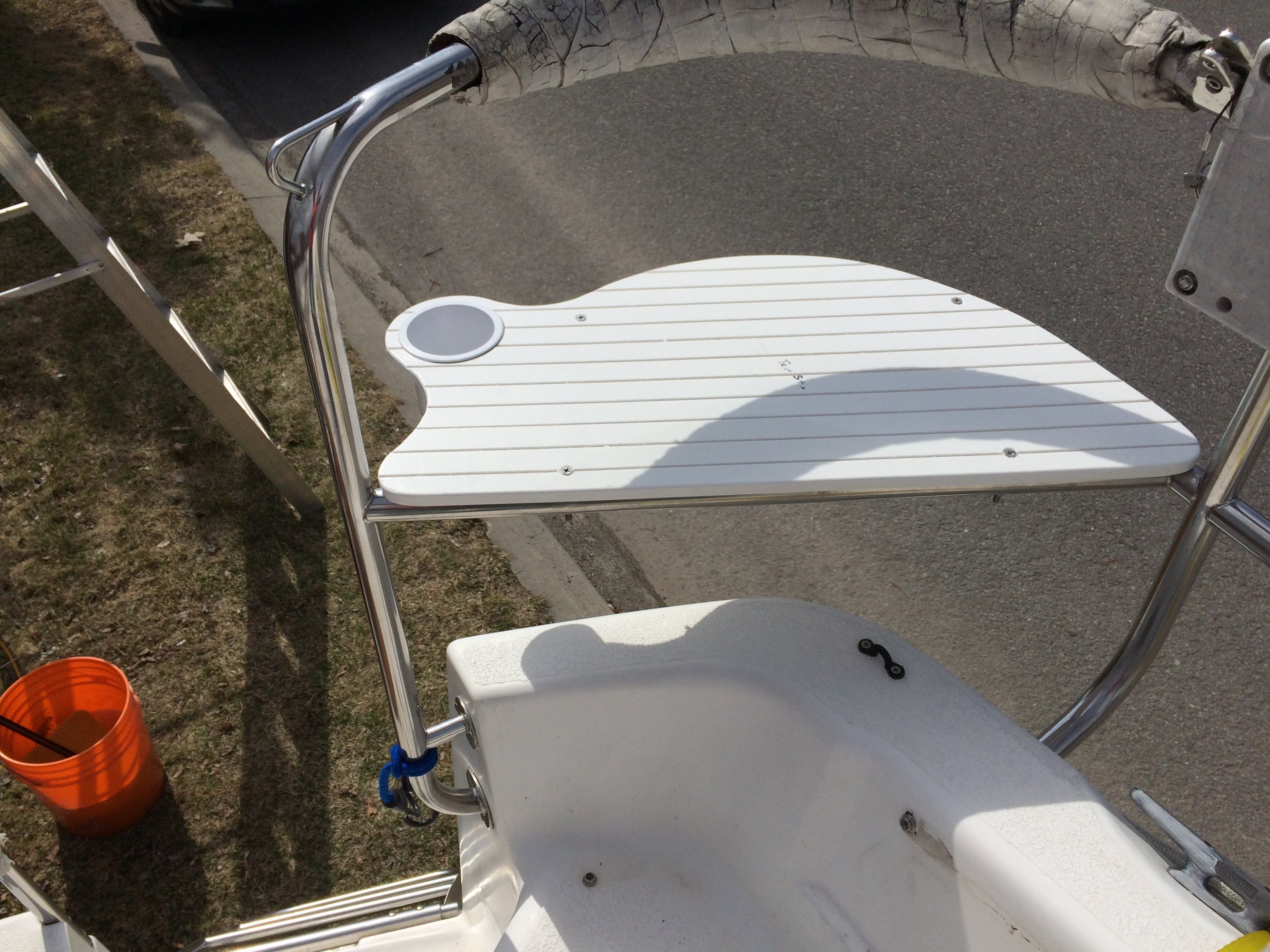

Wow Fred... you been busy. Just saw your other post with the bow roller.
Those look fantastic. My wood on my stern rails seats are starting to look tired. Been thinking of using Trex as a replacement.
