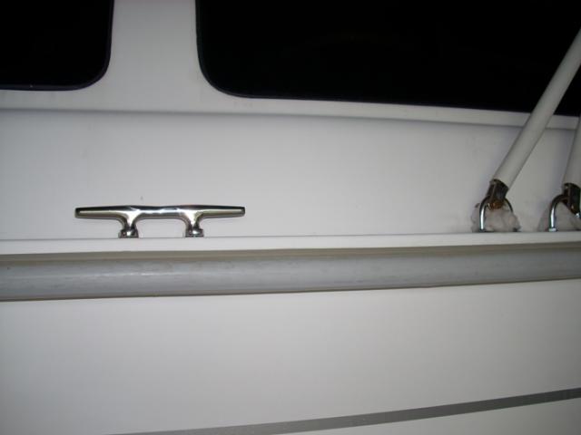

Also I saw a tip once to insert pieces of foam in the U-bolts under the toggle jaws to keep them in position during the mast lifting.
BrianW
Jan 7, 2005
843
Hunter 26 Guntersville Lake, (AL)
Sea Casper, I'm sorry, but I can't find my records and part number for for the T-bolt. After looking at the Rigging Only online catalog, I now believe I bought the jaw and T-bolt together (still a reasonable price). It has 5/16-24 threads. In their catalog, it is listed as "Threaded Toggle Jaws, Part number 316TJRH or 316TJLH (left or right handed). I honestly cant remember if its LH or RH threads. Talk to Rigging Only, they can help you choose between the two, especially if you get the stamped info from your turnbuckle. They may even sell you the T-Bolt only. BrianW
P.S. Thanks for the tip on the foam. All it takes is ONE bent T-bolt to find a better way. Since my "ONE TIME" , I now use the foam insert method.

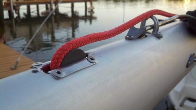

Here's the original pic of my hi-tec foam Tb fix. I also placed a guide at the side stay T on the mast made of 1/2" pvc 2 hole electrical pipe strap. A single pop rivet on the rearward end of the strap keeps it aligned and still allows easy removal if necessary. The fore stay got a strap too but with 2 rivets. No need to ever worry about a twisted fitting/turnbuckle.....but still watch everything.
Nearly every dismasting of these boats is related to a twisted/poorly seated TB or T fitting that eventually breaks.
Good luck, Mike
