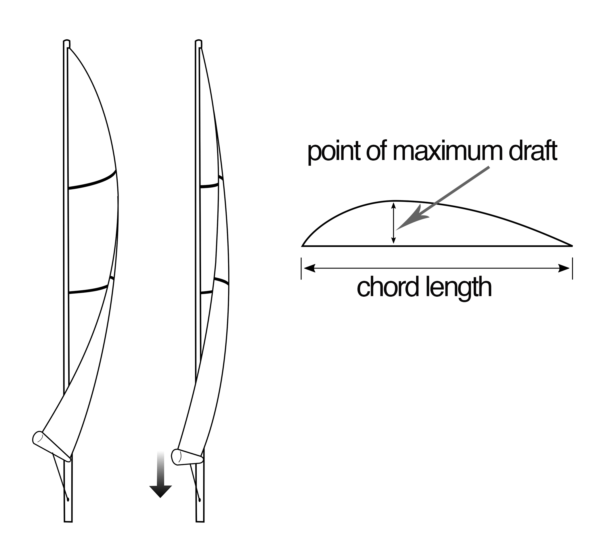

Rgranger's experience is consistent with the dynamics of sail balance.
You can check your sail by looking at it when set and tensioned with outhaul, Cunningham, halyard and vang. If the sail is new or in good shape, the fullest curve in the horizontal cross section, when sighting up, will be forward of the centerline of the sail.
In heavy air, the draft moves back on the sail slightly. In a blown out sail, it moves back alot.
This puts more lift aft and causes more heel than drive. Greater heel, combined with a naturally aft positioned draft causes excessive weather helm. Compensation by the rudder means even more heel and less ability to point well.
Changing your rake can affect the well balanced boat, but it is unlikely to make a significant difference in a boat that is very poorly balanced.
You probably need new sails, no matter what else is wrong, but take some pictures, from the same angle as the above example and let's see.

What is counter intuitive about rake is that typically you need to move the rake FORWARD however that looks wrong and most people's first attempt at adjusting the rake is to move it backwards. @Will Gilmore 's diagrams show you why forward is usually the answer. If your sail is blown then the draft needs to be shifted forward (or you need a new sail).
13,052

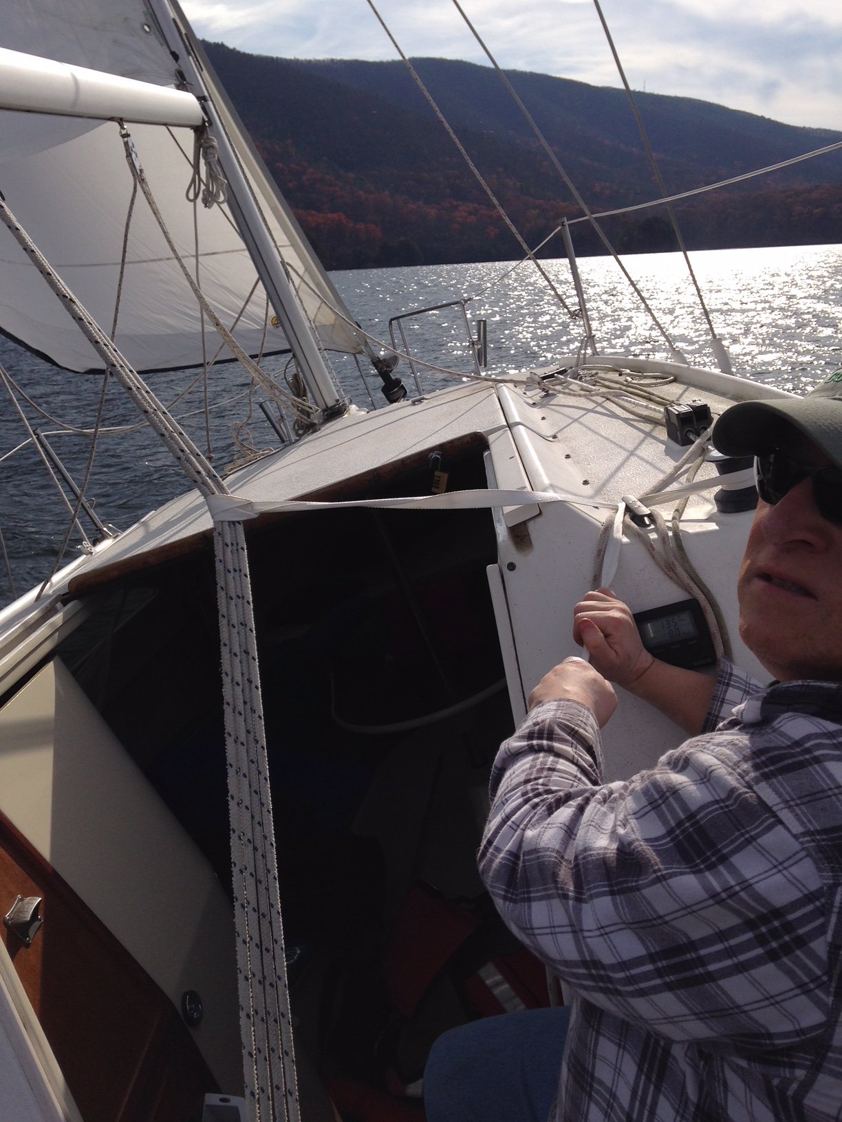

Another thing that @Will Gilmore 's picture shows is how adding twist to the sail can help aleviate some of the "bulge" up high and this will steady the boat. In many cases you have enough power in the lower part of the sail to drive the boat at hull speed. Unfortunatly you need a traveler to do a good job of adding twist and the H26 did not come with a traveler. I installed a traveler on my H26. I can post pics of the install if you want to go down that rabit hole but if you just want to test the idea and see ... here is a trick that works very well...
The idea is to get the boom to mid-ship while allowing the top of the sail to twist off the wind. Let your mainsheet out a little and then tie a sail-tie to the sheet and pull the boom to mid-ship. If you feel an immediate bump in speed and stability then you have successfully added twist to your bag of sail trim tricks. If this works for you and you decide you want to add a traveler... I have an extra piece of track that I can send to you for postage. I got mine off of eBay and they came as a pair so I have an extra piece of track that just happens to fit perfectly over the companionway bridge deck
Also, on my H26 I notice that the boat does not like it AT ALL if I forget to let out the vang when working to windward. I don't fully understand why but it is noticable.
