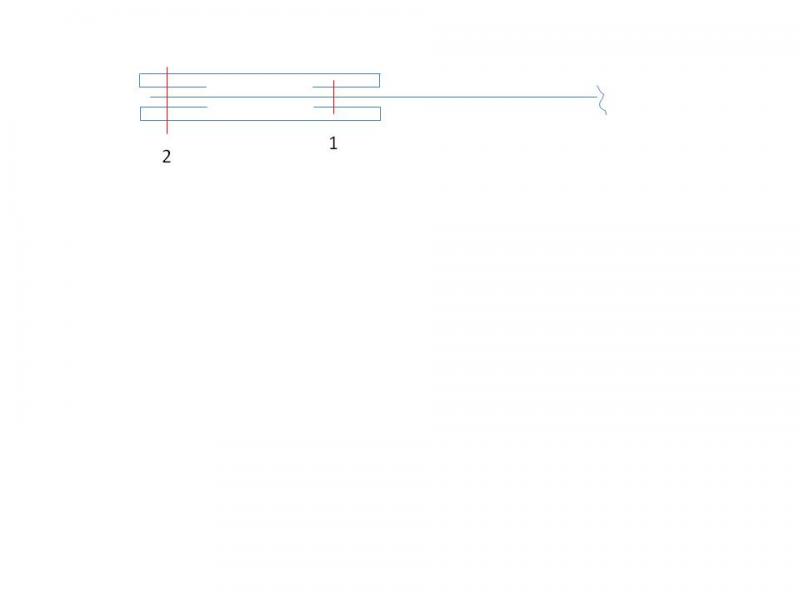

Also, the netting is very easy to sew if you use a piece of fabric on both sides to sandwitch it between
___2___________
|___2 _1__|
___2_______1____________~
____2 _1__
|___2_______1__|
Lay the screen and both "C shaped" covers so that the foutside of each cover is facing the bug screen and sew #1 (blind stitch). the fold over the covers and sew #2.
works great, less filling
Jun 6, 2006
6,990
Crap! my attempt at diagraming with ASCI needs some work
try this.
